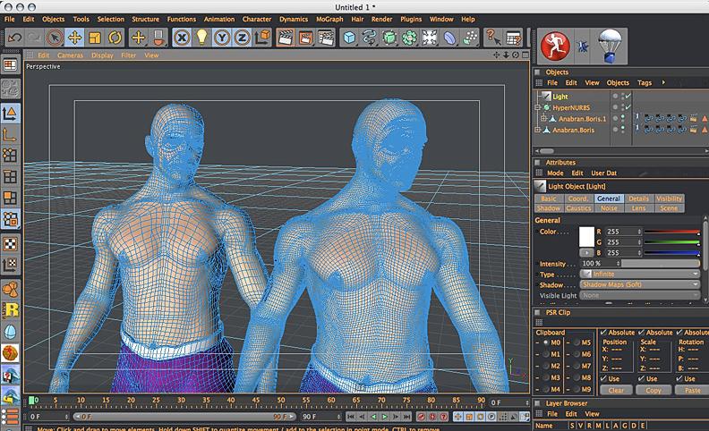

  • wolf359wolf359 Posts: 3,936
    edited November 2017
    So there's no way to animate in Maya and import the animation to Daz Studio?
    Yes Maya can Export  motion to a  BVH file and DS 4.10.x now support proper BVHimport
    for G3/G8.
    "Thank you, you just made my point.  You have to use a "vestigal"
    character to do that because they are already "HD".
     Try doing that with a
     Genesis figure.  You can't.  Base sub-d can't produce HD details."
    I think you might be confusing muscle morphs with "HD morphs"
    Daz Mike 2 is not an "HD mesh"
    here he is without his muscle morphs dialed in but merely subdivided
    to smooth out his horrible faceting that would show in a close up render
    "I have eyes and I've seen V4.2 figures that look better most G3 or G8.
      Once more, they are more detailed.  There is no need for HD morphs,
     they are already HD.When I import them into Maya, I have no need to
     subdivide"
    Not going to debate personal choices of figure generations mate,
     I certainly have my preferences.
    However in the context of a discussion about JCM& FBX imports from Daz
    studio to Maya,
    Certainly V4 does not solve anyone's problems as none of the many magnets
    and other kludges to fix her joints in DS/poser will transfer via FBX either.
    792 x 482 - 387K
    Post edited by wolf359 on
