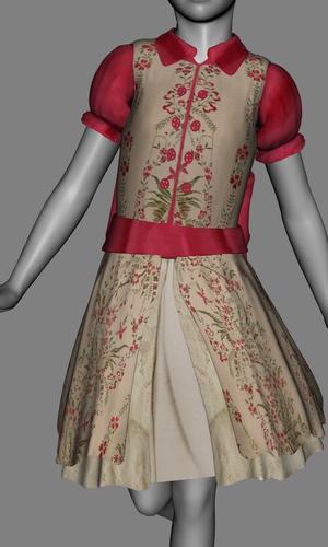

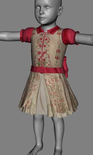

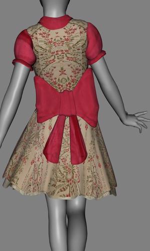

    Since the release of DIM I have been reinstalling all my content. I've now gotten to the stage where I'm starting to convert previous generations clothing to Genesis. I've also bought SickleYields great new product to assist with autofitting. So here I go...

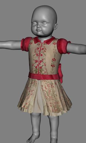

    I started with the 50's dress from Bobbie for K4
    Process used:
    Autofit using SY's Dress
    Sent to Hexagon as I was still getting some mesh distortion(I haven't read up on SY's product so that would probably be user error. Also I'm very fussy about mesh distortion.)
    Smoothed the polys using the smoothing tool in the UV and Paint bar in Hexagon.
    Sent it back as a morph to the original dress.
    I also added a smoothing modifier prior to saving.
    Settings: Set smoothing to Generic
    Set weight to .75
    Collision iterations were left at 3
    Dress is shown on Julie shape
    Basic child
    BabyAT
    Aven
    600 x 1000 - 135K
    600 x 1000 - 182K
    600 x 1000 - 192K
    600 x 1000 - 285K
    600 x 1000 - 251K

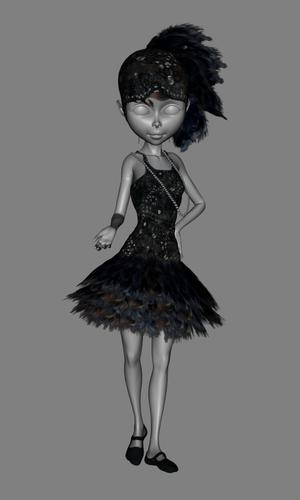

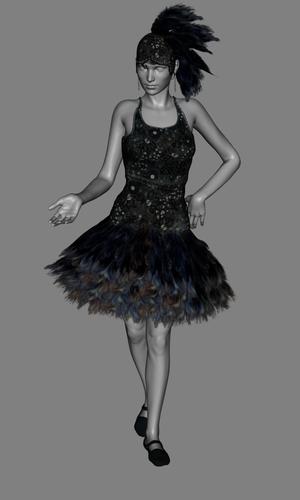

  • PendraiaPendraia Posts: 3,603

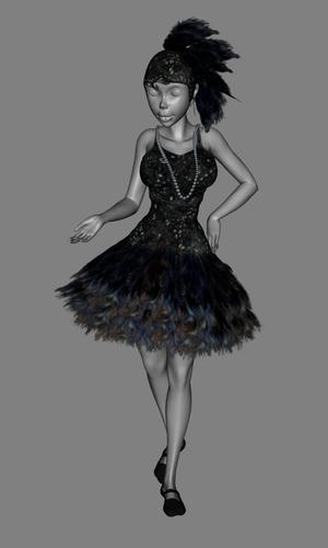

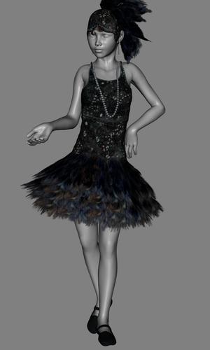

    Next cab off the rank All That Jazz for V4
    Most of it autofitted with no issues apart from the jewellery but I've found if I just use the jewellery as a prop figure that it's easy enough to adjust it to work and you get less distortions on the mesh.
    Shoes were the only item I added smoothing too.
    I used the SY V4 Boot to autofit
    Settings are:
    Smoothing type: Generic
    Smoothing Iterations: 21
    Collision Iterations: 8
    Changing the weight to .75 also shows a slight improvement but these images were at .50
    Aven
    V5
    Mavka
    Nata
    Satsuki
    600 x 1000 - 132K
    600 x 1000 - 120K
    600 x 1000 - 113K
    600 x 1000 - 128K
    600 x 1000 - 139K

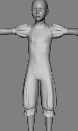

    Now for Alice Wonderland for A3

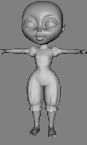

    Alice Bloomers
    Smoothing Type: Generic
    Smoothing Iterations: 28
    Weight: .6
    Collision Iterations: 14
    Collision Smoothing Intervals: 2
    SYBodysuit
    Julie
    Aven
    A5
    ChibiGirl
    V5
    600 x 1000 - 97K
    600 x 1000 - 95K
    600 x 1000 - 101K
    600 x 1000 - 96K
    600 x 1000 - 93K
    Post edited by Pendraia on

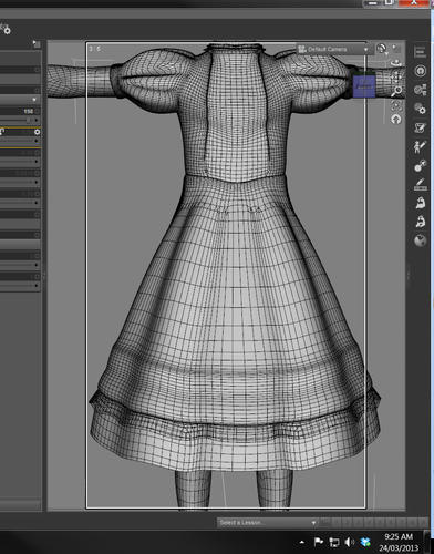

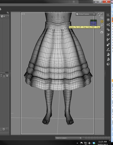

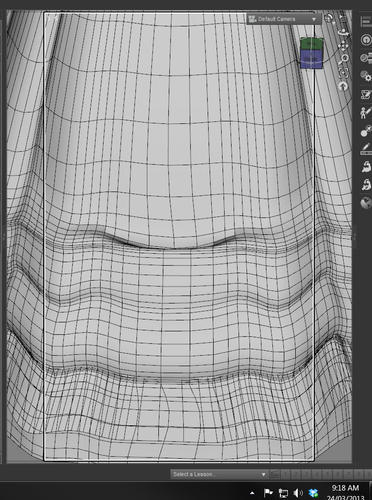

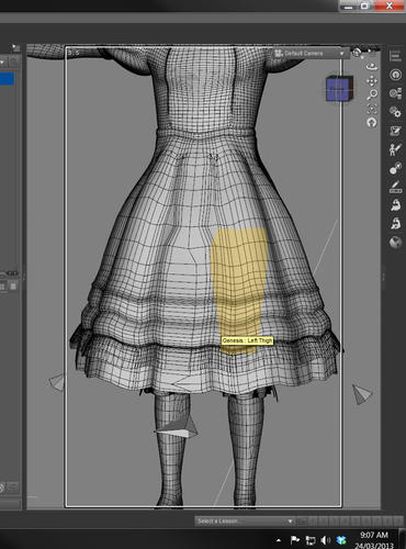

    Alice Wonderland Skirt was a little more work...
    I tried first with just a smoothing modifier which worked well for everything except an issue at the back of the mesh.
    Alice Skirt
    Using a smoothing Modifier and mesh fix
    Smoothing Iterations: 20
    Please note: you can get reasonable results starting about 10 but the more you increase this the less mesh distortion there will be. However I find that the improvements after 20 probably aren't worth the hit to your computer speed in this instance.
    I accidently keyed in 198 and the mesh became extremely smooth and square. You also lose some of the drape the higher you go.
    SYDress
    Back mesh distortion fixed in Hexagon and sent back as a morph.
    Initial mesh distortion
    Smoothing added and changed the smoothing type to Generic
    Back issue
    Back fixed by sending to Hexagon and smoothing.
    852 x 1074 - 492K
    747 x 1005 - 512K
    798 x 1059 - 410K
    795 x 1074 - 418K

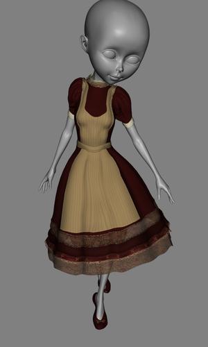

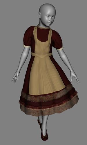

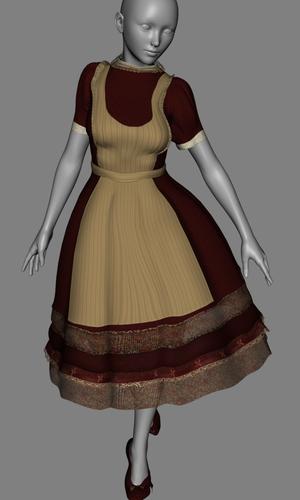

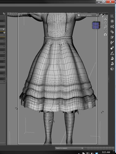

    Alice Wonderland Apron caused the most issues to convert. This is because the parts of the apron aren't joined and when smoothing is applied will separate.
    Alice Apron
    Autofit: SRMDressBase
    Smoothing Iterations: 1
    Collision Item: Alice Bloomers
    Problems due to parts of apron separating. Tried adding extra weight and Collision intervals but it didn't help.
    So I took it into Hexagon applied smoothing tool to mesh distortions on the skirt and the bodice. Needed to be careful not to do it to close to waistband or frill as they will move apart. Sent it back to DS. Added a smoothing modifier so I could collide it against the bloomers. I kept the Smoothing Iterations as low as possible as otherwise it will separate.
    Showing initial separation issues
    Satsuki
    Julie
    A5
    Mavka
    600 x 1000 - 189K
    600 x 1000 - 139K
    600 x 1000 - 160K
    600 x 1000 - 149K
    600 x 1000 - 169K

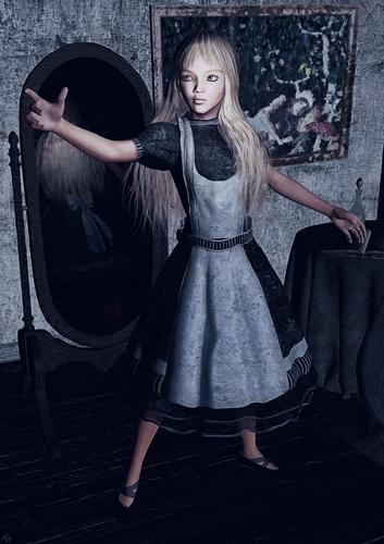

    edited March 2013

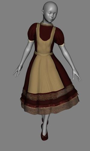

    Still plodding away and converting my Gen 3 and 4 clothing to genesis.
    Converted Bobbies Alice in wonderland for V4 today and took the time to do a render. It converted quite well using autofit and Sickles Dress template. Very minor distortion on the dress which quickly disappeared by changing the smoothing type to Generic, upping the weight to .75 and using a small amount of smoothing (5 for the dress and 6 for the shoes and socks)
    Hair is Aryelle autofitted using V4 with the long hair template no smoothing added. Some morphs used including messy and wind.
    Character .4 of Mavka and .5 of Julie with Lorella skin
    EE Road to Hell and AoA's Fog Camera
    I call it 'I want it now!'
    600 x 1000 - 223K
