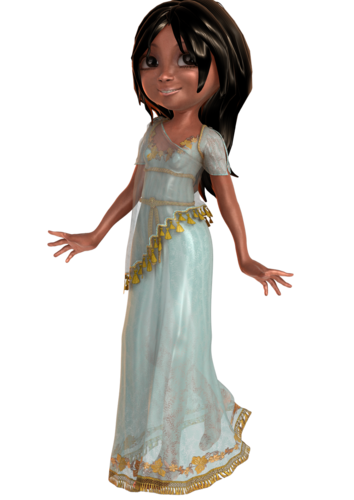

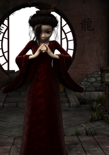

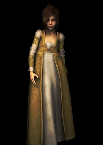

So I'm finally at the point where I'm trying to convert all my older stuff to Genesis and I thought I might share my journey with others in the hope that I can show what autofit is now capable of and also that I might pick up a few hints from others. Feel free to post your conversions using autofit...
Starting with Kiyoko in DNA's Morphing Gown...Fisty's Crushed velvet shader and IG's simple softbox light
1000 x 1414 - 2M
«1

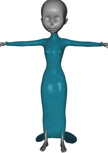

    Some less interesting renders more a proof of concept
    basic genesis, chibigirl and mavka...this one still needs some work and I've actually done a skirt fix but no renders yet.
    1000 x 1414 - 1M
    1000 x 1414 - 946K
    1000 x 1414 - 1M

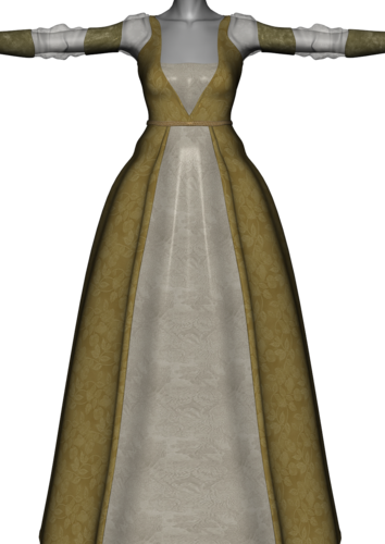

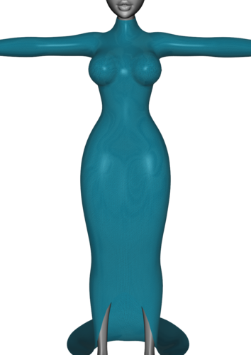

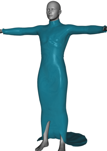

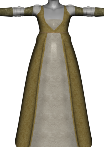

    The dress for V3
    Basic Genesis first with no adjustments...second changing smoothing to generic and adjusting smoothing iterations and both weight options.
    Note: that adjusting settings seems to have cleared up the stretching in the front of the dress.
    1000 x 1414 - 631K
    1000 x 1414 - 656K

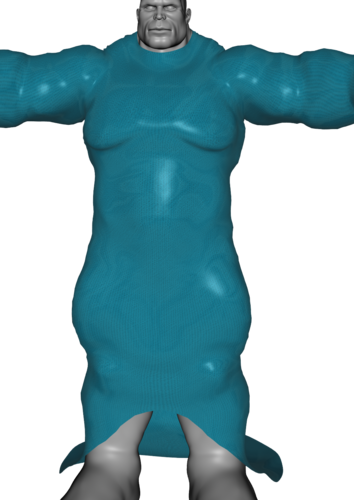

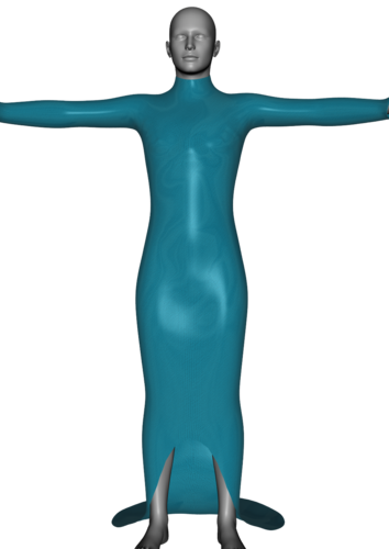

    A couple more of the dress to show how well it takes the different shapes...
    Mr Hyde, Mavka, Nata,
    1000 x 1414 - 1M
    1000 x 1414 - 528K
    1000 x 1414 - 754K

    Pendraia said:
    The dress for V3
    That's awesome! Would you be kind enough to elaborate on the adjusting smoothing iterations and weight options... I have many clothing that I've transferred to genesis, and they all get that strange mesh scrunching up and stretching (like in the first pic of the dress on default genesis) I'd love to learn it better... Thanks :)
    I haven't bought the Gen 3 morphs yet. How does it work? Does it just install into genesis and you just load up the Gen 3 clothing (and select M3 or V3 during the auto fit menu?) Also, have you been having problems with shoes using Gen 3 shoes because I think everyone gets the crumpled shoes when using M4 shoes.
    When you buy the gen3 iconic figures you also get their clones for the autofit tool.
    It then works the same as any autofit...either when the garment loads or when you use the fit to option in the parameter tab, you get to choose which figure the autofit will use and which template. I often use the loose bodysuit option even with dresses as it doesn't cling to the figure shape as much. Basically I play with the different settings to see which will give the best results.
    Once autofitted if it needs it I add a smoothing modifier in the scene tab. Then I play with the settings for the smoothing in the parameters tab.
    Shoes seem to cause the most problems...some because they aren't welded together and some just don't convert well.
    Some shoes do fare well though, for example the shoes from the m4 puck outfit transferred beautifully but the boots from wildenlander didn't because they came apart at the seams literally. A lot depends on how the meshes are designed.
    The DNA morphing gown worked beautifully but the ever after dress needed an adjustment morph mainly due to the layering and the lack of welding.
    I've been having a lot of fun with it. I converted the puck outfit and used it with a Sadie and Mavka mix...I posted pics in the threads on Sadie if you're interested. I have more images to post but it will have to wait until I'm on my computer.

    Spyro said:
    Pendraia said:
    The dress for V3
    That's awesome! Would you be kind enough to elaborate on the adjusting smoothing iterations and weight options... I have many clothing that I've transferred to genesis, and they all get that strange mesh scrunching up and stretching (like in the first pic of the dress on default genesis) I'd love to learn it better... Thanks :)First...I'm not an expert. I'd be the first to admit I'm not sure what some do and why/how.
    First setting I normally play with is the smoothing modifier option...I've found that generic shape seems to be the one I choose the most.
    Smoothing iterations is the next one. I try to keep that under the halfway mark mainly as the higher it is the more likely it will freeze my system.
    The first of the weight options I tend to think of it as being the weight of the fabric but I highly doubt that's what it actually is...like I said not an expert. Lol
    I tend to move that towards the right hand side but I use it sparingly.
    The second weight option tends to be just the left of the first.
    Lock distance seems to effect how far the mesh can move...I can't explain exactly but you'll see what I mean when you play with it.
    I tend to just move them around until I get a result that I like. I've recently decided that it's probably better to create any adjustment morphs on an unsmoothed mesh, mainly because you'll lose less of the original draping and then use smoothing to fix any minor problems.
    I've been saving them as wearable presets...unfortunately this is not a format I can share as it embeds the geometry.
    Hope this helps...

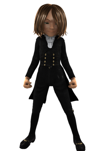

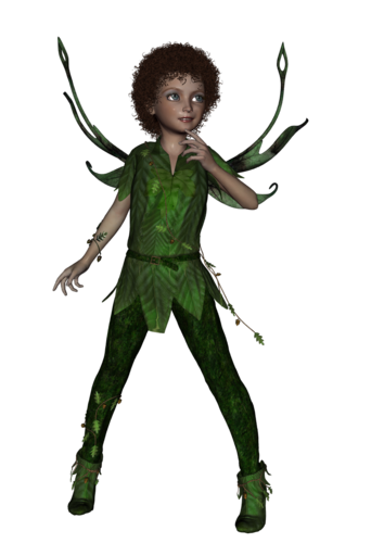

    Here's the puck images and the 19th century suit...
    also the s3 grecoroman chiton and himation...that required a morph due to all the layering and I'm still not happy with some of what happens with some shapes. I'm still trying to work out how to create the morphs for the different shapes...I've had problems when sending them back to DS. Still have to figure that out...; )

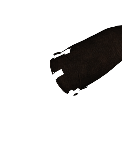

    What happens if you miss polygons when converting to Genesis? Has it ever happened to you?
    I have looked into the Transfer utility, and it is only on one arm that the polygons are missing, the other side is perfect. Converting to Weight-map seemed to work, it was only when I applied the Transfer utility that the results below occured:
    It seems the M4 Monk Robes needs readjustment in Predatron's workshop...
    Post edited by Norse Graphics on

    Phase1: Load Genesis and the Monk Robes for M4. Make sure Genesis is not selected.
    Phase2: Make sure Robes are selected, and convert to weight-mapping (triaxis) in the Edit-menu on the Scene-tab. Select Triaxis and accept. Robes seems ok after conversion.
    Phase3: Still selected, go to Assets-menu on the Scene-tab, and select "Transfer Utility".
    Settings used (after watching Youtube tutorial):
    Source - Scene item: Genesis; Item Shape:Clone (select Michael4 and Accept)
    Target - Scene Item: Monk Robes for M4; Item Shape: default.
    Projection template: Bodysuit - loose. (same results with Dress - knee-length)
    Added in the Projection options; Reverse Source Shape from Target.
    Then click Accept to fix the new rigging.
    Then it works and the polygons gets lost on the right arm. The left arm works perfectly, so it's a one-side issue here. That's why I thought it was 'wrong' on parts of the mesh. I even started to look for something to flip the polygons, but as they aren't see-through otherwise, then that's a moot point.
    No, I didn't add any modifiers at all. The renders are 'straight-out-of-the-box'
    800 x 1000 - 335K
    800 x 1000 - 263K
    800 x 1000 - 185K

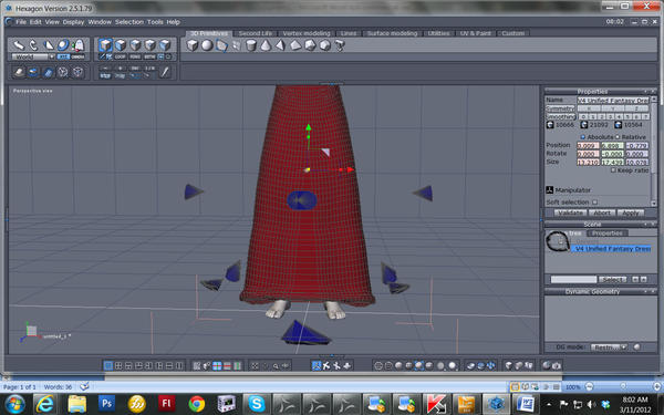

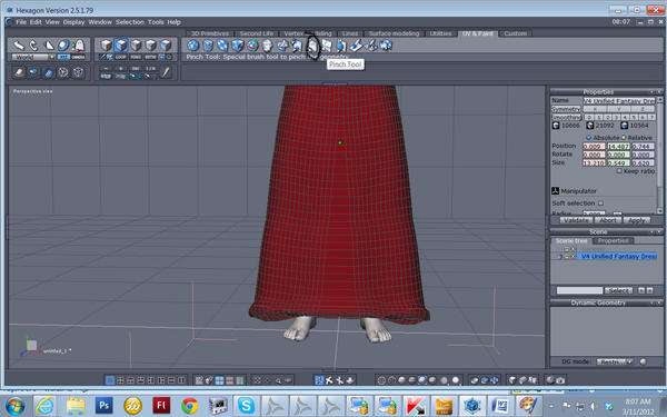

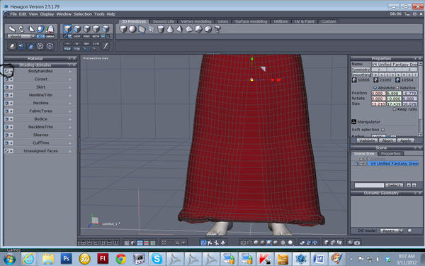

    I was asked in this thread http://www.daz3d.com/forums/discussion/10830/ if I could explain the process I use in Hexagon to fix some of the distortions from autofit.
    So for what it's worth here it is...it works well for me but your mileage may vary.
    Load MFD(or other outfit onto Genesis in DS.
    With MFD settings are V4 Template is Dress knee length
    Send to Hexagon via the bridge.
    Click on the padlock to lock Genesis in the scene tree tab.
    Click on symmetry in the property tab select x
    Click on the edge selection and select the front bottom edge. Put soft selection on about .600 in the properties tab. Using the green manipulator move the hem down to where it should be.
    Click on UV and paint tab
    Click on the soften tool and drag it gently down from where the mesh shows distortion a couple of times.
    It should even out the mesh stop when you're happy with how it looks.
    Validate and apply...save regularly in case you muck something up. I use incremental save.
    Reselect the soften tool and gently run it over and distortions. It should gradually straighten the mesh.
    Validate and apply when happy and make sure you save.
    Use the edge selection choose one of the bottom edges of the dress and hit loop. This should select the bottom edge. Remove soft selection.
    Using Green manipulator gently move it down to correct spot.
    Do the same with the next two edge loops to spread them out a little more evenly.
    Selection the dress...I also like to make sure the selection if for the object not the edge(just to be on the safe side) and click on file sent to DS.
    This should activate a dialogue box for loading a morph.
    I would call it skirt fix and click accept.
    Make sure MFD is selected go to parameters and apply the morph.
    1440 x 900 - 299K

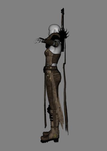

    Just a quick post of Julie in the everafter dress for a3. Some postwork on waistband which I still need to fix in hexagon.
    600 x 843 - 157K

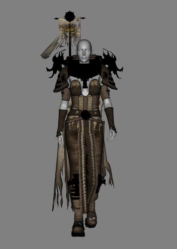

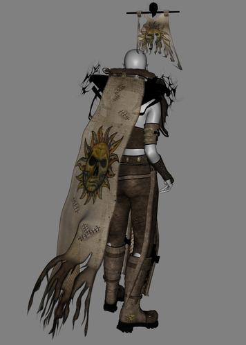

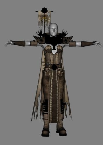

    Still slowly plugging away at converting the clothing...
    Here's something out of V3's wardrobe...worn by her Gen clone.
    Two issues one with the flag which wasn't there until I posed the figure and the other a slight kink in the cape that can be fixed with a morph in Hex.
    600 x 843 - 73K
    600 x 843 - 115K
    600 x 843 - 117K
    Was able to reduce the distortion on the flag using smoothing and also created a morph fix for the cape.
    Still needs more work...I've played with adding some rigging to the front skirt but it needs more work.
