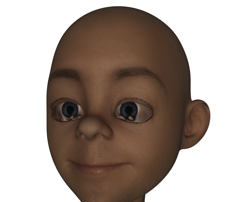

    MusicPlayer could you double check the eyes on the ToonGeneration morph? Cause either there is an issue with the eyes or I messed up somewhere which is highly probable ....but this is what I got happening with the toon gen on G8M ,the eyeballs got wonky and dented.....
    820 x 697 - 374K
    Post edited by carrie58 on

  • MusicplayerMusicplayer Posts: 515
    edited August 2017
    Yes, you are correct, there is an issue with the toon morph not correctly scaling as the head grows bigger and therefore breaks the eye mesh. I never noticed this until you mentioned it. I will look into why this is, or hopefully somebody else will have an answer. I also tried the g3f toon morph with the Genesis 3 female to Genesis 8 Female transfer, and this particular morph also breaks the eye mesh. So at least we now know this problem is not unique to this male transfer.
    smiley
    Edited to add, that after making this post I Googled the problem, and it is a known issue commented in this thread  https://www.daz3d.com/forums/discussion/comment/2698586/
    Post edited by Musicplayer on
  • carrie58carrie58 Posts: 4,179
    Thank you !! Now here is a thought is the a way to exclude the eyeballs from the morph? and then manually scale them up?

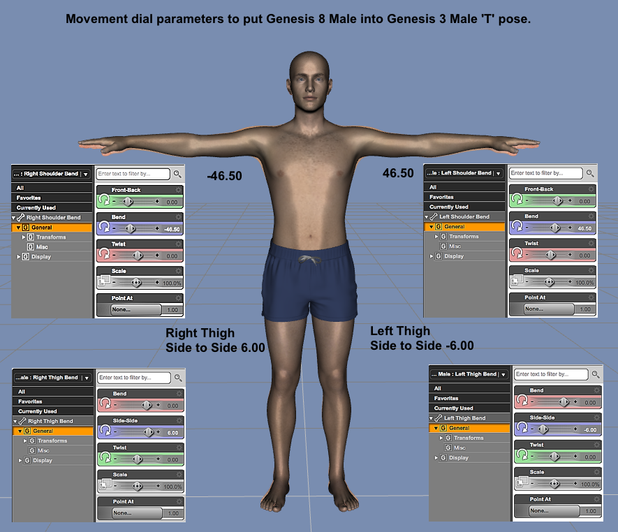

    edited August 2017
    HI Serene Night,
    Many thanks for your kind comment and glad you have found the tutorial useful.
    As regards to your question, the given measurements should put your Genesis 8 Male into a near perfect  'T' pose, and I include a diagram to show that Genesis 8 male (with the tutorial settings) standing in front of Genesis 3 male is almost a near identical match.
    Is this what your question related to, and if so, maybe your dialed in settings were somehow different. I hope this helps, but if your question relates to something else, please can you include a screen shot, and I will assist further.
    Kindest regards.
    smiley
    885 x 762 - 322K
  • In my set-up, I was off by 1.5 degrees for the arms for getting Genesis 8 Male into a T pose. I didn't notice any problems with the morphs I made.
