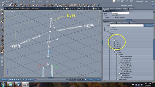

    Roygee, I don't know why the video stopped at 6 minutes.... maybe try again. I am in the process of uploading more videos on creating the walk cycle.
    As far as placing the bones I find it pretty nice in Carrara.. Try this.
    1.Go to Front view or view with Character facing you .
    2.Select the bone Tool and start drawing the rig.
    3.The bones should be in front of the character and you should clearly see both the bones and mesh.
    4.Try using the Shift key and dragging while the bone is where you want it to scale the bone joint up or down.
    5. Once the skeleton is done in the Front view go to the Top View and move skeleton in to place.
    6 To help in selecting the bones either use the Right Click when you are hovering over the bones to bring up the selection list or
    have another View window open and have it to display in box or wireshading.
    I don't know if this will solve your issues but hopefully it helps.
    Also, instead of weightpainting you could just try adding and deleting bones in the Bones tab of the Vertex rooms Animation tab.

    Roygee
    I have some answers for you .
    For the knee bending issue . I think all you have to do is put an IK Terminator on the Hip bone above the foot you are working on.
    So...
    1.Select the left hip bone if you are working on the left foot.
    2. go to Properties Tray/Modifiers tab and add IK Terminator .
    You should be able to move the foot and bend the knee..
    I don't know what you mean by "select the right axis" I just rotate using the yellow ring or co-planar with the camera.
    For when moving a bone you select another bone try this(I had this issue too.)
    1. Usually when I am selecting the root bone I would end up moving the bone above it .
    2. So, select the bone above the root bone
    3. Go to Properties Tray/Effects tab and uncheck "Display wireframe when attached"
    or a simpler way.
    1. Just select the bone you accidentally select all the time.
    2. In the General Tab uncheck the "Visible" option
    You can still see the bone but you cant select it so if you want to rotate that bone in the future you have to check "visible" again.

    I've come across a really weird effect. Because I had a problem getting the eyes weight-painted, I separated them from the main model and parented to the head. Each eye has a THO with a "point at" modifier and these THO's are parented to a controlling THO - this setup works really well for synching eye movement - until I parented the control THO to the head - now it controls the whole upper body from the abdomen!
    It acts as if there is IK connected from the control THO through the head to the abdomen - I must emphasize that I have never attached any IK to this rig.
    Can anyone explain this behavior and possibly give a method of getting the eyes and THO's to follow the head when the neck is rotated and not the other way round?
  • mmoirmmoir Posts: 836
    Roygee,
    I don't know but you could try and Bone the eyes , see the image which shows you the skeleton etc.
    1280 x 720 - 465K

    Hi Mike - yes, the eye rig is OK and understandable - I was just trying out something that I read about years ago here to synch the eye movements with one controller and came across this very weird behavior.
    As a matter of interest, how were you able to get the eyes weighted without affecting other parts of the head? Only thing I can think of is that you would need to hide parts of the head mesh to get to the eyes?

    Could you have just the "Point At" modifier on each eye and have it point to just a regular cube . You can see if this makes any difference.
