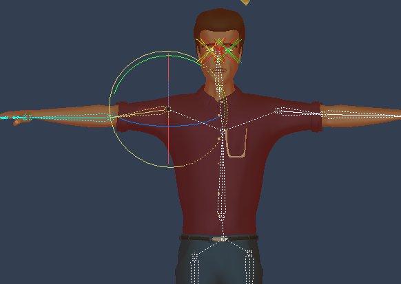

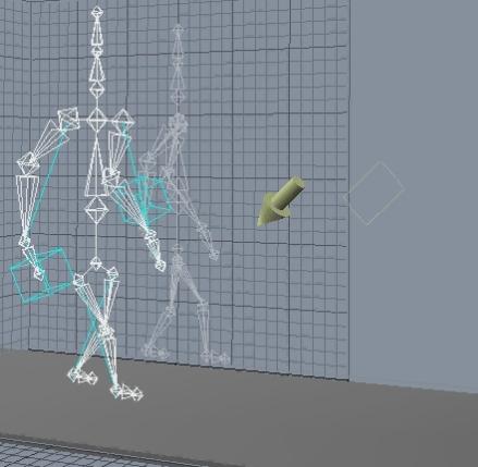

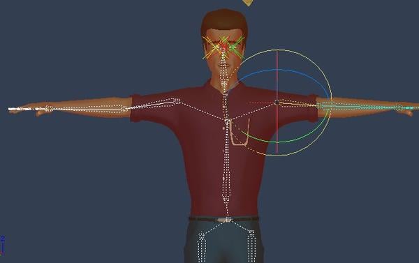

Hey guys,
Well here is a thread to post your progress with animating the assets of our Carrara movie project. Here is my first try with just the skeleton .. I found the biggest thing to start off with is the layout of the windows and how to make selecting bones and the sequencer items the easiest. After doing this and getting used to being precise when selecting bones and then moving them I could concentrate on animating the rig.
http://www.youtube.com/watch?v=TNJ8Vn11P2w Skeleton Animation
http://www.youtube.com/watch?v=5TnbYp1FfPM Man Animation
I am making progress but for whatever reason the right elbow/wrist in the Man animation goes wonky .. The keyframes seem okay but when Carrara tweens it strange things happen.
620 x 446 - 40K
439 x 429 - 104K

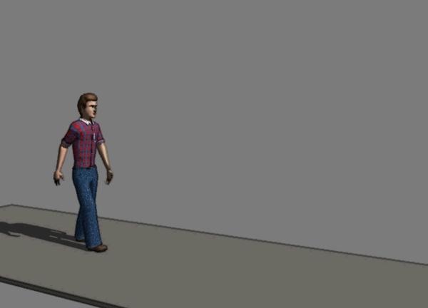

    I really like your walk cycle, Mike! He certainly has a bit of character to him...
    reminds me of a friend I know.
    Aside from the hand flicker, you've got a great cycle there!

    My biggest issue is when I select the Root bone of the character (pelvis) and then try and move it up or down using the Manipulator handles. Alot of the time when I click the z axis of the manipulator to move the root bone I end up selecting and moving the bone higher up the skeleton.
    In doing my tests I was seriously thinking about rotating the joints and not using the IK , so it is nice to know that you can do it this way as well.

    For the bone selection issue,. switch to a quad view or split view, then you can use one view, like the left view, to zoom in close to that bone, and the movement arrows will be smaller and easier to select without selecting another bone. and you can still see your full figure in the other View's.
    One question,. Why is the figure 60ft tall. ?
    I opened the file and jumped into the VM and scaled him down to 5ft 9
    but I'm not sure if the skeleton can be scaled or needs to be manually resized bone by bone
    Also,. the Quad view is much better for animating, as you can see the figure from different views and work in any of them.
    When I'm doing a walk cycle, I'll usually animate a Static "walk in place", simply because it's easier,. then add the Hip / Pelvis "forward motion", or.. use a walk path to control where the figure goes.
    Switching to the Graph editor for the hip, allows you to adjust in much smaller amounts than using the mouse in the scene view,. also the motion tab (numeric input) can be handy to adjust the position of the hip.

    Alot of times when I model I pay no attention to scale I just eye things and I forgot to scale him down before doing the skeleton. I scaled down the skeleton and it seemed to work after trying several things without distorting the rig. I will upload the new link to the file shortly.
    Also , some good info in your post which I will try out. I did end up using a 3 view layout and this seemed to work fine , for whatever reason I like having the Perspective View larger
    Here is the link with the mesh and rig at 6ft tall.:cheese:

    It is possible to create a walk cycle yourself (I have done it). But prepared to the following:
    It will take you weeks to get a decent walk cycle. There is much involved. Don't even think of doing a multi cycle walk. Stick to one left en one right step and use NLA.
    Every movement of every bone has to be at the right time. Sounds easy, but it is not.
    If you do a walk in place, the hip still goes up and down at specific intervals. But the feet has to stay on the ground. So compensation with bending.
    A good walk has rotation of the hip. This means the legs turn in and outwards and you have to compensate that. The feet have to stay in the same place.
    Same for the upper body. It rotates the opposite of the hips and you have to do some compensating of the arms.
    Getting a smooth waving of the arms, is not easy.
    The heads rotates with the upper body, so you have to correct that.
    If you have a smooth moving foot, you think you're done. Well you are not, you will get foot sliding. You have to solve that.
    Left and right has to be the same. You could use Fenric's Pose Helper to a certain level.
    The left arm and the right leg do not move at the same time. There is a bit of a time difference, otherwise it looks robotic.
    After spending many hours, you will get a walk that is not so bad. But you still will think very often "There is something wrong, but I have no idea what."
    If you don't believe it is complicated, import a BVH walk and watch it in the Graph Editor. Click on each bone and see how much you have to do manually. Even if you know when you have to do what, it is still a lot of work. If you correct a left step, you probably have to do the right step immediately also, otherwise you will be completely lost.
    I have given up on doing this. It is much too complicated. I stick to BVH, Aniblocks and Poser Walk designer.

    I agree with much of what you say here,. but at the same time, I disagree, simply because many things can seem difficult and time consuming when you're just learning how to do it.
    for example....juggling, takes time and practice,
    even walking takes many people over a year to learn, and we still occasionally fall over :)
    Your points about hip rotation and swivel as well as the up/down movement, combined with feet /toe bending are spot on.
    But the point about not attempting a multi-step isn't .
    In Carrara, "and most other animation programs" , it's very easy to copy and move the key-frames to add more steps.
    one thing lacking in Carrara is a "Mirror" pose function,. although Fenric has a plug-in with that in it, it's something which should be in any animation program.
    Puppeteer is also Very useful for "recording" a pose,. then you can apply that pose to the figure further down the timeline.
    So, with a few recorded poses,. it's much easier to create a multi-step animation.
    Also, for different parts of the figure, you'll ideally want to have specific types of tweeners being used,.
    for example,. the arm swing is best suited to a bezier tweener,. but the Feet should be Linear, or a combination of linear, bezier, and discreet (to lock the foot on the floor until the next key, and avoid foot slipping)
    As far as the time taken, ...that's a matter of experience and practice,.
    the more you do it, the easier it becomes, .. and the faster you're able to do it.
    just my 2 pence :)

  • mmoirmmoir Posts: 836
    edited February 2013
    Hey ,
    Just thought I would post this interesting video on animating a walk cycle of a horse, sort of interesting .
    http://www.youtube.com/watch?v=INQx-Lzs8mU
    another couple of youtube videos , check out this youtuber's other videos which seem to be great for animators.
    http://www.youtube.com/watch?v=G8Veye-N0A4 Woman WalkCycle
    http://www.youtube.com/watch?v=JiS0g04BHrg Woman Jog
    To me having this video or other similar guides in the Front and Side views would help alot in getting realistic walk cycles in Carrara.
    Mike
    Post edited by mmoir on
    Pjotter,
    You make it sound impossible to do a decent walk cycle. Do you mean only in Carrara because of lack of tools? I tend to get the impression that doing walk cycles in 3d would be easier/quicker to do than drawing a character walk cycle by hand. We all know people can hand draw walk cycles by all the cartoons we have seen for ages so using 3d tools should work for this as well.
    Also, do you know if you can apply a bvh created in poser(or aniblocks) and use it on a custom rig like the character we are using?
    Mike

    No, it is not impossible. It is only very complicated. It looks easy. It has nothing to do with Carrara. Maybe Carrara is even the best tool for this. Think only about this. Do you know how and when your spline or your right foot moves during your walk. Probably not. But you have to know this if you want to create it. Building a castle with box modeling is doable if you start learning it. But they are all straight lines and you don't have timing issues.
    A walk pose as a cartoon is doable. A 2D walk cycle is a lot "easier" as a 3D walk. You have little hip rotation issues, you don't have to shift l/r weight, knees / feet can't wobble inside. And don't forget, Walt Disney, etc are experts. They have large teams. Todays 3D animations are done by hundreds op people (very often India) and they are specialized in only a very small section of animation.
    Yes, Poser BVH or aniblocks can go direct into Carrara. You can attach them direct to the skeleton. Using Carrara's NLA is an extra step, but a lot easier. Study NLA, because this is a huge time saver. NLA is bit like Aniblocks. But the skeleton is very important. I tried creating a skeleton manual and it worked. But also not easy. Somehow, some things do not go well. It has to do with naming the bones and their default rotation angles and constraints. Then I tried using a skeleton from the 2500 file collection. Wasn't bad, but not easy. The thing that worked best for me, is taking a skeleton from Victoria and inserting it in my character. I have hardly any problems. If you are doing this, don't rotate the main skeleton before attaching. You can rotate arms, hands, legs and head in place. But do not rotate chest, abdomen, shoulder. Because as soon as you start attaching BVH, you get deformations.

    Yeah... I don't care for this skeleton. It is very difficult to get a natural pose from it. I'll try may hand at making my own.

  • DartanbeckDartanbeck Posts: 22,162
    Okay, I'm never going to get MY work done messing around with this in this state. I've made my own skeleton and all is fine, except that going for a more precise weight mapping for the joints is frustrating me to no end. The painting goes fine, but then, apparently, subtractive mapping reduces the influence too much from its parent joint - leaving bits of the mesh behind when the parent moves. This is unacceptable and is taking me far too much time for a simple exercise. If I had more information on how this should be done, or if someone else got the thing ready first, no problem. But I have too much work to do, leaving no time for this at the moment. I am the only bread winner in the household right now and the bills must be paid.
    At first, it truly looks like when you subtract from this, more gets added to that - removing the problems that are occurring. But that's not the case. So What I'll have to eventually do, when I get a lot of hours (due to how slowly these brushes seem to work) is to paint heavy influence from the shoulder down through the tips of each finger... argh... that won't work either... because it'll be subtracted when I fine tune the finger joints.
    This is my weak point. I just found it... this is it.
