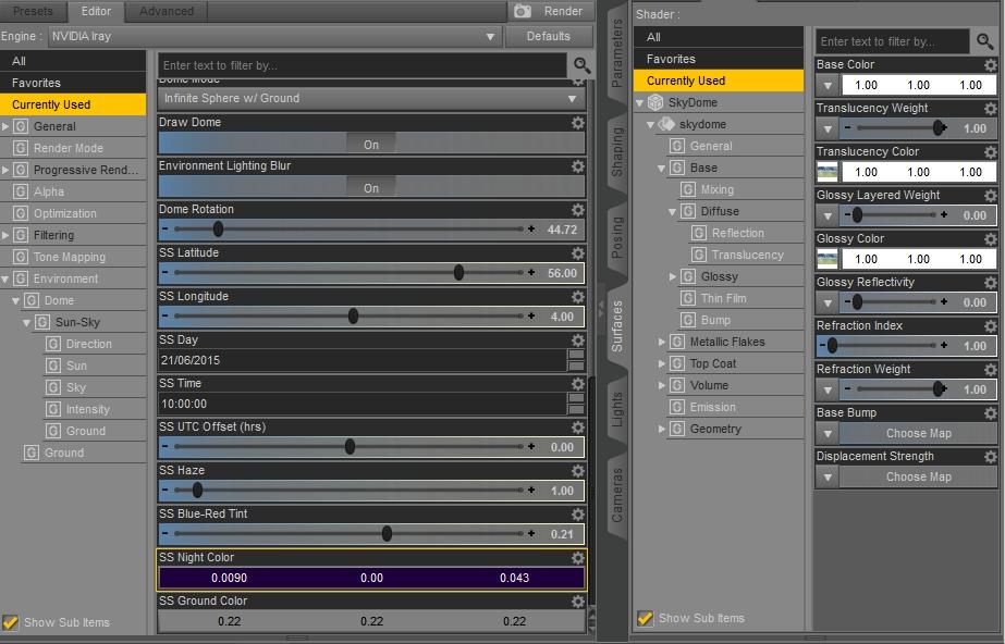

    All the settings I use are in the posts on that thread, there isn't really anything more to add other than not all Skydomes react the same and there are tweaks I do but these are render by render related so a step by step wouldn't really work :)
    The settings on the right of this image are my basic start settings for the Skydome surface.
    Click on image for full size.
    923 x 592 - 231K

    I am pretty sure all you would need is access to the skydome diffuse image itself. You would simply input this image into the Iray environment in render settings. Or, if you have a mesh skydome in your scene, you would go to its surface settings, and apply the diffuse image to the base color and emissive channel, and set your luminance to about 40k lumens.
