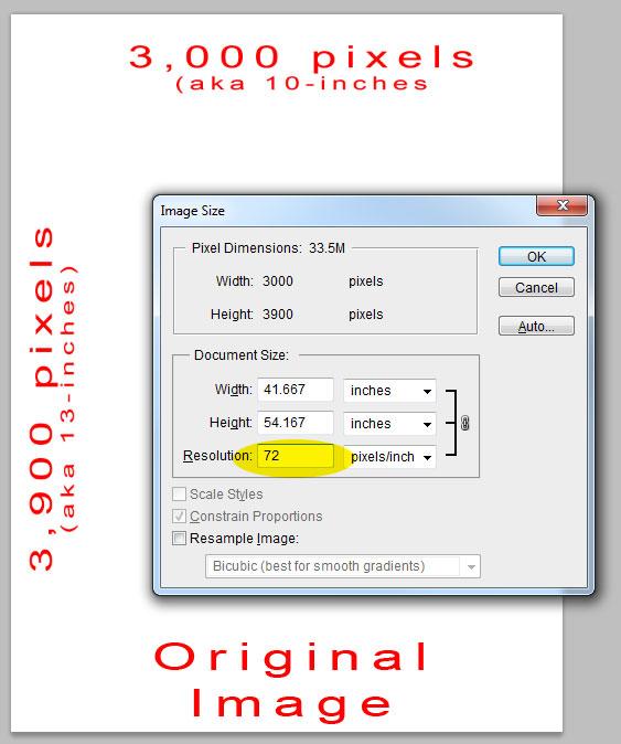

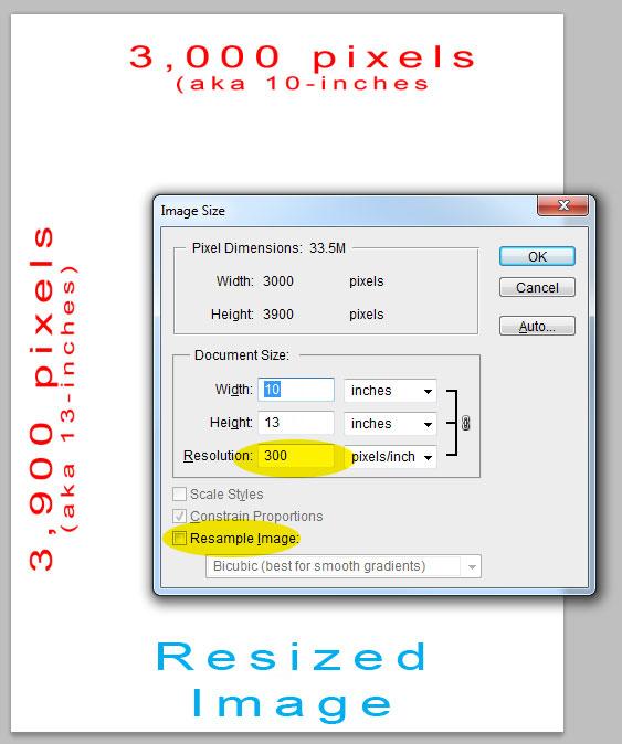

    @_manne_   Or anyone else who can answer this question.  I was watching the book cover webinar that _manne_ did and I'm trying to wrap my head around the idea of rendering at 72 ppi inside DS and increasing the resolution to 300 ppi in a 2D program.  Let's say that the final image size I need is 10 inches by 13 inches and I set my render image to those dimensions and render at 72.  Do I understand correctly, then, that PS can increase the resolution to 300 ppi and that will work fine?  Or do I need to render larger at 72 ppi inside DS and then increase the resolution and then scale down the image?  How do you know that you have enough pixels to in an image size to increase the resolution like that?
    I'm not sure I'm explaining my confusion exactly.  But, I'd like any info on this that anyone can tell me.
    Sorry that this is complicated, but printing terminology doesn't really sync up with the terminology used in 3D. As I would tell my students (and this is a generalization that I know will annoy some people who would rather that I speak in more precise terms about screen resolution, the differences between dots and pixels and their relation to image resolutions), but, simply put: A pixel is a dot and a dot is a pixel. Don't worry so much about pixel-per-inch (ppi) or dots-per-inch (dpi). In very simple terms (and I don't mean to be insulting in any way), but at your technical level you can use those terms interchangeably. If you dive deeper into the topic, you can learn the distinctions later. But for now, I think that's information overload and would distract from the question at hand: Image Resizing.
    Now, here's what you need to concentrate on: Always focus on the final, printed size of your image. If you need an image to be 10 x 13 inches and you plan to print at 300 ppi, multiply those dimensions by 300. This will result in a final-target sized image of 3,000 x 3,900. Now, when you open Photoshop (GiMP, or whatever app you use), you are in for a shock. The image details might tell you that your image will print at 41.667 x 54.167 inches. Yeah. That's humongous. The reason it says that is simple: PNG and JPEG graphics do not automatically store the information needed to print the image. In other words, Daz Studio always outputs 72 dip. That's just the way it is (and Poser is the same way).
    You can actually ignore this, if you want. It has no bearing on anything, other than your sanity. All that matters here is the Pixel Dimensions. So, if you want to change the printed size to your graphic (thus returning it to the realm of the reasonably sized graphics that will help keep you sane), you may do so by opening the Image > Image Size... menu in Photoshop (I know this is also in GiMP, but don't recall where – will someone out there look it up for us?). You will see the following dialog.
    This is where you will change the Document size.
    1. Make ABSOLUTELY SURE the "Resample Image" box is NOT CHECKED.
    2. Then change the 72 to 300.
    3. You will see that the Pixel Dimensions do not change, but that the Document Size does (see image below).
    4. The save your image again (probably as a PSD or TIF).
    And that's it. I cannot stress how important it is NOT to resample the image. You can destroy your work by resampling at this stage (it's okay to do it later, but not here in terms of this discussion). I hope this makes sense. And also, I hope you don't mind that I turned this into a blog post (I deleted your name).

    PPI and DPI are display metrics. D|S doesn't render with any notion of pixels per inch, just pixels. An image that's 1000 by 1000 pixels is the same image whether it's displayed at 72 DPI or printed at 300. The display/print device uses the PPI/DPI information to know how large to make the image.
    Therefore, a 1000 by 1000 image will display at almost 14 inches on screen, but print at only 3.3 inches on paper. Same image, different size.
    If you need an image that's 10x13 inches, you need to first determine how that image will be displayed or printed. Most printing is done at 300 PPI, so you simply multiply 10*300 and 13*300 to arrive at the pixel dimensions. D|S will also do this for you when you set the height and width sizes. Just type in 10*300, and it'll magically convert to 3000 pixels.
    Now here's where it gets tricky: There is no DPI/PPI information stored when D|S saves the image. To make sure the printer sees it correctly, open it in a graphics program and change the DPI. Make sure the pixel dimensions don't change, just the overall size.

    because DS only renders at 72 ppi.
    This notion will still mess you up. D|S doesn't render at *any* PPI. It's just a series of pixels horizontally and vertically. The file it saves lacks the PPI metadata, which is used to instruct other software what size to reproduce the image at. Most software defaults to 72 DPI/PPI to display or print it, but that's not the same as D|S rendering at any specific resolution.
    I don't use Gimp so I don't know how it works, but Photoshop defaults to resampling on, thinking that if you change the PPI resolution, you want to keep the same physical dimensions. This causes the program to maintain the same output size. That's unnecessary for what we do, and it results in some serious loss of quality as the image is blown up. If the graphics software you use doesn't have a resample option, just change the resolution but keep the physical size the same. Verify by checking the image has the same # of pixels before and after. That's your target goal.
