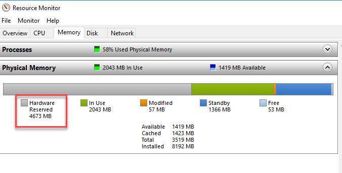

    Yeah, for some reason, your computer can only use 1.5 GB of ram. Even though it "sees" all 6 gb, the major mystery here is what on earth is holding 4.6 gb of ram that is "Hardware Reserved." This is what is causing your problem. Its not Daz, nor do I think it is Windows. I think the problem began before you did your clean install, perhaps something was leading up to this which caused your slow downs.

    I am really concerned you have a hardware problem. Given the amount of ram that is reserved, that indicates that the something is wrong where the 4 gb stick is. It may need to be reseated or cleaned. You could also try swapping the two sticks of rams with each other to see if that changes anything. It could be the ram stick itself, or in the worst case, it could be the motherboard or even the CPU. I feel very strongly this is connected to the slow down you experienced before. To be honest, I have a bad feeling about this. But hopefully I am wrong!

    That was also my first guess, but devilsatdusk15 says s/he can't find any Memory Map Feature option in the BIOS. I still believe that is the problem, here's how it looks for me when I turn off that feature (plus Windows is much slower):

    I've just taken the panel off and tried to remove the RAM, but it's like they're superglued in the slots. I must've done something, as the read out has changed in Resource Monitor (see attached). Hopefully, it's fixed. Although, I'm not totally happy, because I'm now going to get paranoid everytime I use the computer (I keep checking to see if it's gone back to being faulty). I will never mess with BIOS again. And, if it does go wrong wrong again, it'll be going to the repair shop.

    Glad you got it working again. If there's no Memory Remap feature in BIOS, there's some advice here about swapping the RAM Modules which should fix it.

    If jiggling the sticks solved it, then it's likely it was just a loose stick.
