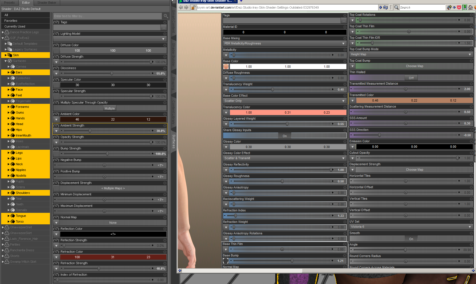

    Looks like you are not the only one working on skin, some body in (I think?) the old lab thread also is attempting to do the same. I'm looking at the Iray skin settings referenced to, and some of it is incomprehensible to me. Like the 0.00 to 1.00 color boxes, what is that in sRGB (24-bit numbers)? And what is the difference between Translucency and Transmitted colors, I'm guessing Transmitted is something like velvet as the other is the same thing that it is in 3DL Uber and AoA shaders?
    I think I'm going to just drop the numbers in to the daz default (without conversion) and see what happens, lol.
    Refraction strength 40%, Refraction color 100r 31g 23b,
    Gloss strength 55%, Gloss color 30r 30b 30g, etc lol.
    Ah, an experiment to do to some one, where is beaker, lol.
    (Disclaimer) I am not actually trying to duplicate an appearance of the settings in Iray, I'm just morbidly curious of what would happen if the exact numbers were plugged directly into 3DL without any conversion at all (aside from removing the decimal point from the numbers).
    Well, looks like the numbers are close enough for my random curiosity, and clearly the colors are NOT the same, lol.

  • Oso3DOso3D Posts: 15,108
    Transmitted is what color shifts to after a certain distance.
    Like, if you have fog, and blue transmitted, the fog goes from white to blue over the distance. Good for getting a sense of depth and color shifting through a volume.
    edited December 2016
    Ah, OK. So it is not something like velvet or subsurface. That is an interesting setting I guess with some unique possibilities for some cloud like stuff.

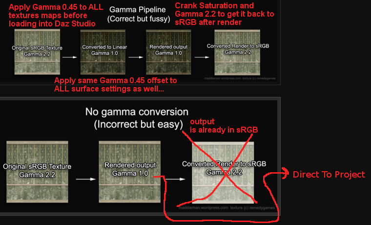

    As for trying to get good skin tone color depth with gamma correction without post processing the hell out of renders, I am not the one to be helping the other fellow.
    http://maddieman.wordpress.com/2009/06/23/gamma-correction-and-linear-colour-space-simplified/
    I don't use gamma correction in Daz Studio 3dl for many many many reasons, not to say it is a hell of a lot more work then I'm willing to torment myself with, I'm staying out of that one, lol.

    It's often used with subsurface, because it interacts with volume effects. So with skin, transmitted affects the look of the skin because it gives skin a 'deep' color.
    If you look at any of the standard store Iray skins, or the default skin converter, you'll see transmitted color for this.
    Nifty, I was thinking the other way tho that works. So it would work well for something like fruit juice or plastics, tho may not work for a surface of a star decreasing density and temperature of gasses with distance from the star effects.
    Well, I'm really starting to like the altered skin settings. It's almost like a Dark matter or Dark energy version of Trance .
    I'm just not sure if I got the fingernails, to dark.
