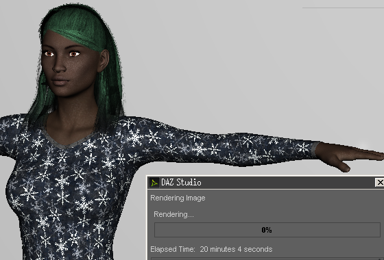

And here I'm waiting on a render so I can Post a comment, and I already have another idea to work on, lol.

Yep, yep. just needs the SnowOff to make a silly render...
What do you say not enough room to do the render for , Oh, it is 3.7GB of texture maps on a 4GB Dram-Drive , I need a bigger ram-disk, lol. I'm just to negligent to pay for the app at this time, so it's stuck at a 4GB limit. And here I was thinking that "I have 32GB of ram for 3DL" no sweat, I'm not limited by the NVIDIA memory negligence, I can do this, lol.

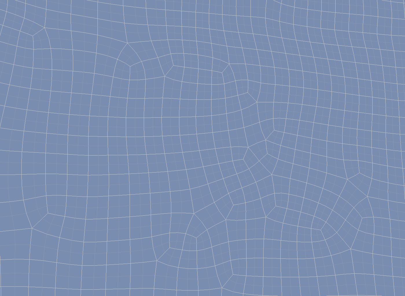

Apparently you can get some rather odd gloss anomalies in Daz Studio if the object quad mesh is not somewhat consistent on fairly flat areas of the mesh.

Also, apparently there is an interesting quad re-mesher floating around that I haven't been able to look at yet, so I have no idea how good it is or not. And if it is able to preserve mat zone boundary mesh lines in the process (z-brush can do that).
The only example that would show any gloss mesh density anomalies is in Blender and not Daz Studio, so the example screen shots dose me no good at all.

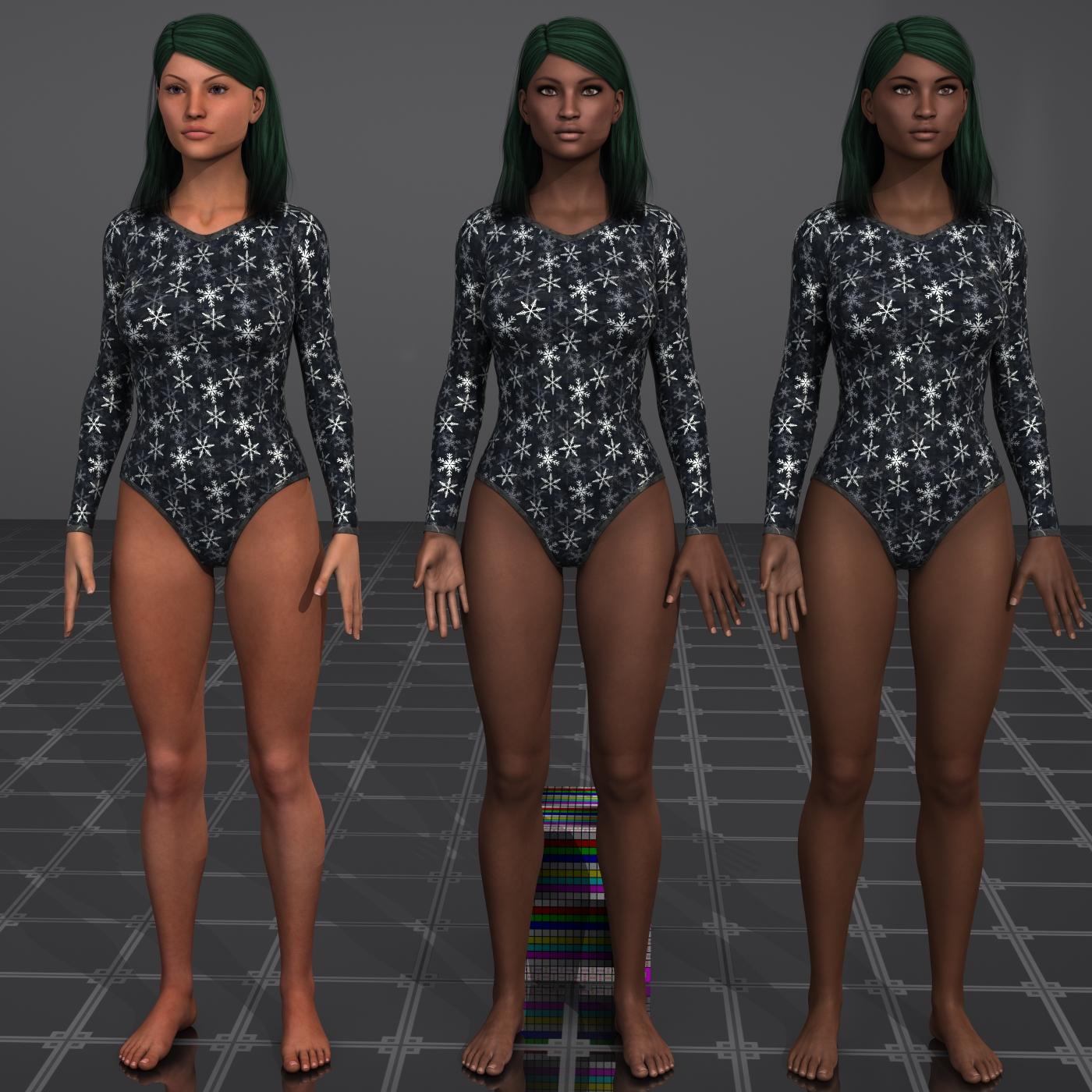

While the stock mats appear to be reasonable for render times with a face plant of only about two minutes, and the spec maps appear to be ok and not overly dark everywhere... , this is another 'G' rated eunuch, figures. Why did I even bother with the leotard, lol.
Well I opened this can of worms, I may as well see it threw. The figure shape is not as exaggerated as some, perhaps a hint of abdomen size if anything, so I kind of like that. My first thought when I was just over in DIM, was to try some shoulder dials on these two figures, I'll still do that. (T.B.C.)
Just remember 'Z', you can always use Paloma's mats on her, lol. (I now have two things I must do after this litle experiment)
On to the other one for the 'Experiment' tho I will need to do something about that render time.
Nice to see nothing has changed at all with the AoA shader What a piece of work (tap tap tap) is it dead?
Oh, it finaly got it's GUI out of it's back-end. I knew you could do it AoA shader even tho your not on a top500 machine. I pity all you folks on four core and lesser machine that are slower then 4GHz, this *** *** *** *** *** *** *** *** (an hour later) *** ***, lol. I may have an 'AltShader' floating around here somewhere that will work better then this, lol...

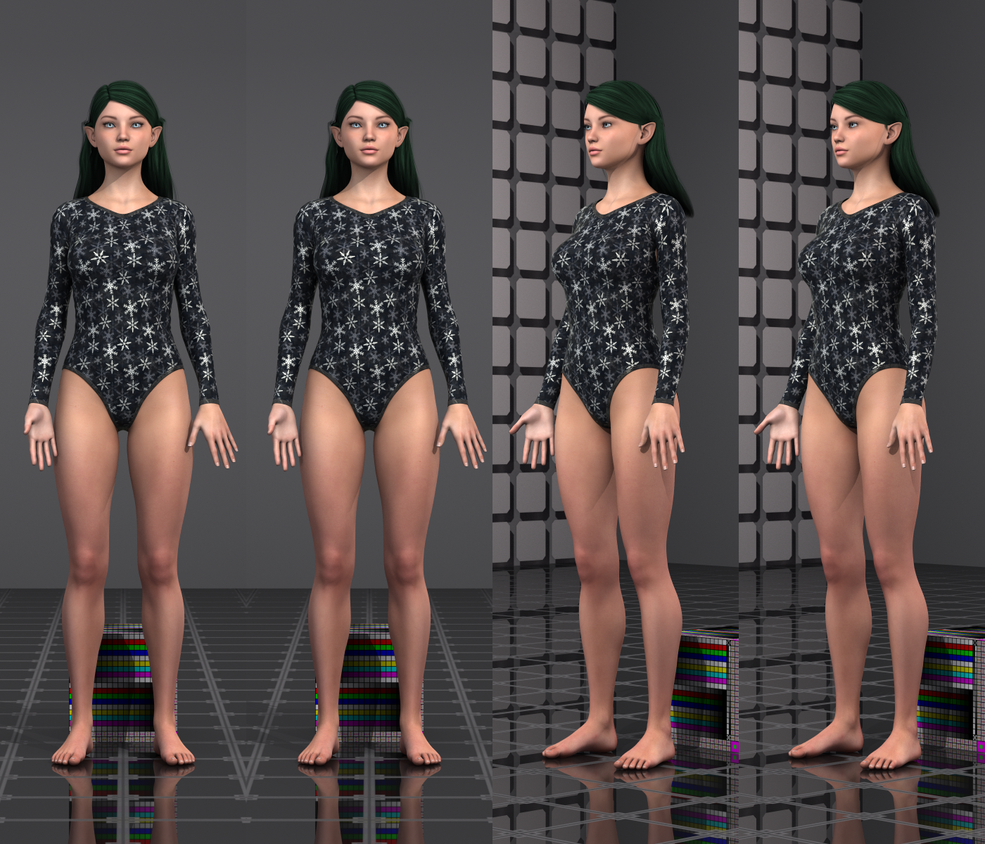

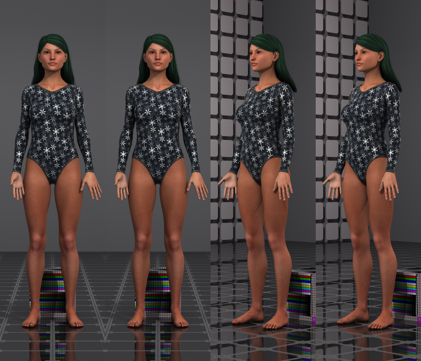

Part one of I don't know of the shoulder experiment, lol. All with No-High-Heels 25% (Youth posture) and anti-barbie-waist 25% (abdomen size) dials. one is as is, the other is with Shoulder width +25% and shoulder size +10%.
This was one of the ones that had me thinking that somebody may be on to something. This figure can not have the arms down without the arms being inside the upper torso, that spec there is not the outfit (there is a fix). hmmm.
, , , , I think I'll need to try this on a few more, I honestly don't know what to think of either way yet. It may very well depend on the figure as much as taste. Am I supposed to have an opinion on this, where is my decision dice, lol.
It almost looks like the shoulders are being pushed back to make the chest appear bigger, na I'm imagining that, can't be. G3F with a baked in chest-thumping posture , Naaaaaa. lol.
Now I did do a minor setting adjustment for her arms here. It's an easy one, that may be helpful to many.
Yep, that was it. Works incredibly well given the Leotard is not trying to be a few inches inside the figure unlike other things, lol.

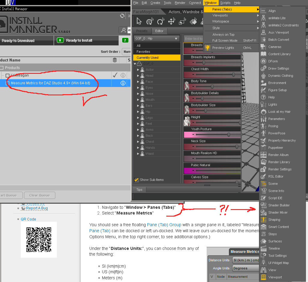

As for the shoulder thing, Zarcon, do you have the measure metrics plugin? Or a simple cube will do, if you make it about 17 inches wide. That's a passable shoulder width for a moderately athletic 5'8" female. // other measurements being around 35-30-40 - but I don't know how to match these without measure metrics //
A number, I didn't even think to measure, I was just objectively looking at the overall shape (are the hips wider the the shoulders). I don't have a caliper large enough on hand, yet squeezing my shoulders between two water bottles on the kitchen counter and then measuring the distance between the bottles to get a rough guess, somewhere between 16 and 18 inches sounds about right for 'human' shoulder width with the arms down at the side (Give or take some margin for body shape).
So, 17inch wide cube, about where on the shoulders, then again it may not matter at all, lol.

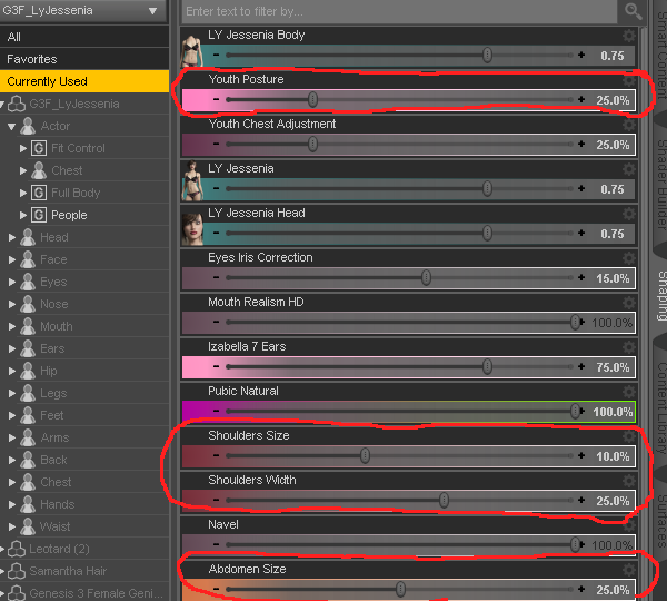

OK, so I need to be tossing that dial way more then the "I'm afraid of irritating someone" levels I had been using.

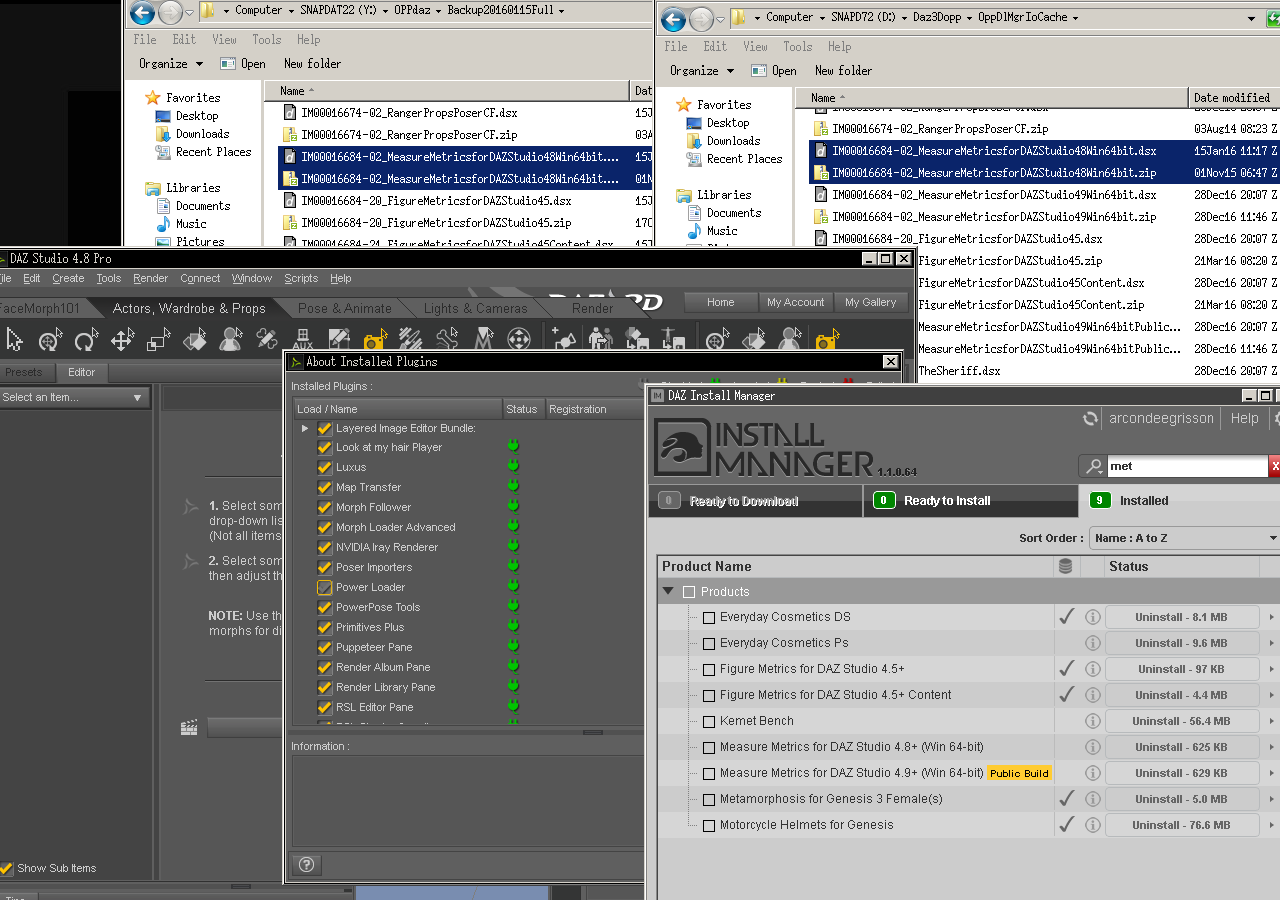

BTW, I did purchase that measure-thing and DIM did put it in the computer, then I discovered how to use 1cm and 1inch cubes to measure stuff and didn't do any more with the wherever-it-is-thing. The problem with just using circumference measurements, is they tell you nothing about the oblong-ness of the oval that was measured. It is ok for most cloth sizing, So the measurement is 40 inches, that tells me nothing about how wide the arms on the chair need to be apart from each other so someone can sit there, lol.

I guess I should look at the measure-thing again to figure out how it works, not that I think it would help me much (I do remember something about it being better for figures rather then random objects).

Well, that apparently is why I never bothered to use it. It done busticated like camshaft chunks in the oil pan.
Morning from the day later. I figured I should give the 4.8 version a try instead of the cannon 4.9 thing, and still nothing. And yes I already tried removing All of the MM zips and reinstalling it all from daz again. The Beta version just gives a 0.000000 no mater what I select/move/target/etc or what kind of tape I use. To quote myself from yesterday "It done busticated" and it is just not going to work regardless how much monkeying around with oil additives I try.
This is done, the fork is already in it. And the fix is just as painful, remove everything associated with 4.9 including Studio 4.9 beta, and then reinstall 4.8 measure metrics.

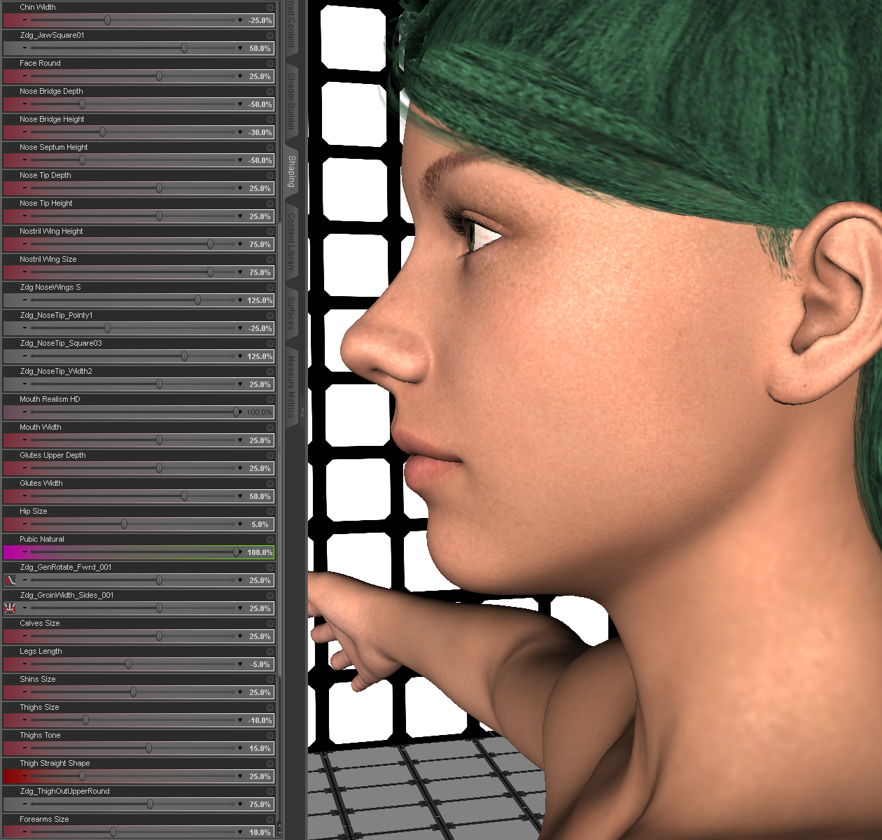

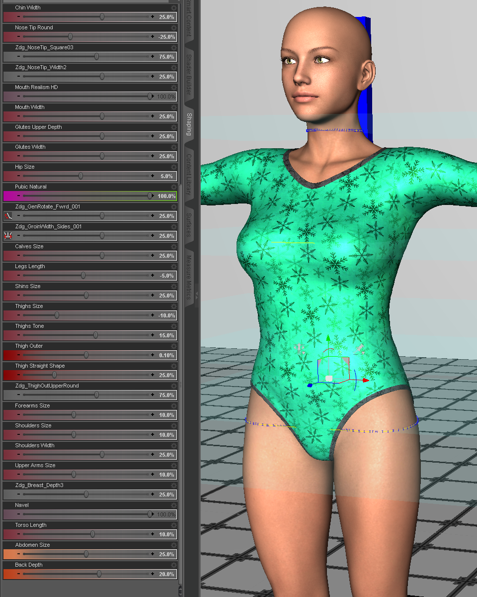

Yea, I'm still trying to figure out what dial dose what shape. At least one of the dials will need to be broken so it can be tossed into the negative forty range.
About 5'9" (175.26cm) height, instead of 5'4" the old one was.
OK, looks like two dials need to be slammed past the 'limit' into the negative, this is not encouraging. I'm fairly sure that if a master control dial tires to tell a dial to go past the limit, it won't happen. I may need to find another way to do this as I don't think the dials will work for a master control dial, not past the limits.
There is another way, make my one dial that dose exactly what I need (7 dials total so far in that set tobe).
And now I don't need the other dial byond the limit in the negative (You'l still need that Shape Shift set tho, and the Growing up No-High-Heels as well).

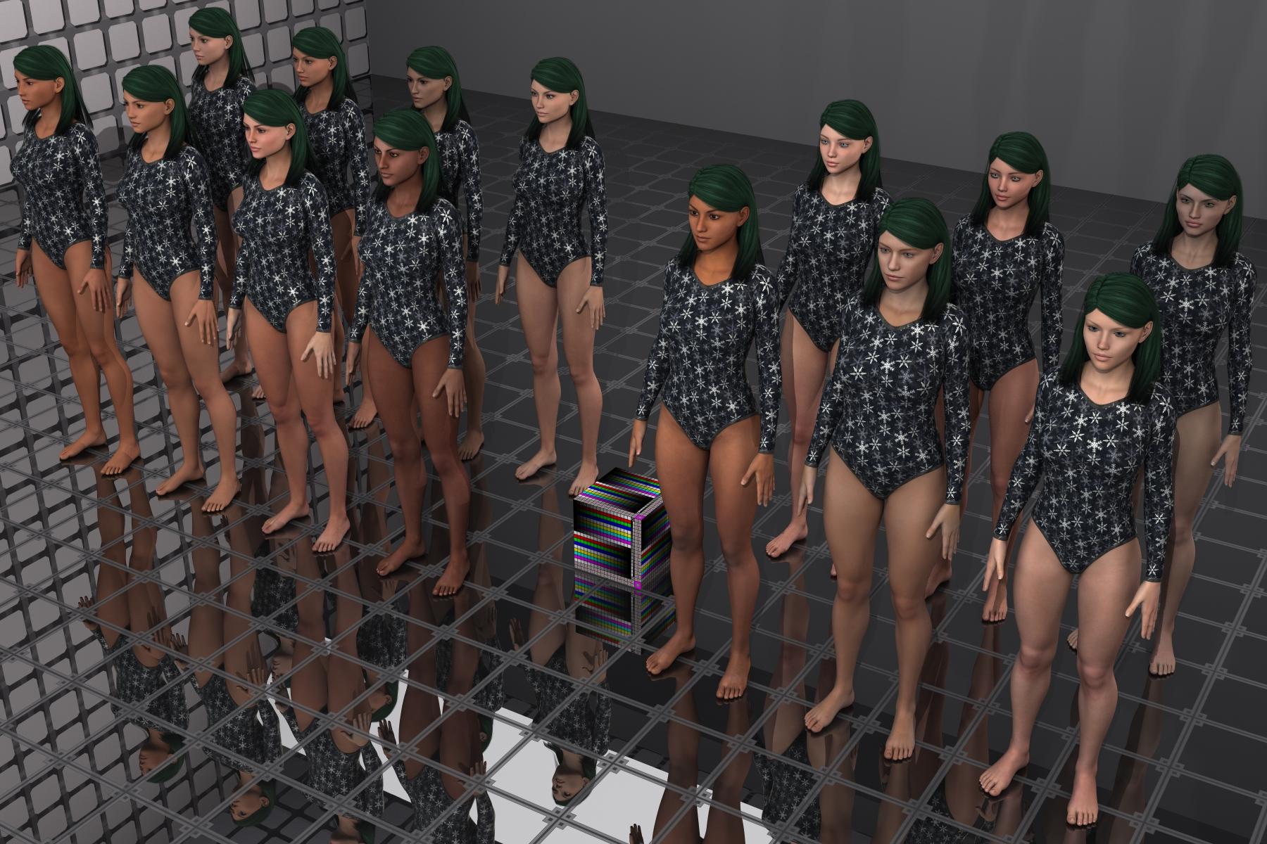

Alright, this is the pre-alpha of what I have so far. I only have some eye color folders so far, and many yet to be done other things.
https://www.dropbox.com/s/c97bzprx0szpwxt/ZdgGen7AltShaderExpPack01_v000v.zip?dl=0
Very primitive 3DL mat preset set for DES, Freja, FWSA, LY, P3D, Raiya, Silver, and G3F2W Paloma mat presets. And I still more to do, ugh.![](http://www.daz3d.com/forums/uploads/FileUpload/94/936eabb340e85831f11cbc55724ca9.png)
(Eye presets for forteen figures).
Front L-R, Des Grace, Des Kaia, FR Agnes, FR Enya, Raiya Kelly, Raiya Jolina, LY Hanny.
Back L-R, Fwsa Grace, Fwsa Paloma, Fwsa Sushmita, Fwsa Yulia, ADSI Glimmer, RS Lindsey, LY Jessenia.

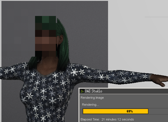

Unfortunately some rather expensive rental programs that cost an arm a leg and your first born child have considerable difficulty making consistently shaped quads on an object. I ran into almost the same exact mesh oddity with my attempt of making an Egyptian bracelet, except I was unwittingly making the mesh into that manually rather then having a mesh generator automatically make the item mesh. There is a way to fix that, however it involves passing the object threw another rental program that costs an arm a leg and your first born child, to re-mesh the thing so it looks good in Daz Studio.
Just something for thought before you consider a single program to be "The bees knees" for do it all from scratch content creation.
I think I'm suffering from eggnog hangover, lol. There is a few things I just cant quite figure out the words to say, that I was looking into, and I've been milling over what to type for some time now. One was a random skin tone setting test that I thought would be somewhat funny and turned out to be sort of good looking I think.
Right is regular FW Eve, left was a spontaneous what if thought. The Iray shader dose not list colors in 24bit sRGB values (0 to 255) and shows then in a value between 1.00 and 0.00. What if I drop the decimal and just plug in the numbers directly without converting percent into 8bit values, lol. Damn, that is not that bad looking
http://www.daz3d.com/forums/discussion/66463/free-retopology-software
As for the other thing, I think I need to fumble around with shaping dials and get some examples going, as I'm still not decided on the matter.
Ly Jessenia is far right with those settings in the render below.
Now granted, I could have done the fifth dial a different way, throwing the 'Implants' dial into the extreme negative, however many outfits do not respond kindly to that. Now I will continue to be a habitual user of the No-High-Heels (Youth posture) and anti-barbie-waist (abdomen size) dials for the foreseeable future, it would be best to just assume that those two dials are in every render that I make, lol. The shoulders is something that I decided to try after a PM, just to see. Some figures do have rather odd combinations of extreme adult implants mixed with odd youth features, and others not as much. I did try that shoulder thing on the other two figures (Yulia and Glimmer), and the results was mixed. Yulia looked fine, and Glimmer not so much.
As of now, I'm undecided on the shoulders. And looking at the dials, I did make a mistake sort of, That is the V7 replaced with Izabella7 Yulia mod and not the V7 original, That may be a contributing factor, oops.

Welcome to working with PBR maps, lol. The reason the palms of the hands are so gray, is because all the color is in the subsurface maps (exactly as the PBR crowd insists it must always be done that way), and I'm ditching subsurface in favor of getting stuff done, today.

Alright, here they are dialed in at 75%. Now the experiment can commence

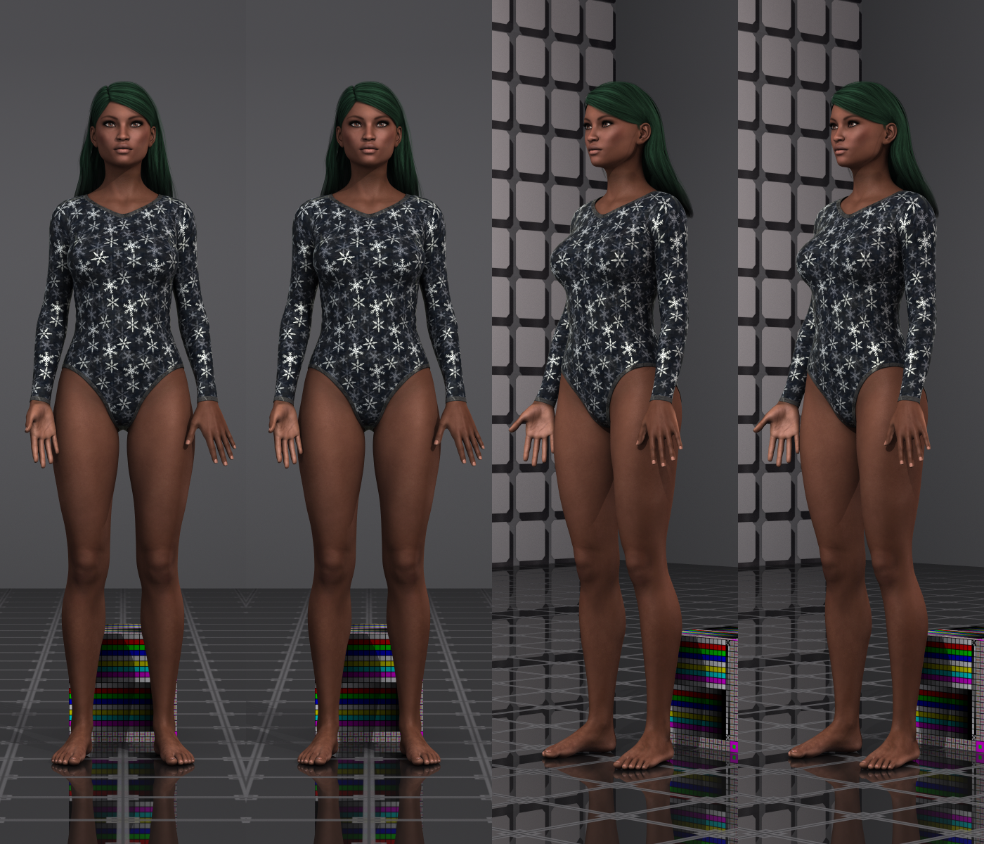

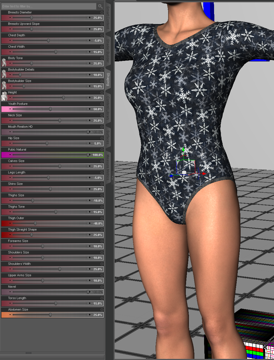

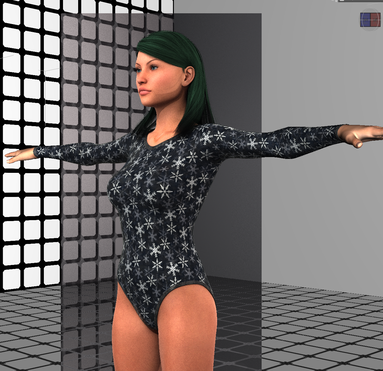

Naaaaaa. lol.

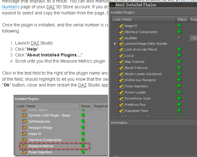

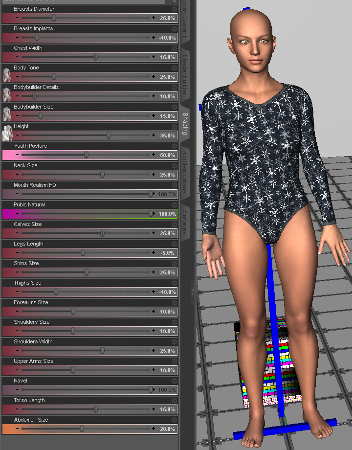

(face desk) Oh yea, measure metrics, where did that thing go... (The two vids in the store are absolutely useless).
