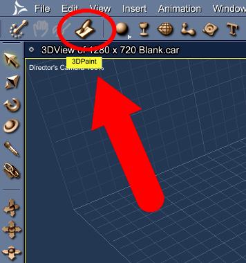

In Carrara's 3D Paint (which is pretty darned cool - but takes some practice*) we select which domain (otherwise known as Material Zone - both are synonymous) we'll be painting on - then we select which shader channel we're painting into.
Once we get to this point (couple simple clicks) we're presented with a new stack with only one source. We click a button to "Add Layer" to paint on - then we paint or stamp down image maps in layers whose opacity can each be controlled separately, much like we'd do in PhotoShop, PaintShop Pro, or similar.

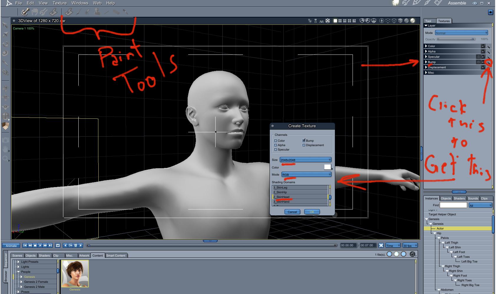

Because of this whole layering structure, I advice that, when asked, choose PSD file as the saving extension - because other types don't support layers, and Carrara is fine with psd. This makes it so we can save, close, reopen, and continue working.
Here are your painting tools (sorry for the old hand-written on image)

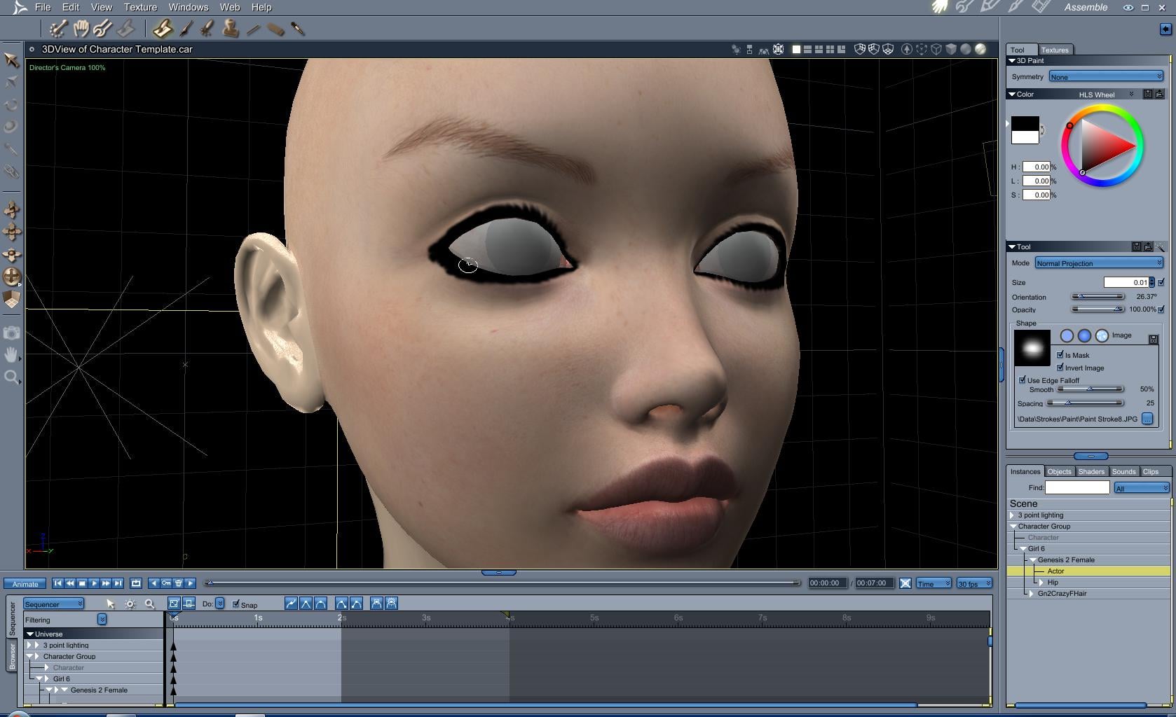

If you look at her Right Lower Eyelid, you'll see my Brush icon, which shows the size and the direction, which updates nicely as we paint.

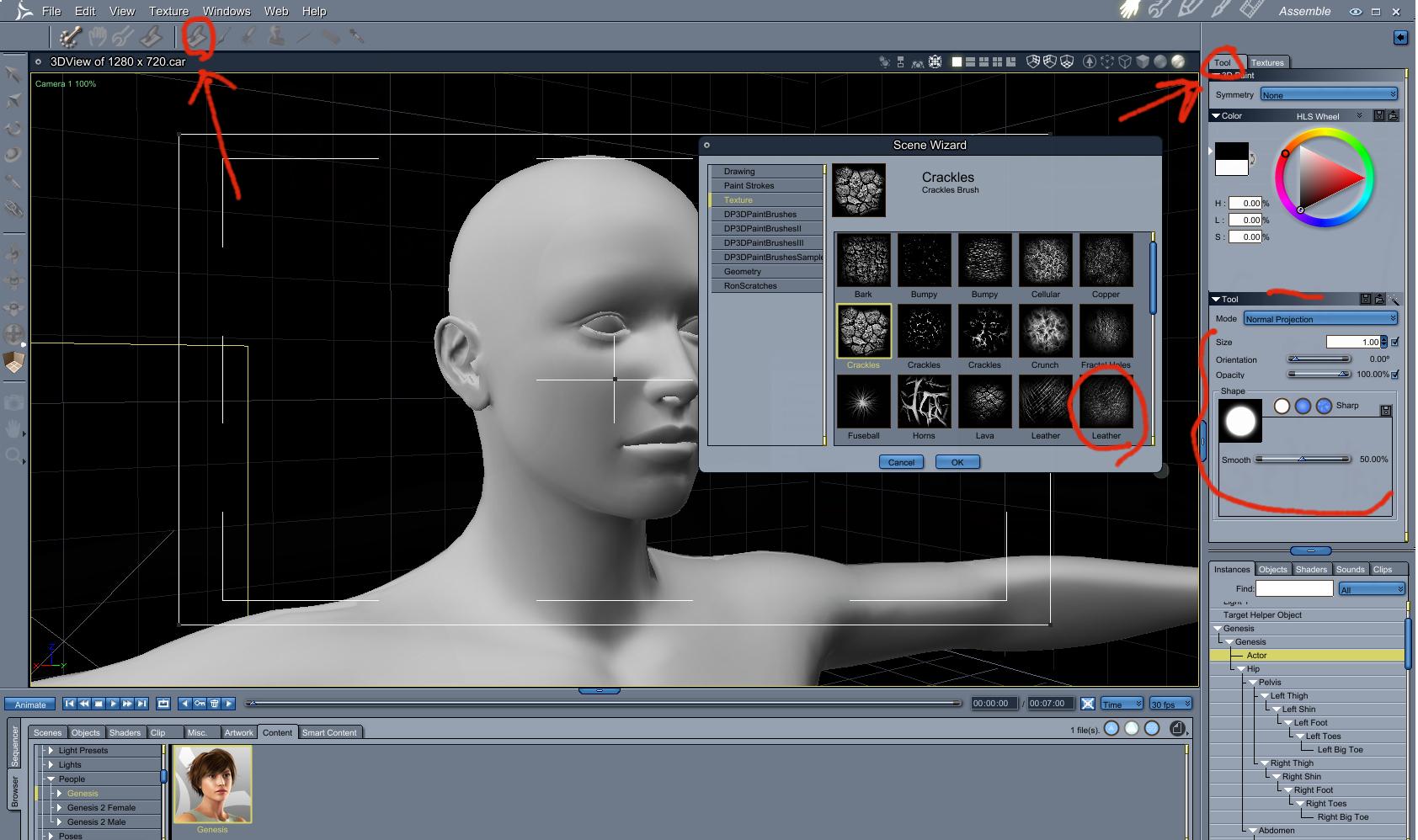

Here are some standard Brushes to choose from. Notice in the dialog box that I also have GKDantas' Ron's Scratches and Ringo's Brushes as well

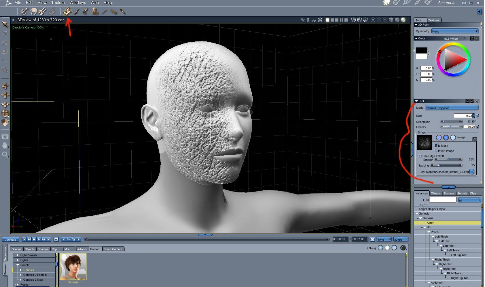

...and we can Displace Easily - this example being (possibly) exaggerated
I wanted to show where the Tools are (the hand-drawn crappy image) because it's really cool to be able to use a Line tool - set the width and color and click down the beginning and ending. Really cool stuff.
Carrara ships with some nice brushes, so I hope nobody feels that they might have to wait on getting some new brushes before trying this feature.
The other sets doo add a lot of cool new brushes... 'tis true! Carrara's native brushes are really nice though.

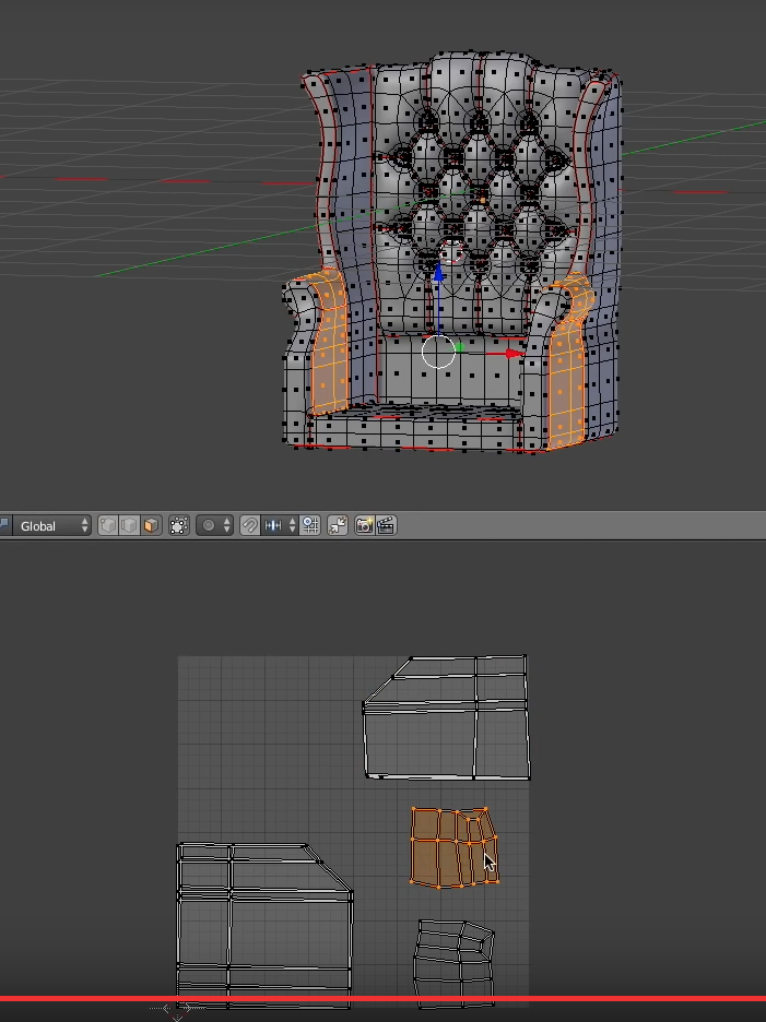

Usually I make my UV unwrapping in the same program where I model, in Blender 3d. It’s free and powerful software.
