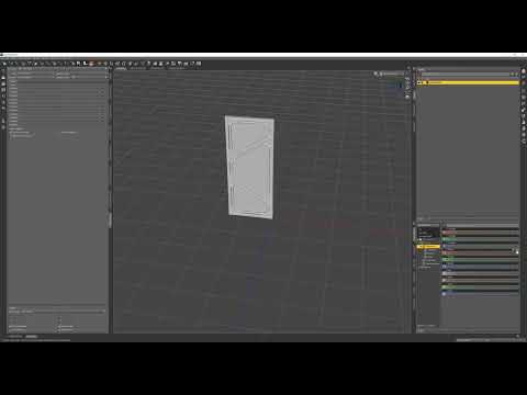

    I also had a problem installing pivot and I wrote this script, maybe it will be useful to someone. Please try it. Video :
    zip
    zip
    ResetPivotAndMemorizeUniversal(Eng).zip
    1K
