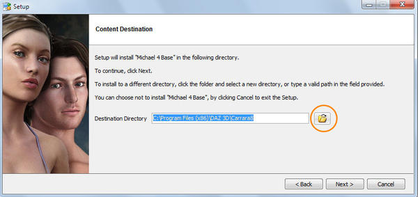

    Tp answer your questions: I'm using the production build of C8 pro. I'm working from a windows 7 64 bit edition. And lastly I used the M4 base for windows that came with Carrara 8 pro and I tried just about every location I could think of.

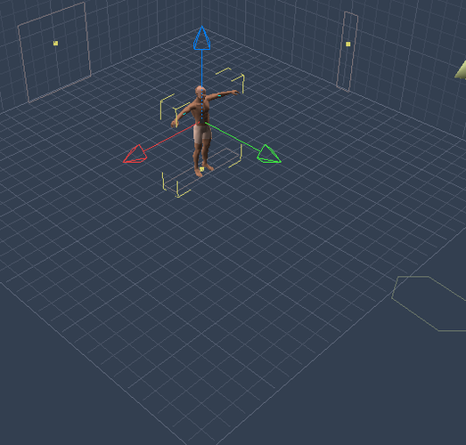

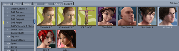

    Does the figure show up in your Content Browser? If it does, try either dragging the icon for the figure and dropping it in your scene window, or double click the figure icon to load it into your scene.

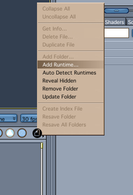

    If you've installed the figure to someplace other than the standard install location, you can load the Runtime where it is installed manually via the Carrara Browser. With the content tab selected look for a black icon on the far right of the Browser and select it. It will open a pull-down menu with several options, including the options to have Carrara look for runtimes or to add your own manually.

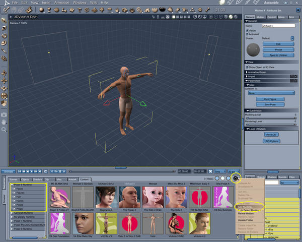

    If you don't have Poser,. or Daz Studio installed,,. you should still be able to browse, and install M4 base into another folder. (see pic) and then you'll need to Add that location to Carrara's browser.
    It's recommended that you install any "content" files to somewhere like,.. My Documents / My 3D Library /
    Daz Studio,. and Poser both create a set of folders, which can be viewed in Carrara's browser,. (Content / Runtime) folders.
    You can Add a "Runtime" to Carrara's browser, (see pic) and it will display a set of categories, ..Figures / Poses/ Props / etc..
    From the browser in Carrara, you can load M4, into a scene, by double clicking the thumbnail image in the Figures / Daz People / folder.

    7. do the Daz install dance and when prompted where to install to point the installer to eg. C:\Users\Myname\MYDocsFOLDER\Poser5 Runtimes\Michael 4.0 (M4)
