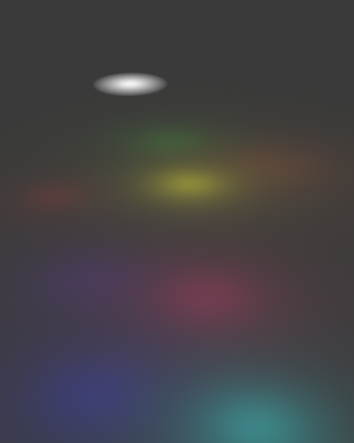

    In the previews, you are limited to only 8 lights...total.
    Here is a render...how many lights are casting?

    It looks like you have  9 lights  How did you do that?  I knew there was a way of adding more lights
    But I'm using 10  linear points of lights on my light poles props which 2 of them won't show up in my renders,  I'm really confused,  lol
    what is preview?  I thought just making a  test renders of different keyframes along the timeline I'm working on using open render in new window.  do I need to render direct to file instead?
    512 x 640 - 212K
    Post edited by Ivy on
    Actually, there are 10...9 linear points and 1 distant (the distant is set to only about 5% intensity...much higher and it starts washing out other lights.
    Anything that is showing a camera, light 'sphere' and stuff like that is just the viewport preview.
