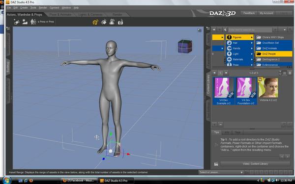

Ok....Under poser settings, it goes My Library > Figures > DAZ people > and there is no Michael 4 there at all, even though I have repeatedly tried to install the Michael 4 content. There is only Victoria 4.2 and some other V4 apps.

And could you please post a screenshot of your DAZ Studio default folder (My Library?), showing what is in it.
