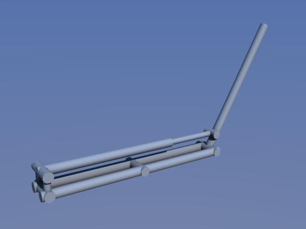

    Interesting discussion - I haven't got the Cyber Model but using just Point At works fine for a structure I just built using primitives as a quick test. Good technique!
