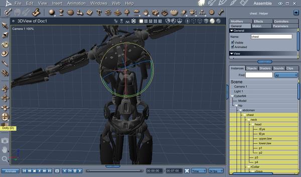

Ok, interesting question of curiosity here:
I bought DZFire's AWESOME Cyborg Model 4...
Very fun model. Very cool approach to the figure design with lots of extra bones for the hydraulic pistons (so there not part of the arm / leg bones, no distorting when bending the limb joints). There hydraulics are in 2 parts: piston rod, and piston housing. Each part has a base connected to the model, and the ends connect to form the complete hydraulic piston.
In Daz Studio, when bending any of the joints, even the torso or head or neck, the hydraulic pistons move on their own correctly with the rest of the body. Almost as if the rigging supported multiple children & parent bones.
Not so with Carrara. Just means posing the hydraulic pistons and cylinder houses separately and manually. I'm fine with that, as with most things Carrara, using Poser content, extra little tweaking here and there goes with the program (its worth it though. i don't mind it honestly.)
I've just been wondering, what's in DS that does that automatically for the figure that Carrara doesn't have.
And secondly, if there was an alternate way / workaround to get a similar functionality of having the hydraulic pistons move when posing the model.
Example, Upper Piston P12 is connected to the Chest, while the Lower Piston S12 is connected to the Hip...
Ideas anyone? Carrara Pro 8.1 / 8.5 beta , Windows 7 btw...
Thanks!
1024 x 600 - 189K
1024 x 600 - 189K
Post edited by CoolBreeze on

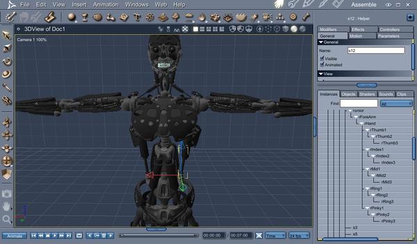

  • DzFireDzFire Posts: 1,473
    Just found the thread. The feature with the pistons working like they do in Poser and DAZ Studio is the 'Point At' feature. I haven't used Carrara much, but I think if you select the part (ie P12) then click on Modifiers, select "point at" and finally select the corresponding part (ie S12) from the drop down list. the fist part will point at the second part. You'll need to do the same thing for the second part (ie S12 to P12) the two parts; piston rod, and piston housing will work correctly.
    Now the fun part, you'll have to do this to all the parts, piston rods, and piston housings. The P parts point at the S parts with the same number and the S parts to the P parts :P
    Hope this helps

    So I noticed that when you select a piston instead of seeing a bone, you see a bounding box, and the piston is not parallel to the box, it runs diagonally through it and I believe this is why the point at modifier doesn't work, it uses the angle of that bounding box not the actual model. i couldn't find a way to adjust that so I thought what if I export him as an obj. and just make a whole new skeleton. So I'm currently in the middle of building a new skeleton, it's a lot of work, but I think the movement of the model will be even better than the original M4 rigging and I'll never have to animate those damn pistons by hand ever again. I'll post some results when I get there.

    So I did it, I exported Cyborg Model 4 as an obj and built a whole new skeleton, so point at modifiers actually work now. I have to say I am very happy with the results, and I will never have to animate those pistons again. Next I'm going to do the same thing for Stonemason's prototype, it has the same issue with pistons.
