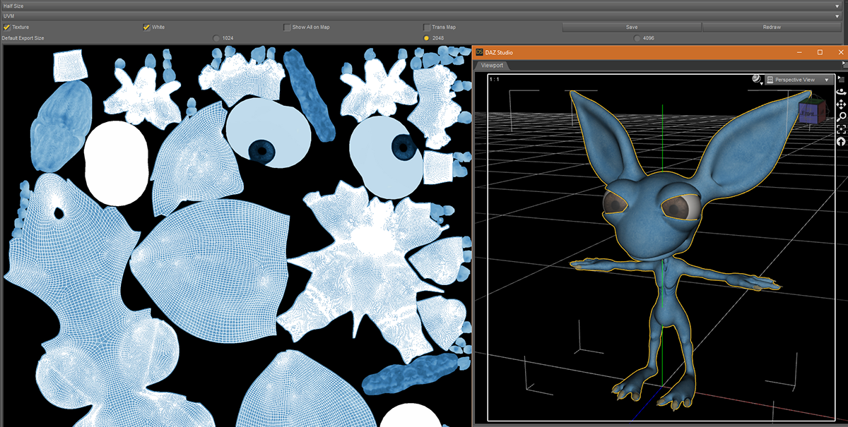

    You have to go to help - about installed plugins and the copy and paste your serial number in and restart Daz and then mine showed up under Window - Panes.
    This tool can become quite handy. I selected just the skin in the preview pane and it highlighted the uv part of just the skin on the left and added the UV map over it and left the other parts as is. I am liking what I seen so far. The option to see the UV map in a dark or light color is also handy and will make it easier for it to stand out against the textures
