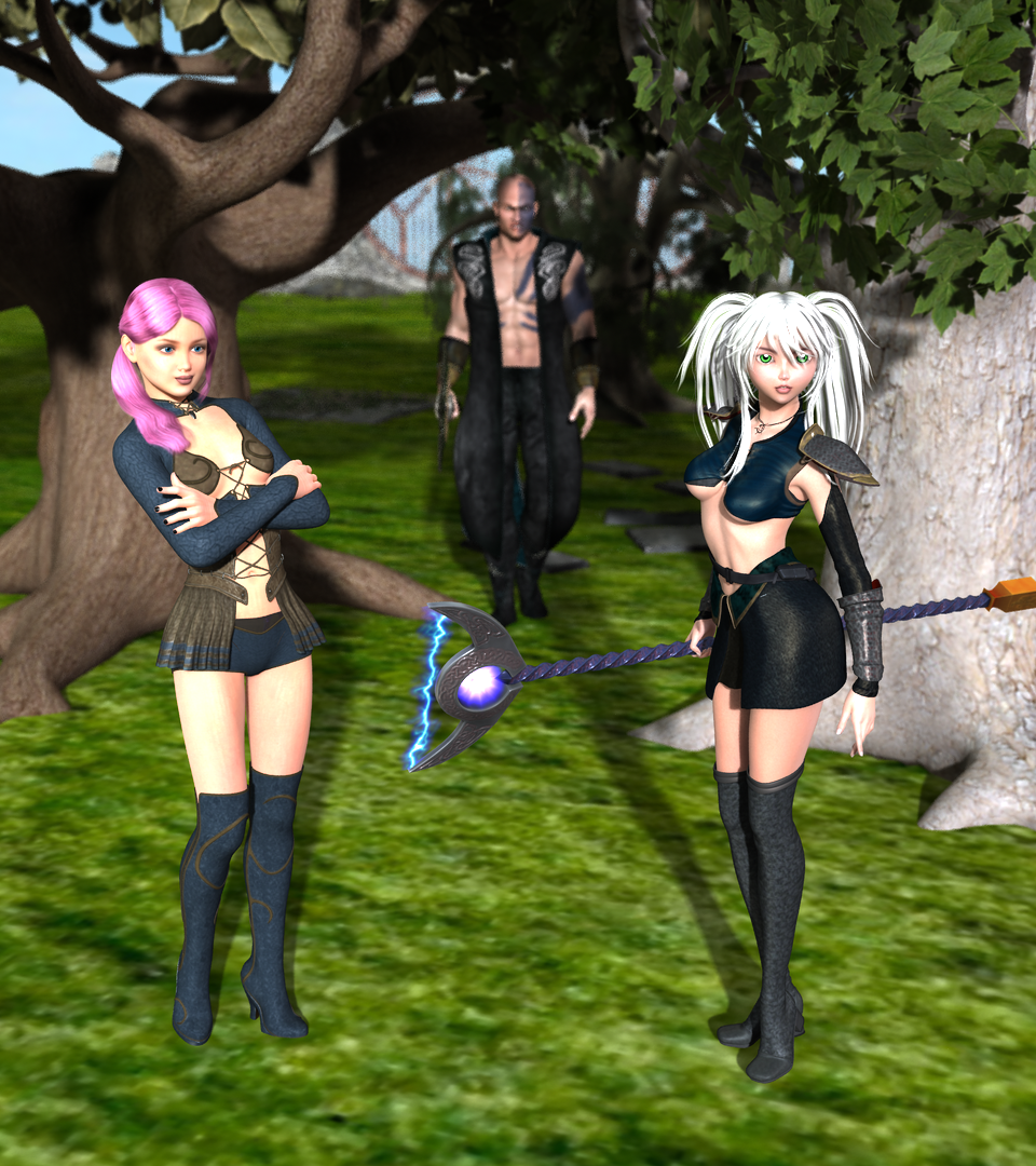

    So, another experiment for the laboratory (an especially tricky one for me!!) - So I went back to 3Delight to try out a traditional Toon/Comic type effect using Visual Style Shaders which at the time I was using 3Delight (many moons ago!) I had no idea how to use. Setting up the shaders was a lot easier than it used to be thanks to actually knowing how to use shaders thanks to all I've learnt with iRay so got an effect I liked quite quickly. Making 3Delight render the characters shadows though... total lost cause!! In the end I rendered the shadows in iRay and applied them with Photoshop, also used a filter I created in Filter forge to enhance the outlines a bit more - quite pleased with the results so I may continue to do some more actual toon/comic style renders as I go along and keep my hand in 3Delight as well as iRay.
  • LinwellyLinwelly Posts: 6,069
    KA1 I don't get why rendering shadows in 3delight was a problem, can you describe what made it difficult? Maybe I can be of help. I like waht you did with schaders and filter forge, it's an interesting style.
  • KA1KA1 Posts: 1,012
    edited April 2016
    I remember that I used to have to check in 3Delight that shadows were enabled and that I had raytracing was selected for the lights, I played around within all of these settings but for the life of me could not get the characters casting a shadow on the floor. I could well be missing something (probably am!) but I couldn't figure it out!!
    *Edit - As you can see from the attached image I did in April 2015 (a very early render of mine!) I did get shadows!!
    960 x 1080 - 2M
    Post edited by KA1 on
    KA1 said:
    Ok, trying to figure out what your light settings were, there is obviously one coming through the window that should cause the window pattern on the floor (if you did'nt make that effect some other way) From the angle of the light though the window a shadow of the people would come only very short and withing the "window on the floor" pattern.
    From the lighter skin tones I take it that there is some light coming from the opposite direction as well? that could cause the shadows on the floor to be seen only verly slightly.
    There is probably even a light coming from behind your characters? I will try to setup something and see what happens with the shadow. but now I need to go to bed...

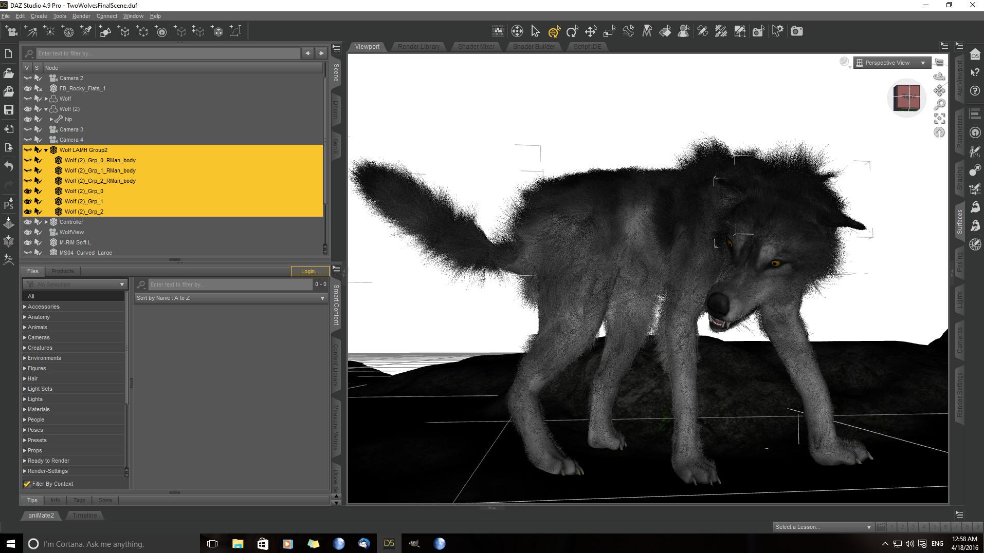

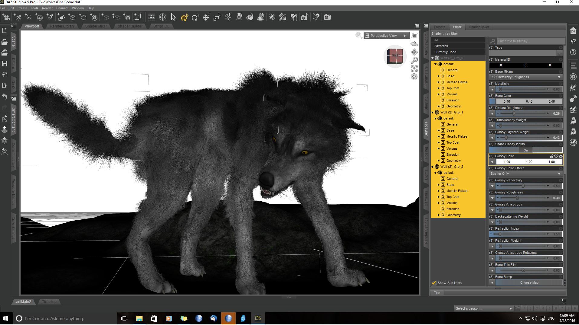

    So, I got distracted by non DS related stuff and didn't get back into it until late.  Finally, I pulled up my saved .duf file a few minutes ago.  I've included a screen shot with the Scene Tab open and one with the Surface Tab open.  Assuming you know how to export the FiberHair in LAMH for use in Iray, go ahead and export the fur.  You'll end up with fur that Iray knows how to render.  If you don't already know how to do this, you can follow these simple steps:
    Load wolf (or any LAMH figure) into DS
    Position your wolf in a final pose.  Once you export the FiberHair, you can't change the pose.  Every time you move your figure's pose, the FiberHair will need to be exported again.
    Go to: Create> New 'look at my hair' Object from the file drop down and click on it.  That should bring up the LAMH workspace.
    Adjust fur how you wish.
    Click on the big blue button that says 'Export FiberHair'.  That should bring up a dialog box to get you started.  Just follow the instructions.  For the wolf, there are 3 FiberHair groups so there will be 3 dialog boxes that pop up as you need to export each FiberHair into an object.
    In your Scene Tab, you should now have both the original LAMH group and a new group.  You can hide the old LAMH group (the one that shows green in the viewport) as Iray doesn't know what to do with it.
    My screen shot shows that I've already hidden these files, the ones that end in _Rman_body.  The 3 groups that are not hidden are the ones we need to select for further steps. Added tip: For those who don't know this, if you highlight those last three fur groups that I have viewable in the screenshot and unparent them from the LAMH group, then DS will save them those fur groups and you won't have to repeat those steps the next time you open up your save file.  As long as your pose is set and you don't change it, you can parent these to the wolf and move it where you want in the scene.  You don't have to go back into LAMH to export the fur again.  If you leave those fiberhair groups inside the LAMH group, they will disappear when you save your file and not be there when you open it again.
    The new Hair group is the one you'll be working with when you change Surface settings as described below.
    ** I should note here that I'm using the paid version of LAMH.  I'm not sure what the exact steps are for exporting the FiberHair in the Free version, however, I do know it is possible from what I've read.  Alessandro does have a YouTube video detailing the steps involved and he explains how to accomplish this in both versions of LAMH which I'll post below.  I've linked that video here for you.  I should also state, here, that I have not been able to get the paid version of LAMH to attach as a tab inside DS.  It is one of those little things I keep meaning to investigate, but just haven't had time and using the separate LAMH program works so I haven't investigated further whether this is something I can do with my version of DS and the LAMH plugin.  It is on the ever growing list of things I need to figure out.
    Once you have the FiberHair exported, you will need to change the surface settings so the fur will render in Iray.  Select the 3 object groups of fur you exported so that they are all highlighted.
    Open your Surface Tab and highlight all of the fur groups that show up there.  You will then need to go under the Preset Tab inside the Surface Tab and find the Iray Uber Shader.
    Double click to hit the fur group with the Iray Uber Shader.
    Now you can change the surface settings by going back into Edit.  We are going to use most of the defaults.  The ones we will change are the following with the numbers to which you will change them.  If you have all of your hair groups highlighted the changes will occur in all hair groups.
    Wolf Surface Settings
    Base Color - 180; 180; 180
    Diffuse Roughness - 0.292308
    Glossy Layered Weight - 0.132308
    Glossy Roughness - 0.376540
    These are the settings I came up with to get the fur to look almost wet as if the wolves had already been in a tussle.  I didn't want the fur overly wet, just slightly damp looking.  Most of this was achieved with the Glossy Layered Weight and the Glossy Roughness.  The Base Color and the Diffuse Roughness help, but those settings are mostly to keep the fireflies that occur with the FiberHair in Iray to a minimum.
    I think I've covered the basic steps.  If I've missed something or anyone has questions, please ask.
    1914 x 1077 - 350K
    1914 x 1077 - 441K
    Post edited by Knittingmommy on

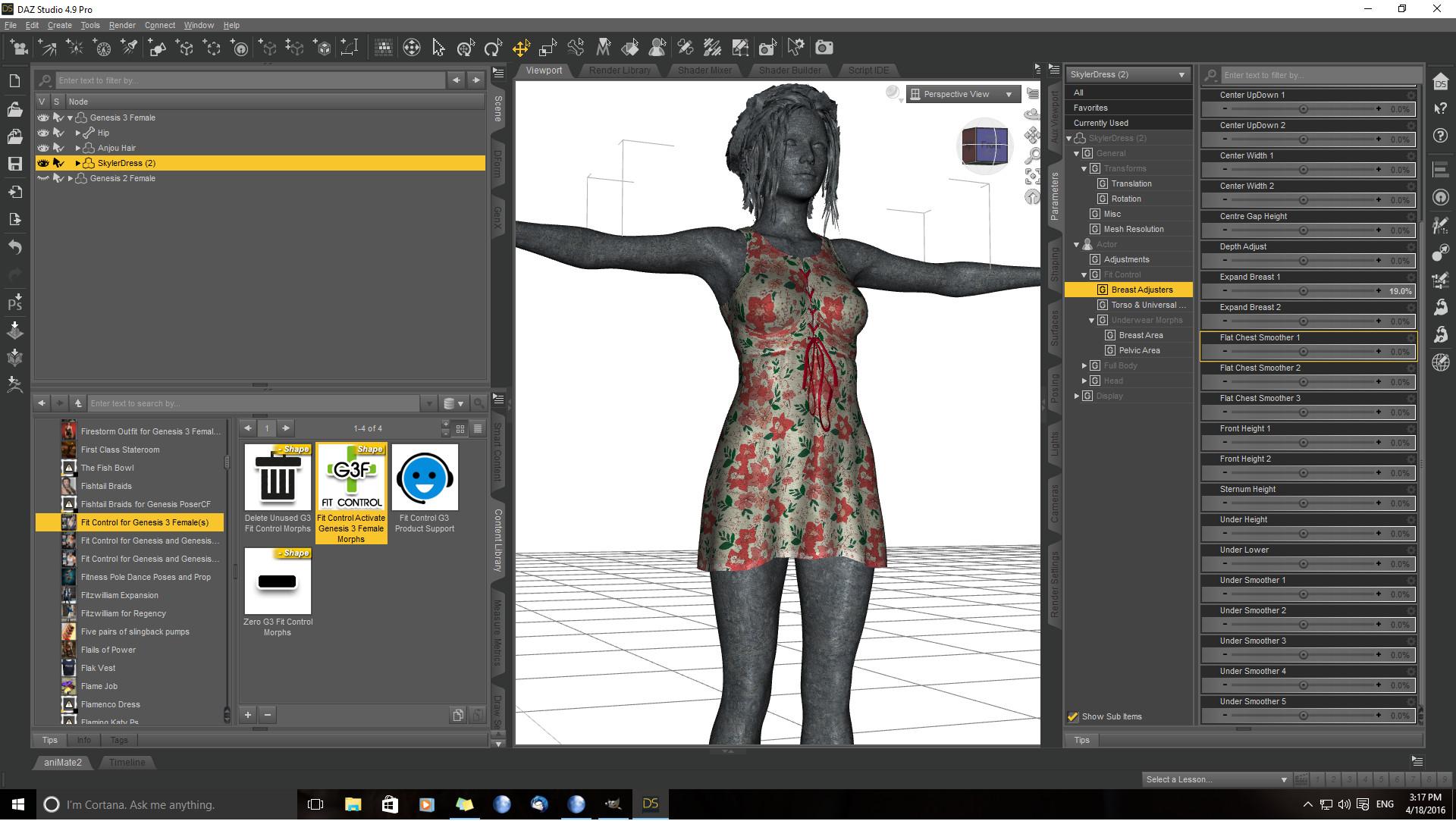

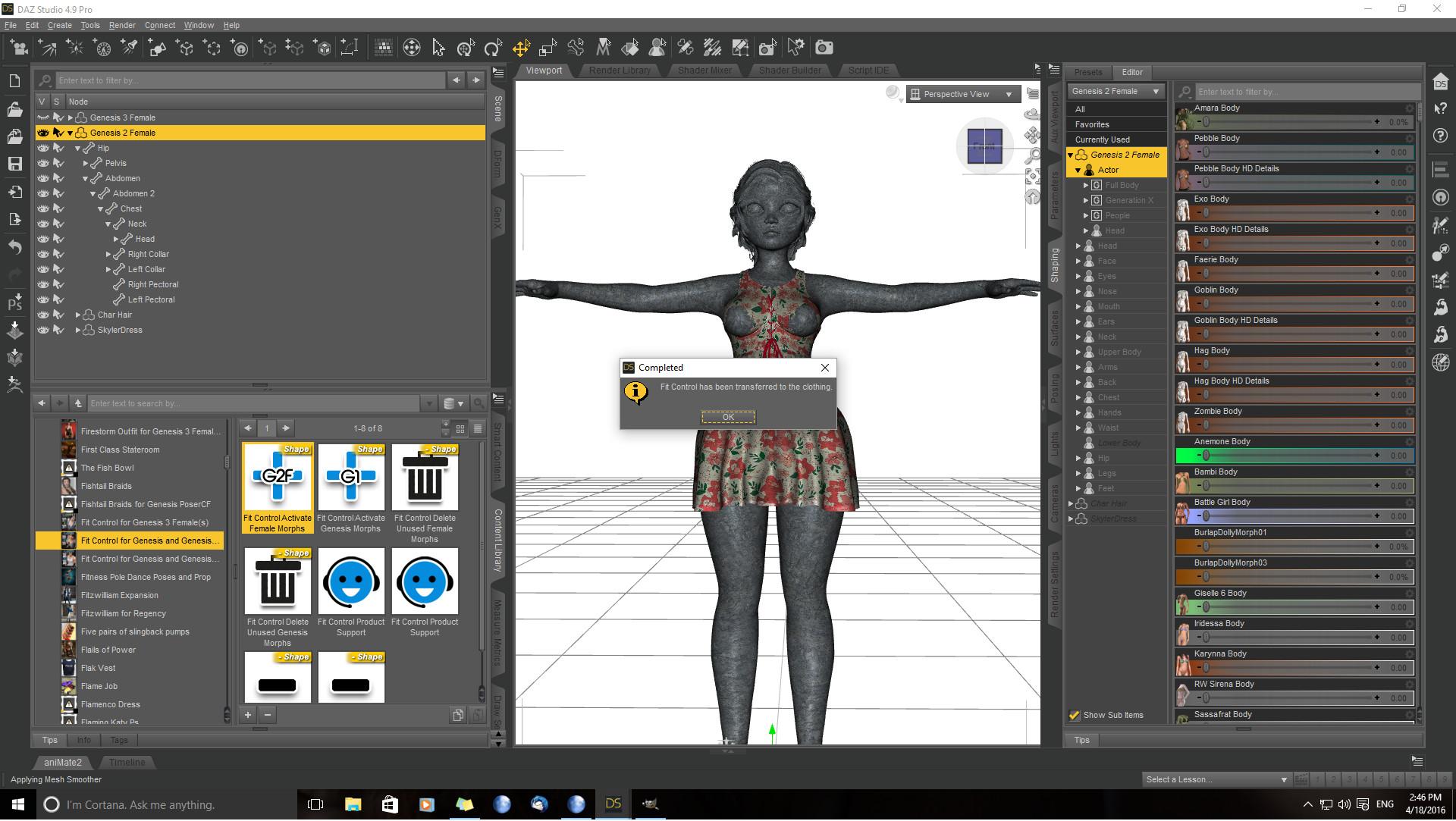

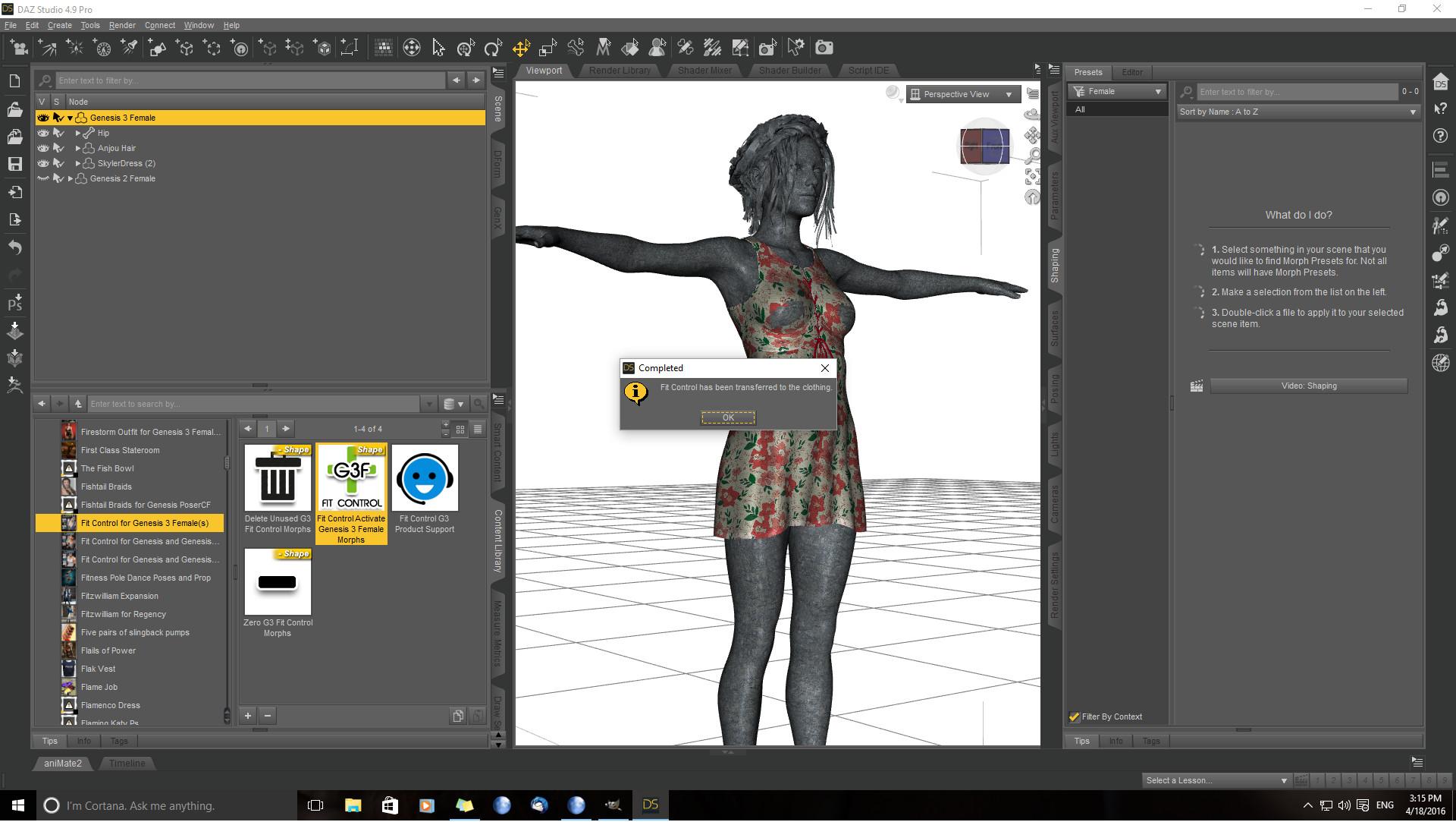

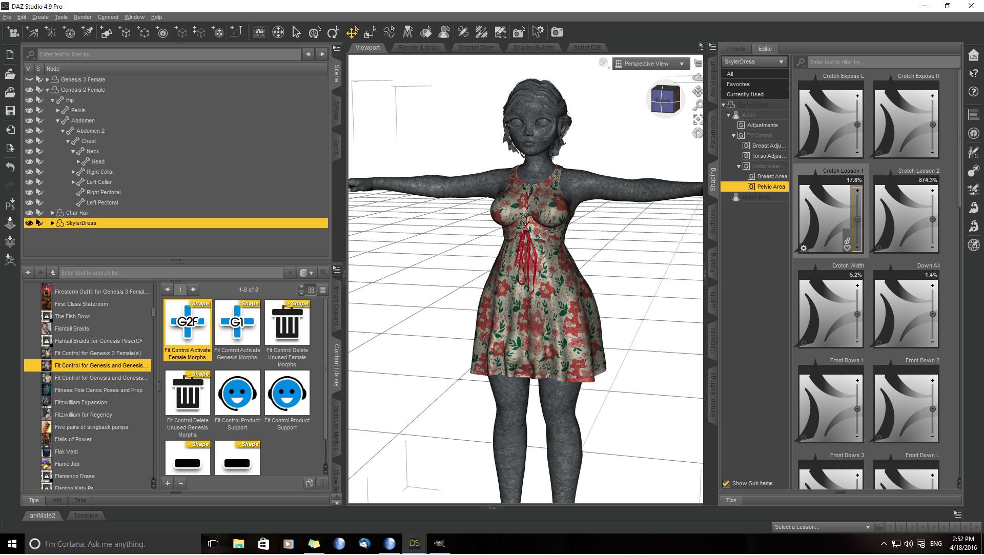

    So, I was asked earlier today if I had Fit Control for Genesis 3 by @Zev0 and if I would recommend it.  Well, my first thought was to immediately say, "Yes, I used it all the time and find it indispensable!"  I changed my mind about doing that, though, for one simple reason.  Everyone I've ever asked for advice from on a particular product usually either really likes a product or hates a product and they don't always tell you why.  I'm a firm believer that if I'm going to recommend something, I should actually be able to tell you why I like it and why I would recommend it.  Do I like Zev0s Fit products?  Yes!  Would I recommend the Fit products? Yes!  Now, I'm going to show you why I have these.
    Before I start I should mention that I couldn't remember how to get the nontextured figure to show up in the viewport.  I decided, in the interest of sticking to TOS, to turn the figure into a statue with a stone shader.  Hopefully, that was acceptable.
    I took one dress that I have and loaded it up as it is a perfect example of why people need a script like Fit Control.  It is the dress for G2F from the Skyler Clothing for Genesis 2 Female.  It is a great dress, but it was geared for the younger 3D generation and has practically no breast adjustments.  While it fits fairly well on most body types in the lower department, the breast is usually left just hanging out there.  It has some nice morph adjustments for movement, but little else.  I admit that I'm using the dress on a figure type that it wasn't geared to be used on, but then isn't that what a lot of us do?
    So, in the first screen shot, I've loaded the dress on LY Trini by Lyoness which has one of my favorite female body shapes.  The dress actually fits her fairly well in the bottom despite the fact that she is a little more well endowed than some of her G2F counterparts.  It isn't perfect, but we can work with it.  Her breasts are left completely exposed and there are no morphs to help us fix this.  So, I selected my G2F figure, found where Fit Control is located (I tend to use the Library Content tab for everything rather than Smart Content.)  I double clicked on the Fit Control Activate morphs (make sure you figure is selected in the Scene Tab and not the outfit).  When it is done, you select the dress in the Scene Tab, go over to the Parameters Tab select >Actor and you should see a whole bunch of new morphs for the dress that weren't there before.  Then it is a simple matter of playing with all of the morphs and getting the look you want.
    With this dress on G2F, I not only fixed the breast, but also played with the underwear morphs to fix the indentation at the groin area so it wasn't quite as noticeable and lengthened the dress.
    To keep this fair, I used the same dress on the G3F figure even though there is a version of the dress specifically for G3F.  Realistically, not all of us are investing in G3F clothing and we have a lot of G2F clothing we would like to fit onto G3F.  Surprisingly enough, the dress fits G3F better in the lower section than it does on the Trini body type.  I admit I left G3F at default since she was coming in with a dress one generation behind her.
    The breast still has issues, again this is mostly because the dress wasn't designed to be used on a full figured girl, but a teen.  So, I did the same procedure and applied Fit Control for G3F this time and fixed the dress.
    Now, I'm going to show you why I use this on all outfits even if they technically fit a figure straight out of the box.  Most outfits have that shrink wrapped effect especially in the breast area.  With Fit Control that is easily fixed with a few slider adjustments.  The results of playing around with the sliders on G3F resulted in the following results.  They are small adjustments but they can have a dramatic effect on how an outfit fits.  As soon as they are finished, I'll post a rendered before and after of the last breast adjustment.
    1920 x 1083 - 436K
    1920 x 1083 - 413K
    1920 x 1083 - 344K
    1920 x 1083 - 420K
    1920 x 1083 - 453K

    @KA1  I would be interested in seeing the version done just in 3Delight before you combined the two layers.
    No problem:
    800 x 1200 - 1M

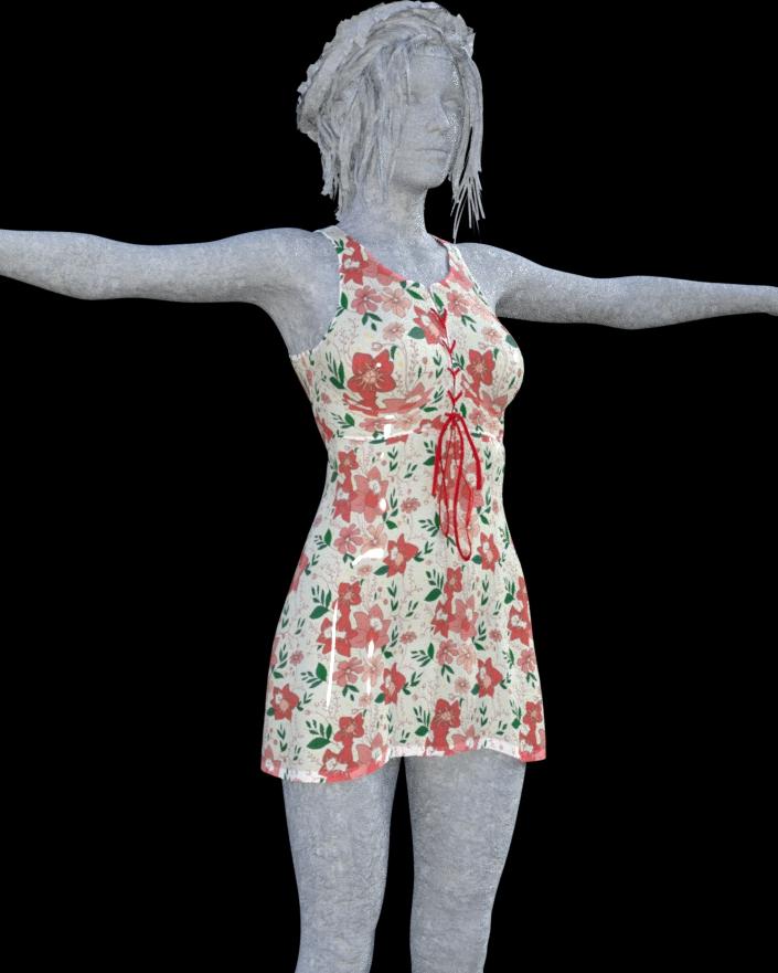

  • KnittingmommyKnittingmommy Posts: 8,191
    edited April 2016
    So, here are the two renders I did with our G3F model.
    This one is after the Fit Control morph to take care of covering the breast and nothing else.  It is okay and some would be perfectly happy to stop there and that's fine.
    Here is the one where I made a few more subtle adjustments to decrease the amount of shrink wrap effect between the breast cleavage.
    I could have taken it a little further to show what it would look like as if the model were wearing a full support bra and there was no dip between the breasts at all.  But, I like this effect and it looks more natural.  Again, it is a subtle difference that I notice and others might not.  It is, however, another reason why I think Zev0's products are so useful and why I'm glad he wrote them.  They make my work look so much more realistic!
    705 x 881 - 207K
    705 x 881 - 221K

    Forgive my jumping in here. I do see shadows on the floor. It appears you have two very strong lights that are 3/4 left and 3/4 right. It's likely they're cancelling each other out. Perhaps if you dropped the intensity (even as a test)?
