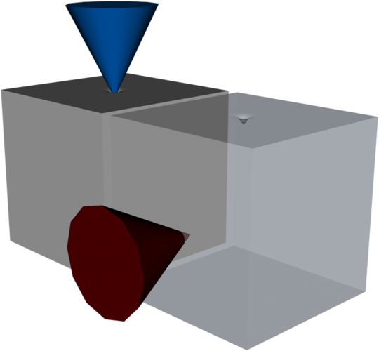

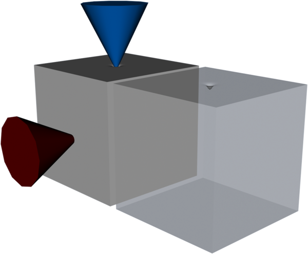

    I'm curious on how you would do this. For example I want the Cube to collide with both Cones (see attachment). I created a Geo-Shell from the Cube, applied Smoothing to the Geo-Shell, and have it collide with the Red Cone. But nothing is happening.
    belovedalia's idea seems pretty good. I'm just curious to know if there's some built-in approach.
    Thanks!

  • JaderailJaderail Posts: 0
    It already had a collision with the first cone. But I was speaking in terms of clothing, I've never tried a primative.
  • OridionOridion Posts: 0
    I used primitives because they were easy to test. I assume smoothing and collisions still apply, do they not?
