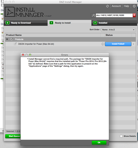

    whoops, I get this error when I install DSON - Install Manager cannot find a required path. The package for "DSON Importer for Poser (Mac 64-bit)" requires that the installed path for "Poser Pro 2014, Pro 2012 (64-bit)" be defined. Make sure that a path for this application is present on the "Applications" page of the "Settings" dialog, then try again.
    Did you install "DSON Importer for Poser"?
    Poser updates are here: http://my.smithmicro.com/poser-pro-2014-updates.html
  • fixmypcmikefixmypcmike Posts: 19,740
    Poser Pro 2012 updates are here: http://my.smithmicro.com/poser-pro-2012-updates.html
    Make sure you have the path to the Poser application listed in DIM Settings > Applications, then install DSON Importer (64-bit) with DIM.

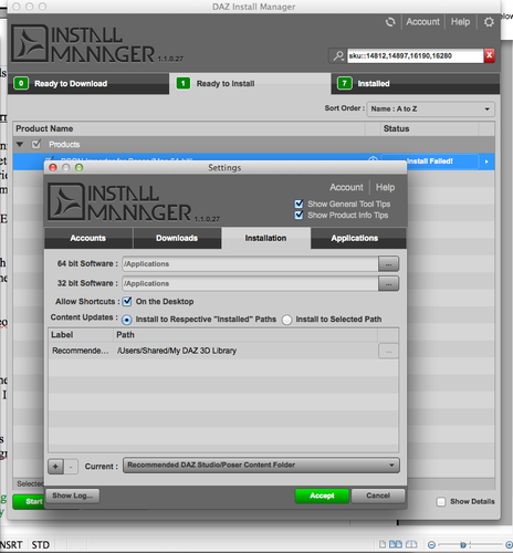

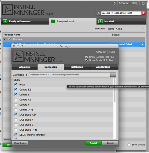

    In DIM, click the gear (Settings) icon in the upper right, then click on the Settings tab, and post a screenshot.
  • edited December 1969
    Okay - here you are, there are three.
    773 x 792 - 106K
    785 x 845 - 116K
    780 x 834 - 106K
    On the Settings dialog click on the Applications tab, the last one. Then click the '+' sign in the lower left to add an entry. Select Poser, the version and bit-depth, and enter the path (which should be something like /Applications/Smith Micro/PoserPro 2012). Then you should be able to install DSON Importer.
