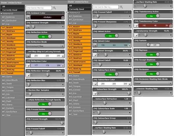

I thought I would mention that HSS is upgradable to ubershader. It needs to be done in the text file however. I know there is a better explanation somewhere, but my notes say -
Advanced surface shaders (hss,uber1,uber2) don't inherently lengthen render time. The added render times come from SSS, translucence but that is fairly minimal in 4.5 based on my recent render times testing shaders that use sss and translucence. Things like raytraced reflection add render time with even the basic DAZ shader. Other things like blurred reflection will dramatically increase render times as well.

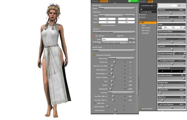

But...they are both on, by default...and if MRTD is set to 0, then you may not get the expected results...a starting point of 2 should be fine and 4 should be high enough for most cases.

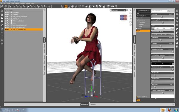

I think UE2 uses raytracing for everything except AO (No Raytracing). Or at least that's my impression from the docs...

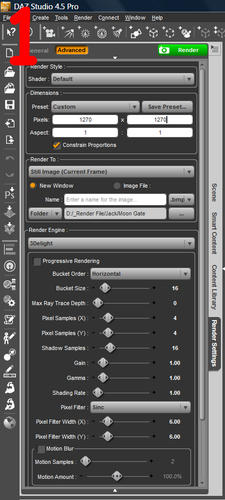

I did take it up to 8, just to see if my fishbowl benefited from it...but when it was going on 20 mins and the spot render was only half done, I decided that maybe it didn't need to be THAT high...
You could be right about UE2 but I see no change from 0 to 1 whne using Occulssion with soft shadows. I will go away and confirm all this for us.
I remember reading something about that in the 3Delight docs...but can't find it. It was something to the effect that 0 actually equals OFF...because you need at least 1 bounce for it to work.

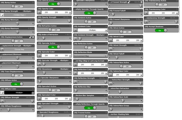

Actually it does increase render times. Anything that the computer is having to do more complex calculation times takes longer because it has to "think" think about it. Refraction is how the light waves bend through a material so that has to be calculate. SSS is the way light bounces around inside an object so it also requires extra calculations. Translucence is light passing through an object. In general it doesn't increase render times dramatically. The same for adding vevlet. It adds very minor calculation time because it isn't as complex to render. Fresnel is another that will add some render time. It calculates a sort of gloss/reflection based on angle (very simplified explanation). Of all of those refraction and reflection are the ones that seem to add the most time to renders because the computer has to do more calculations to sort out what should be showing. How much time they add depends on how high you have the settings. A reflection setting of 5 will hardly raise render time at all where 100 will add a noticeable amount of time. How much time refraction will add depends on how much your seeing behind/through the object as well as how high the refraction setting is.
I've spent the last couple of weeks working on shader sets that have a fair bit of SSS and translucence. Those setting render rapidly in studio 4.5. A few have minor reflection settings and often I don't notice an increase in render time. I tried a few with blurred reflection and that drove my render times up like crazy so avoid setting that more than 2 or 3 unless it is absolutely necessary.
I start to get it now thank you, I was under the impression that only the fact I turn on the functions is what increasing the time.
so if I for say turn On all the functions that I need but keep them on low amount like 3 in number , I will not see much increasing in the render time from I understand you say.
Correct. Higher settings generally mean longer render times for anything the computer is going to have to spend extra time calculating. It doesn't do much "thinking" about a diffuse color for example or basic specularity but it will have to do a great deal of thinking if there is a raytraced reflection at 100 and 30 objects that will be reflected by the material.

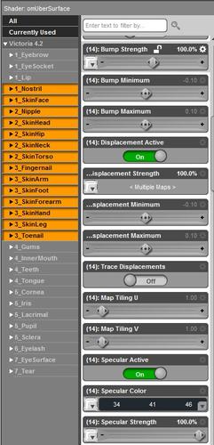

Help me to understand something about bump maps
does the bump map control the little dots I see on the model skin which to my opinion make it looks more real ?
and if so If I set it to a higher value I will see increase in the amount of this dots ?
hope someone here can understand what I mean
thanks in advance
Yes those are caused by the bump map. Raising the value will make them more apparent. Sometimes doing that adds more realism and sometimes it makes the skin look like sandpaper. It depends on how close or far away the camera is and how good the bump map is.
