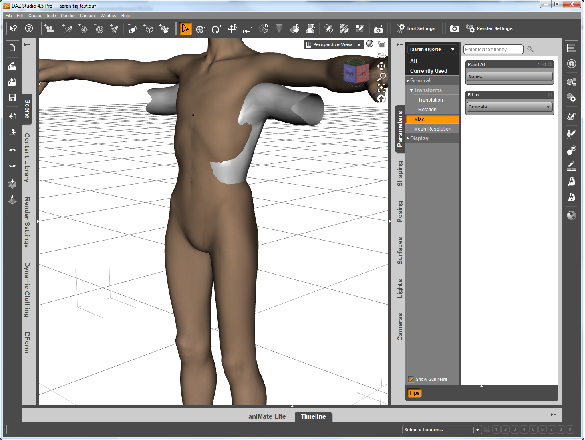

I made a basic shirt for gen in carrara and imported it into Daz and trying to use the Transfer Utility use. As you can see in these two images, it loads on the gen figure but when I use the Transfer Utility following the directions as http://docs.daz3d.com/doku.php/public/software/dazstudio/4/userguide/creating_content/rigging/tutorials/transfer_utility/start#import_modeled_clothing
My shirt moves to the middle of gen. What am I doing wrong?

    I’m back and I can’t repeat getting the shirt to fit genesis. I made the shirt in Carrara using genesis model. I exported the shirt as an object. Open daz and genesis then to go assets and create clothing and the shirt ends up in the middle just like in the first posting pictures. What am I doing wrong?

  • Richard HaseltineRichard Haseltine Posts: 112,275
    The problem is that the shirt is modelled to fit a morphed figure, in most cases, or has been moved and scaled to fit the base figure. The Transfer utility treats the zeroed mesh as being for the zeroed Genesis by default. You can select a shape in Source shape, and then in the expanded options check Reverse Source Shape from target, to rig clothing being made for a morphed Genesis; if you have to adjust your OBJ in DS to fit the zeroed Genesis then you need to export the modified OBJ and import that before running the Transfer Utility, to freeze the modifications.
