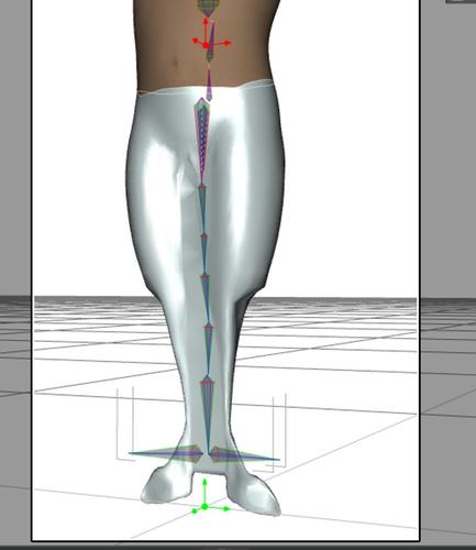

    OOPs - an unexpected outcome.
    When I had the tail fitted and conformed as clothing, it took on the shape of the thighs and the part below the thighs flattened out snf the flukes distorted. I expected that, as it would be trying to conform to competing bone influences.
    After giving the tail its own rigging and getting rid of all other influences, I expected it would go back to the original shape - but no. It is still conforming to non-existent thighs and the center part looks like the air has been sucked out of it. It deforms beautifully otherwise and I have checked that it does not react at all to rotations of the Genesis rigging, which is what I want..
    Any ideas on how to re-inflate the tail?

  • Fixme12Fixme12 Posts: 589
    edited October 2012
    I would discuss this with the daz developers, to see if this is possible to do or not?
    Or else make this a future request as some morphing between skeleton sounds useful in this case the Mermaidtail.
    i still would like to see the genesis legs+feet morphing to tail and have a tail control rig available.
    Post edited by Fixme12 on
  • RoygeeRoygee Posts: 2,247
    Thanks - looks like conforming clothing is the wrong option for this. I'll try making the tail as a character and parenting it, see how that goes.

  • Richard HaseltineRichard Haseltine Posts: 111,852
    Is this with the figure unmorphed, or after applying a morph? If it's after applying a morph, and you didn't supply your own, then the auto-generated morph may give undesirable results - the fix is to replace it with a custom morph that does only what you want. Also, have you applied a smoothing modifier to the tail?
    Are you asking about the mermaid tail or the mermaid i morphed in Sculptris?
    If about the tail, I fitted it to Genesis child - the tail has no morphs and I never applied any morphs after fitting.
    If about the morph I did in Sculptris, this was the Genesis female, exported as .obj, morphed in Sculptris without changing number of verts, imported as a morph target with morph loader pro.
    I was asking about the tail that developed odd deformations when fitted in DS - applying the child shape is applying a morph, and if you are relying on the auto-generated morph it may well account for the distortion; what happens if you fit the tail to a base Genesis?
    OK - I understand:)
    When I fit a scaled-up version of the tail to a base Genesis using the Transfer Utility, I get pretty much the same result, only less pronounced. When I apply it using an option I've only now discovered - simply "make clothing", I get an almost perfect result. Haven't had time to tweak the weights yet, but I'm sure this will get me where I want to be. It also morphs perfectly with all the Genesis shapes, so I can get a whole family out of this.
    Will just have to re-model the waist to fit the base figure nice and snug.
    So, I suppose, to answer my original question, it is possible to model clothing for the Genesis child, as long as it covers the body in the conventional sense, and not have a part hanging between the legs? That was the part which gave the trouble - from the knees down, with the shin and feet bones on either side exerting influence which I could not get rid of.
    Yes, or simply replace all of the lg bones with new bones though that might be tricky (a lot of influences to remove). However, it is odd that it would happen with a fully zeroed figure at all.
    Yes, I had replaced all the leg bones with a series of bones down the centre, removed all the influences. Checked that the influences were removed by rotating the Genesis legs - all was fine in that department, yet the original leg influences which had distorted the mesh remained. May have something to do with the templates - there is nothing for a long dress, for instance.
    Anyway, all's well that ends well. When I have the time, I'll test with a long loin-cloth, see what happens.
    Thank you all for all your help:)
