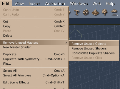

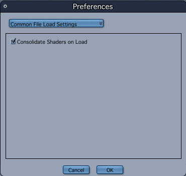

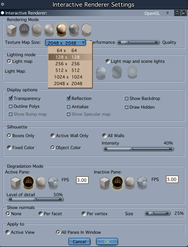

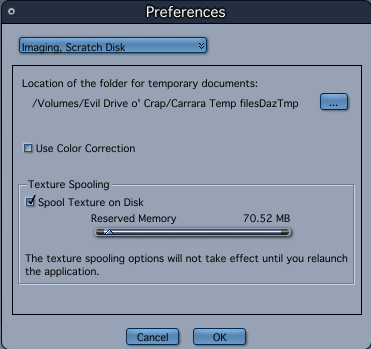

    The main thing I see regarding your system, is you need more RAM. Since it's relatively cheap I would add another two gigs if your system can accept it. The other thing I wonder about is your system maintenance. For instance, how full is your HD, has it been defragged? Are there a lot of programs or utilities running in the background?
    In the meantime there are some things you can do to lessen your system overhead. I would start by going to the preferences and lowering the texture spooling down as low as you can, then choose to consolidate duplicate textures on loading. When I set up a scene, one of the first things I do is go to the interactive render settings and lower the default texture display. Don't know if this helps to free up system RAM or just the GPU's RAM, but it does help prevent lagginess in the assembly room. The other important thing to do when you've been working on a scene for awhile, is to go the Edit menu and go to the Remove Unused Masters sub-menu and go through the options there.
    To help prevent issues while rendering, you could save your scene when you're done working on it, quit Carrara and reboot your computer to clear out your RAM. Then relaunch Carrara and render your scene either by opening your scene or rendering through the Batch Queue. Personally, I would render through the Batch Queue. Seems to save on resources. If you're rendering an animation, try rendering to an image sequence, that way, if you do get a crash or an error you only lose the frame that it occurred on.

    You might be right if all of the two gigs of RAM went to Carrara. Except it doesn't. You still have your OS and it's services that require a chunk of RAM.
    The reason I asked about the HD space was not because I didn't think it was a RAM issue, but because I thought it was a low RAM and swap disk issue. Since you have most of your HD free, it shouldn't be an issue.
    I also suggested quitting Carrara and restarting your computer because sometimes Carrara doesn't like to let go of it's RAM. Carrara 6 had a memory leak and I've seen posts on the old forum that suggested Carrara 7 had one for some people. I haven't had the issue, but I'm on a different platform and OS than you.

    There is a file called DazTMP. I'm not at my computer, so I can't tell you exactly where it is, but find it and clear it out often.
    Then, in your scene, remove ANYTHING that isn't visible. Any body part that is covered with clothing, hide it.
    Remember to remove any unused shaders
    Always use the batch renderer
    Use only one tile to render, not two.
    These tips have kept me rendering without incident for awhile.

    Anyway, thanks for the advices. Now I can make even the HQ renders. I don't know how the Texture map size affects the render quality, but I was quite happy with the quality that I already got.

    I don’t know how the Texture map size affects the render quality, the lower the quality of the image, the grainier the image would be, but rendered image quality has nothing to do with any memory errors. The Higher the resolution or size of the texture map, the more detail it can have,.. this also means that the image file size will be larger, which is where it effects Memory usage.
    For example:
    If you have an object using 10 shading domains, and each shader domain uses a different (high quality) texture map EG: 10 Mb per texture map, then you're using 100 mb in textures alone for that model. That's excluding holding the geometry in memory, and calculating the scene to render the image.
