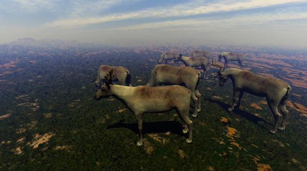

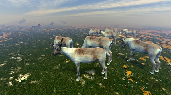

  • FishtalesFishtales Posts: 6,232
    I turned off LAA for Bryce and tried loading the scene. It crashed from the start and with each item removed it crashed at a different point, farther into the load, until it eventually loaded. All the wolves had to be removed from the scene only leaving the reindeer.
    Image 1 is the full scene with LAA enabled. Four is the maximum wolves adding another one crashes Bryce when trying to save the scene although it will render it.
    Image 2 is the scene that is reloaded into Bryce without Bryce crashing with LAA removed.
    I don't know how Bryce manages memory when saving scenes, it must load extra stuff into memory first, but it always crashes when saving a scene when the scene itself using 3 GB of memory. LAA does make a big difference when used with Bryce going by my findings.
    ( So if the scene is rendering and using approx. 3GB of memory then remove some items before saving or you will lose all your work :-) )
