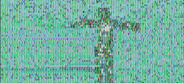

I already said I will no renew, but few days before my annual PA member renewal ,I decided to give DAZ studio a last try and installed DS4.5 to see the" improvements".
But what a mess!
Error message about suposed non existing files (but can be found manually), library items non avaliable, some that don't conform (elven hair) and awful auto conforming.
Even the render with 3 D Delight is impossible (see picture) and makes the program crashes .
I tried to uninstall and reinstall, but no changes
I use Window 7 64 bit (inte lcore i7 CPU ) Carte N vidia Quadro 400 updated.
I give up after nine years!
I can't use all my time to try to update, What about creatnig when you always have to fix something. All was nice till DS3.
I think DS is great, but please , make it usable..
I will not renew.

  • FSMCDesignsFSMCDesigns Posts: 12,859
    I will not renew.
    Why do people when they have a problem, yet the majority don't, have to blame the program first?
    No expert, but looks like a graphics driver issue.

    This is a bug in 3delight. It happens in Maya and others as well. It is linked to a bug in the pixelsamples directive. The issue has been fixed in the latest release of 3DL.
    If more info is required I can provide a workaround.

  • LledelineLledeline Posts: 28
    Thank you for the replies
    I'm at work but later i'll try to reload Ds4.5 and install it in another location.
    I'll check the video cart again et verify the drivers.
    If it doen't work I'll go back to DS4, but I'n not à ease with it and if some fomats have change ; i''l have have to let it a day.
    I use 3 d softwares as an hobby, and I'm not a computer technician.
    So better to invest in the other software that works like a charme in my computer.
    I'm more frustrated than in anger.

    I've redownload, réinstall in another location. Drivers updated. No changes in rendering.
    Back to DS4 and it renders well.

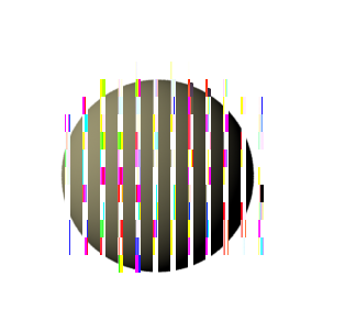

  • Kendall SearsKendall Sears Posts: 2,995
    This is from 3Delight standalone 10.0.50 Linux version. This is an example of the PixelSamples bug. As you will see, it has nothing to do with the Video Card.
    Kendall

  • StratDragonStratDragon Posts: 3,291
    Kendall
    yes, and oliver said it's fixed. Question now is will Daz apply this fix if it's the cause.
    Kendall
    But Oliver DIDN'T say what revision it is fixed in... The image I posted here was submitted on 8/28/2012. Here is part of a conversation I had with Oliver in a different thread:
    me: Is there any release schedule on the 3Delight 10.0.62 version? Specifically, for Linux?
    Oliver: 10.0.62 was released nearly a month ago. ...
    Which puts the version that D|S is using being released prior to the PixelSamples error submission.
    Kendall
