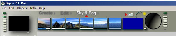

  • HoroHoro Posts: 11,689
    Click on Sky & Fog on the shelf as TheSavage64 said. Then click on the small cloud with the rainbow. This opens the Sky Lab which gives you control over the sky and you can set the sun's position numerically, if you prefer.

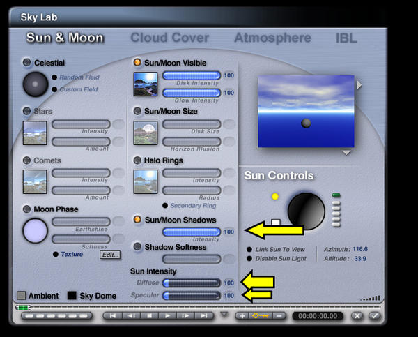

  • David BrinnenDavid Brinnen Posts: 3,136
    1 - click on the rainbow behind the cloud.
    2 - top arrow, global shadow intensity - how much light goes through solid objects - set at 100 I recommend.
    and "lower arrows" diffuse and specular settings - let you adjust the suns light output.
