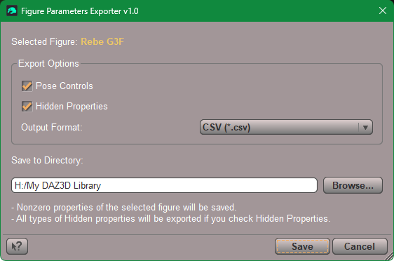

    You can try the attached script if you're interested ~~
    - As default, it exports non-zero shaping properties to csv or txt format file as per the selected figure.
    - Pose Controls and Hidden properties are set as options... in case you want to export them as well...
    - The script works in both DS 4.24 / DS 6.26
    Edit: Leave Pose Controls and Hidden properties unchecked, it will only export non-zero Modifier/Shape properties.

    Figure Parameters Exporter_v1.0.zip
