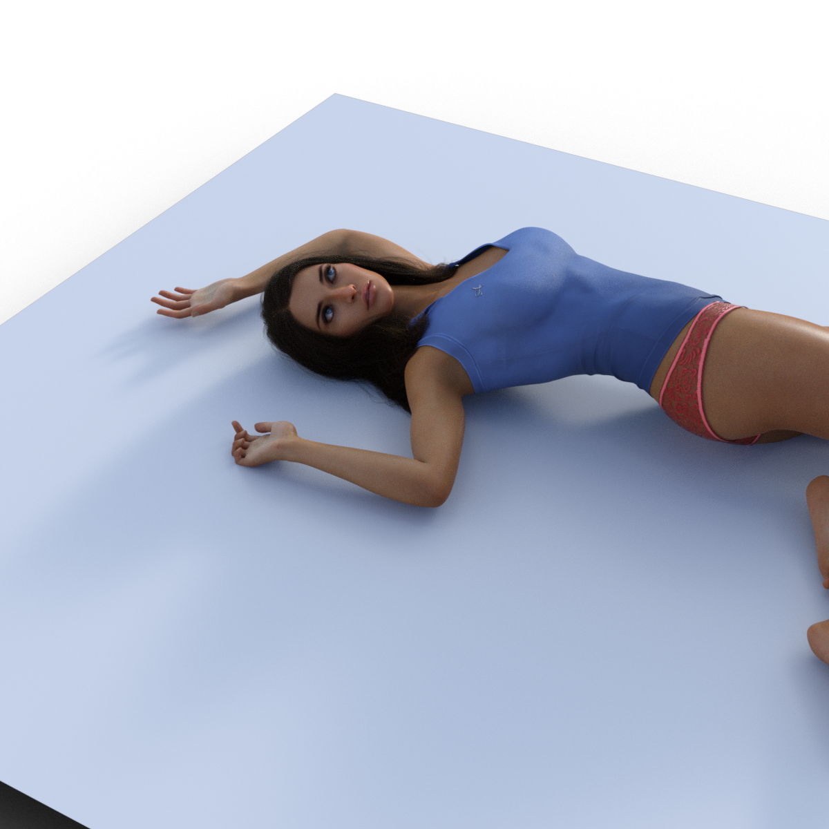

    I have the hair, though I can't remember using it before.
    Used timeline for 60 frames, 5 min and 40.
    Which pose does she have? Can something interfere. Your experience sounds like an upcoming explosion.
    1200 x 1200 - 2M

    Her arm is going through the hair. That's why I'm starting from a zero pose. It doesn't get to the point where her arm crosses the hair though when the sim pauses.
