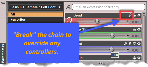

So a better way to "override the overrides" is to : in addition to locking the bones, also make them "override any controllers" by clicking the chain icon beside the lock icon ~

Edit: You also can use a Daz Script to do it on a selected Bone ~~ Below script sets Override as On.. with the selected Bone as well as its children bone ~
