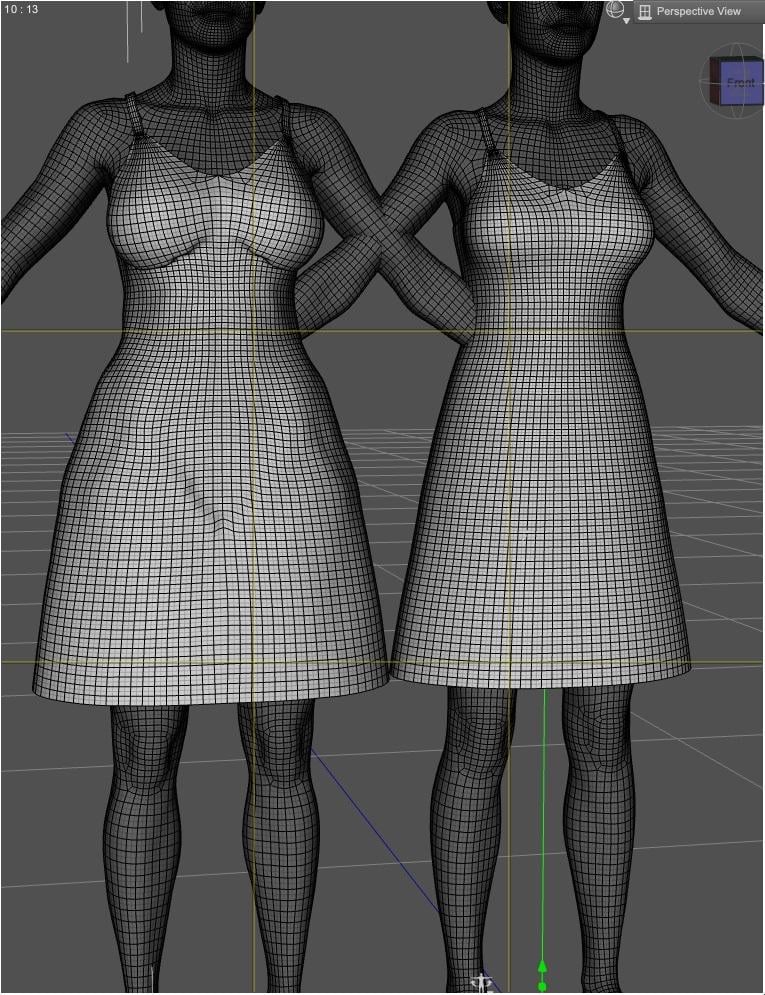

    The other way to deal with the problem is to create, for the clothes, a morph that will replace the one generated by auto-follow (which can be done by using Blender, Zbrush or other softwares like that). An example, on a simple dress:
    On the left, the dress worn by a character for which there is no such morph was created (smoothing is disabled to show the problem more), on the right, a character with a morph created.

    It's also possible to create such morph by using the Smoothing Modifier in Daz Studio, setting it to very high values (@crosswind has some explanations somewhere on the subject), but the downside is that you'll lose details you could retain creating it yourself, so on some clothes it may not be an option.
