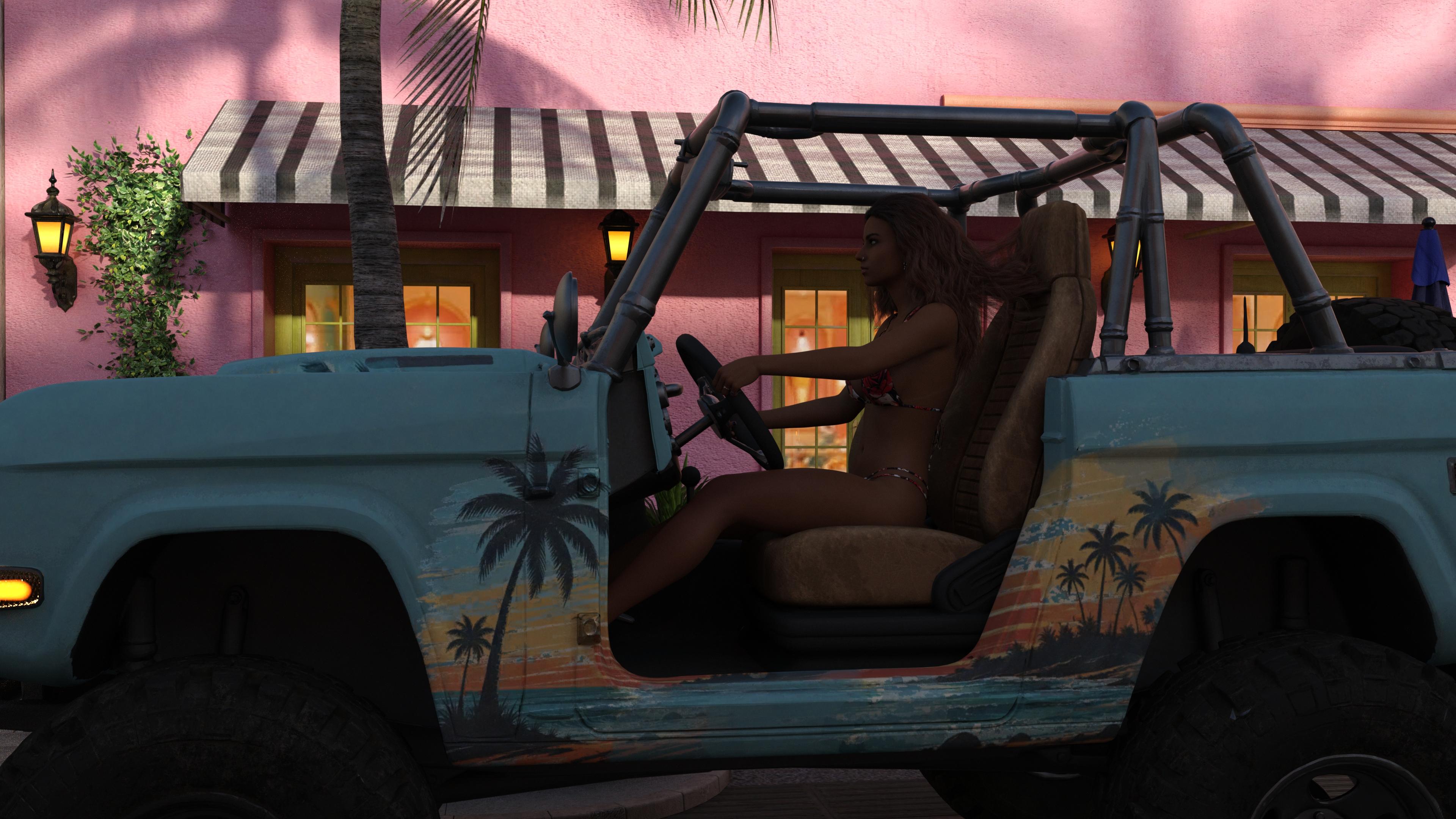

Purchased this and I like it. Just trying to figure out how to make it so the seat or steering wheel is adjustable, so the character can sit in the seat driving without being so far away from the upper back part of the seat.

    The simplest method would probably be a weight-mapped dForm, select all the seat polygons with the Geometry Editor, use the Node Weightmap Brush tool to fill with 100% (right-click>Weight Editing). invert the selection (right-click>Geometry Selection), and fill with 0%.

    According to the product description, there is a morph for the steering wheel, while more logycally it should have been rigged.
    There is nothing about the seat.
    So your only option for that is the rig or nake a morph. Might be duable with a dFormer, if the seat is one connected geometry without connection to the rest, which also would make it doable to rig without to much issues.
  • crosswindcrosswind Posts: 10,358
    1. Select the steering wheel, dial the pose property: Steering Wheel Rotate (ss1)
    2. For adjusting the seat, since the seats and the jeep body are welded in terms of geometry, rigging / dFormer / Mesh Grabber won't work well as expected.  A simple way can be:
       a) With Geometry Editor, hide all Surfaces exept: Jeep_ Seat. Ctrl ++ to select the left front seatl. Create a Selection Set for it > LeftSeat. Then Invert Selection, create another Selection Set > Body. (ss2)
       b) Duplicate the Jeep ! Select the Selection Set > Body, Delete Selected Polygons. Then rename the duplicated node as LeftSeat. Move it forward by changing its X Translate value. (ss3)

  • Sunkissed PapayasSunkissed Papayas Posts: 41
    edited September 17
       a) With Geometry Editor, hide all Surfaces exept: Jeep_ Seat. Ctrl ++ to select the left front seatl. Create a Selection Set for it > LeftSeat. Then Invert Selection, create another Selection Set > Body. (ss2)   b) Duplicate the Jeep ! Select the Selection Set > Body, Delete Selected Polygons. Then rename the duplicated node as LeftSeat. Move it forward by changing its X Translate value. (ss3)
    Thanks Crosswind, I'll have to try that. Haven't ever tried that typse of editing, since I'm still pretty new to DAZ still.
    I'd like to Thank everyone else for their responses and help with this.
