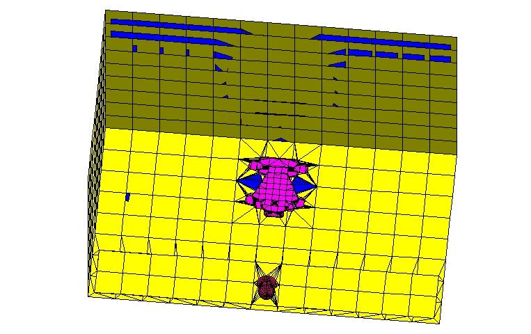

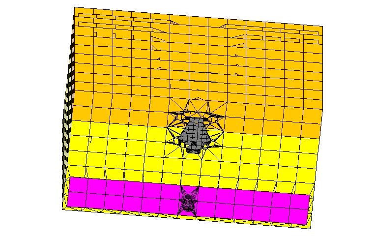

    I have not rigged a character from scratch, but I have rigged a little jewellery box prop, as shown below with the lid, drawer & catch open from the default position:
    In my modeller I created different groups, the body, the lid, the catch and the drawer. These are shown in different colours in my modeller below.
    The material zones have different boundaries from the groups and are coloured in my modeller differently, as below:
    The yellow is the main material, the blue is the interior, magenta is the goldish catch fitting and the darker magenta is the knob. You need to control both in the obj file imported into DS.
