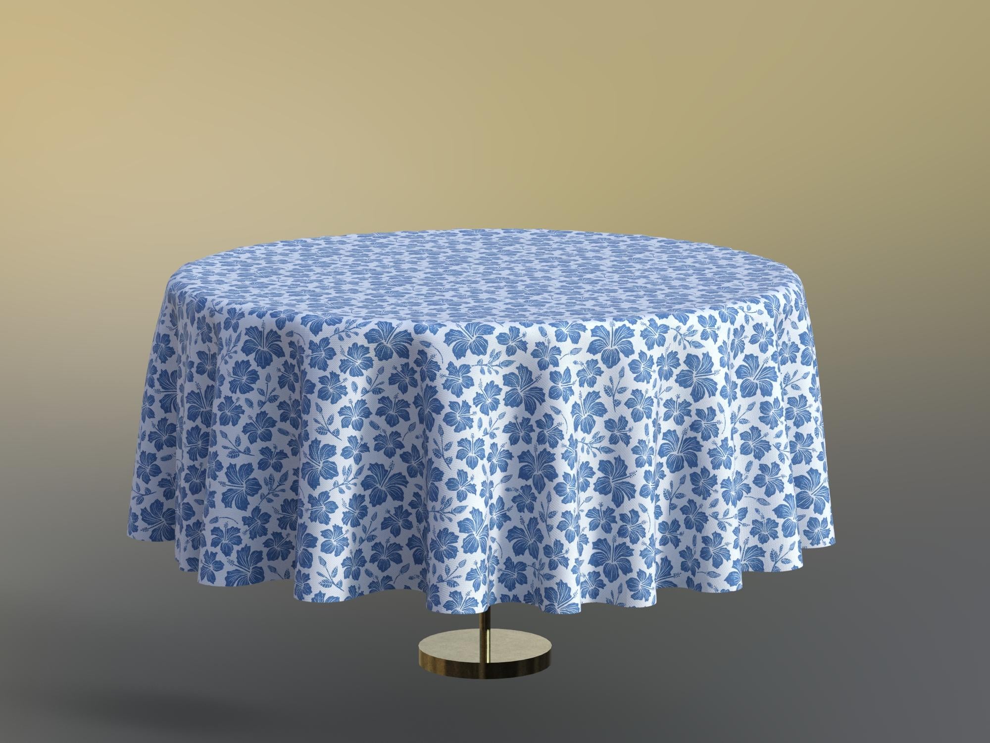

  • barbultbarbult Posts: 27,513
    edited September 12
    What part isn't working? What happened when you tried? Try a plane with a circular opacity map to get more even mesh quads for dForcing. You could use the Geometry Editor capability to rotate triangulation of selected polygons to improve draping smoothness.
    2000 x 1500 - 1M
    It is just a Daz primitive plane. I think I created it 2 or 3 Meters on a side and 100 divisions. I rotated the triangulation of two quadrants so all quadrant triangulation aimed toward a plane corner. There was a Daz tutorial on that technique when dForce was introduced. I can't add any images tonight. My computer is shut down and I have only my phone.
