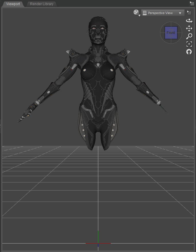

    thanks I think it kinda works but im having some difficulties only unhiding the parts that I want, like it unhides the entire body not just the hands, or it unhides everything but the hands

    Please put the Viewport in Smooth Shaded Drawstyle, or use the untextued DevLoad figure, if you need to show a nude.
    If using the Geometry Editore you need to select only the polygons you want hidden for the AutoHide group, and to see the effect you need to switch back to a regular tool (not Geometry Editor or any of the other content creation tools)

    In short, you just need to select the part you want to hide with Geometry Editor, like what I showed in the above thread, then set Auto Hide. However, this case with Aguara armor is a bit unique because the armor size is pretty slim, so the vendor had to hide all body parts.
    If you only want to show Hands, you'll get strange looking ~
    0) Fit Arm to None to show the hidden polygons, select lCollar, lShoulder and lForearm with Geometry Editor > Tool Settings, then press Ctrl + - for one time so as to unselect the polygons on forearm that the Arm doesn't cover. Set Auto-Hide. (ss 1)
    1) Fit Arm back to the figure (ss 2)
    Is it that you want ? If it is, we can make a morph to fix it but it'll change either the size 'n shape of the Arm or the shape of the figure's wrist / hand...
    Edit: The issue on the torso, legs, etc. will be the same... after reset up Auto-Hide for adjacent body part.... (ss 3)   In other words, this body kit was not designed for the scenario like you have, i.e. unhide partial body with this full kit fitted. You have to make more effort on it to get the expected result...
    Edit2: Another work around that we usually use is to resize each piece in this kit as per the body size of G8 Base figure (or your character), then create morph(s) on each of them (or re-rig each of them), then you can completely remove Auto-Hide settings...
