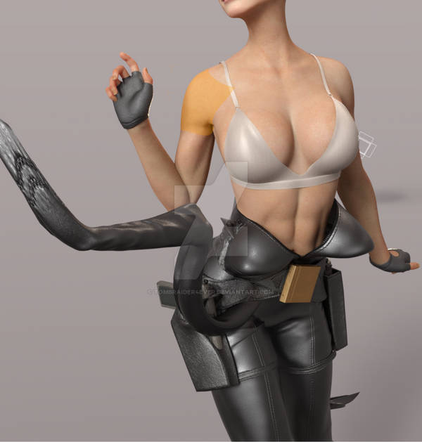

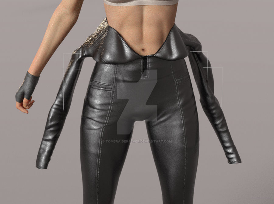

I bought this catsuit, https://www.daz3d.com/dforce-su-sexy-latex-for-genesis-9 mostly for the super cool morph, w the character w the catsuit top hanging around her waits, I use it on G8.1, by an autofit clone I bought here at daz, no issues with it.
I now know why there is no character wearing that morph on the promo, just the catsuit........ It  can't be used, if you pose her upper body in the smallest way - the arms, not fun having them in the starting pose..... if you pose the arms and the rest the upperbody part of the catsuit moves with it! So left w turing it into an obj I guess, with the pose, add the textures - can that be done?
It is the same on G9. I admire the artist behind the outfit, Sue Yee,   very much, one of my fav creators. BUT THIS....
Should have been warned by the fact that that pick w that morph has no body w it.... Who in their right mind makes poses - art  - w the arms and hands COMPLETELY IN THE T POSE - T POSE FOR GEN 8.1 or G9?
I don't want to return it, it looks DAMN AMAZING fully on her also, so want to keep itheart. But I WOULD LOVE IF that morp can be made usable somehow, it looks AMAZING, have it on my G8.1 Lara character, looks like cl Lara is dressing, diled in the morph not fully, so we can see her belt and guns still.. Please Sue Yee - can you make this morph function? OR make a new catsuit - the same look - but working, - an addon - WOULD TOTALLY BUY IT at once.
I should not have to open a ticket, why - this effects all that buys it. Could a mod report the outfit to Daz? if that can be done of course.
And it the meantime - what is the best way to use the catsuit w that morph? pose Lara's legs - copy the outfit model - convert to obj - can that be done without effecting the original model? is there any way at all to use the catsuit morph? it looks so good, was so much looking forward to make art w it.
Have used daz for years, I know how to put on an outfit and dial in a morph, can it be done wrongly? and it's the same on G9 - base g9.
Not sharing this to shame the artist, sharing this so she can make an update, I would totally buy an update if I have to.
Not accepting opening a ticket, this is not on my end... should effect all users resonably. If someone uses it perfectly I will open a ticket.
And the no body on the morph promo speaks volume I think.
Shes covered, does the cover need to be more to have the picks here? let me know and I will make the change and edit.
Looks this amazing w her unposedsad, I want to use it so bad, looks so good, cl Lara dressing for her adventurebroken heart.
outfit promo here, w no mannequin  w that morph promo -
It is the SAME w the morph DIALED IN FULLY. So that's not the issue.
 EDIT:
I realise now, thinking more about it, that the lack of model in that morph promo could be down to modestly. Still needs some words though - can't be used out of the box.
Post edited by tombraider4ever on
  • tombraider4evertombraider4ever Posts: 777
    edited August 18

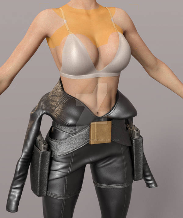

    Long post, so adding this here in a new post, morph dialed in fully here, arm just posed a little bit...
    Same on G9. Base G9. Morph fully dialed in and partly on g9.
    edited August 18
    Thanks, I will try that, did not think of that it might not work without dforce. I think it will still move when the animation moves her,why would that be different? But I will try now, and edit the posts if it works.
    It is simulating now, does not look good. When finished I will see if I had the default, alt click - dforce settings and try again if not.

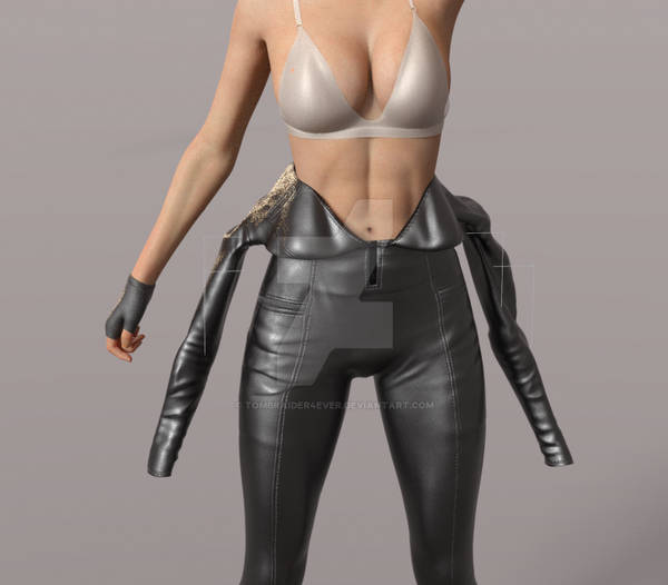

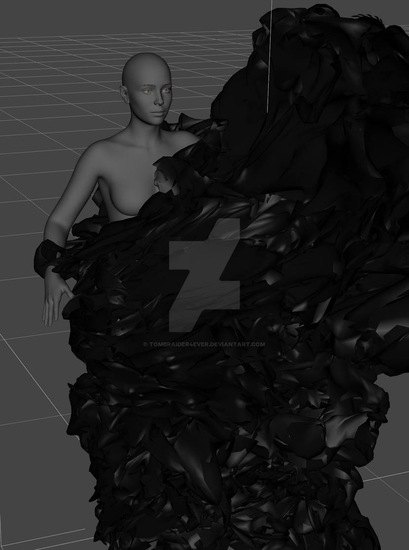

    Dforced it here, default settings  for everything in dforce, from memorized pose. Just posed the arms a little bit. The around her waist morph at about 81 %, full collides with itself.
    But I will try that also and show so it's clear that there is a bug. Have no reason to think that it's different on G9, tried it, not dforce, but moved g9 - moved the catsuit top. So WILL BE the same in dforce.
    the morph at 100 % here, just the arms posed a bit, all on default dforce settings, from memorized pose. No matter how you do it - dforce - pretty sure the arms WILL move when she does... It's like glued, but at a distance.
    Just the arms  posed.
    When I say memorized pose, from that, I mean from the unedited DEFAULT POSE.
    No time to test DFORCE IT on g9, but the arms bug - was THE SAME - NO CHANGE FOR THE BETTER AT ALL. so why would the dforce work by some magic on g9. The arms are glued at a distance no matter what I do.

  • Matt_CastleMatt_Castle Posts: 3,257
    And I DO find the morph kind of fraud, most people will think that the model can be posed in some way at all... can't be done...
    The short answer is "No, this cannot be made to function the way you are saying". As others have said, this is a pose that is supposed to be used in combination with simulation.
    The reason is that Daz Studio does not allow figures to have variable weight mapping. If part of the mesh is rigged to the arms, it will *always* follow the arms, even if you morph the outfit to change the sleeves to be near the waist; there's no way to change that without an entirely separate asset within the package.
    The only workaround is that during simulation, a fully dynamic object will ignore its bone weights, and thus be able to drape without following the arms. Note however that *after* simulation, its new shape will revert to following its rigging, so reposing after a simulation will often result in a mess.
    There is nothing Sue Yee can do about this; it's a limitation within the software.

    Thanks for the replyheart. So there is a way but my ys of using daz is not enough knowledge. It should say - around her waist morph - only for skilled users, involves ect .... HOw do I do what you say? is there a tutorial somewhere? and again - should NOT have to look up complicated tutorials to use an outfit morph. How do I make it ignore it's boneweights and then don't .

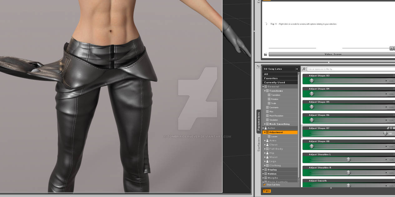

    See here a G9, DIALED IN FEMALE as I guess it's made for females, then just posed the arms, then dialed in the morph fully, so that's BASE G9,  BASE FEMALE, MORPH AT 100 - SHOULD WORK AT 100. I saw the arms move like they were still on her when simulated, then explosion. NO weird character, g9 base female, morph at 100, default dforce settings, from default.
    If complicated dforce settings was involved then the settings should have came w the outift. If it was possible on a posed character then why did the artist that made it not pose it on the model in the promo? we see no model ... someth is not right.
    I have no more time to test this now or reply but I would appreciate a tutorial on what you said - ignore bone weights when dforcing.
    And I was right in any case - should say that normal dforce is not possible w that morph. Have seen adds w that specified - use this and that dforce settings.
    If this is considered accepted for stuff sold at daz - if I have no right to complain then I'm sorry, feel free to delete the thread. As I said - love her outfitsheart, a big fanheart. Always.  Just wanted to be able to use the morph.

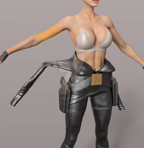

    I did try posing the the arms of the catsuit but that deforms them, all movement/rotations, that's one of the first things I tried, but it's kind of you to advice itheart.
    The other solution you said sounds interesting - so 2 catsuits, one hidden to her waist and other other hidden legs I guess, rename the bones of the ones w the upper part, if they can be hidden w bones, that is not always the case I find. No idea why, But I will try that. I hope Sue-Yee makes a seperate catsuit, exactly the same, but made to just be worn like that, would buy it in a heartbeatheart
    Regrettably, the only real options for this kind of feature are either to rely on dForce (and simulation is always at least somewhat finicky), or to not include them at all.
    (There is theoretically some very complicated set up that can be done, but it's not entirely reliable either, causes other side-effects, and you'd still really need to rely on dForce to some extent).
    It also becomes somewhat inviable for creators to include this stuff at all if they need to commit the effort to provide lengthy guides to the (frankly arcane) art of dForce.
    The big things I can say about dForce (which I would say I'm fairly good at):
    • Turn off all smoothing during the simulation. It (mostly) isn't actually used in the simulation (it's a constantly-recalculated modification layer on top of the "actual" geometry shape), bogs it down, and can disguise the mesh getting stuck in things. If you need to work from your smoothed initial shape, you need to look up the process of baking smoothing to a morph in order to actually be using that shape.
    • Watch out for mesh getting stretched or crushed. These are some of the most common causes of explosions.
    • Reducing bend and stretch stiffness (preferably as little as possible - start with jumps of like 0.1) can make a simulation much more stable.
    • Check the layer stack; it helps to have these ordered correctly. Note that they are per item, despite being listed per surface, so all surfaces on an item should be kept on the same layer for simplicity.
    • If the mesh is getting... "crinkly" and bumpy in dense areas after generating a lot of springs, shorten the collision offset.
  • crosswindcrosswind Posts: 10,276
    Firstly, Sue Yee never comes to Daz Forums. You can fill a support ticket with the option: Contact PA / Vendor if you'd like to ~~
    Actually you can easily make it yourself (as Richard mentioned...) by deleting the related bones and save a separate Wearable Preset with which you can use in the case you mentioned above.
    0) 1stly, download this free script: https://www.mikededes.com/delete-selected-bones/ Place it into your Daz Library\Scripts\ folder.
    1) Right-click on the auto-fitted Latex > Expand All.  Shift + Select from Abdomen Lower to Right Pectoral (screenshot 1)
    2) Dbl-click to run the script to delete selected bones. Wait for a while till it's finished.
    3) Dial the morph and save it as a Wearable Preset. Then always load the preset in the cases that you need the bodysuit with this morph (screenshot 2)
    We've done this on quite a few similar cases even if the vendors didn't provide separate presets for whatever reasons ~~ As for the explosion issue in simulation, I may give you optimal settings if needed but I have to reproduce the issue firstly ~~ It works so far so well.
    I don't recommend saving as a wearable preset first; edited geometries should always be saved as Prop/Figure first to create library references.
    *Then* you can save them into a wearable preset (even potentially saving over the preset you already made). Failure to do this embeds the geometry in every scene file it's used in, bloating scene files. It's better to store a single copy in your library that can be referenced.

    Photos here so you can see,  as I said, deleted the bones, saved as a figure, loaded, converted to dymaic surface or what it is called, then tried the default dforce settings, then all kinds, and made it heavier and w less air restiance. Same, tries to draping down, does so - then something forces it up again, down, then up.
    The first sc shot - before
    The second sc shot after.
    Not much difference.
    I made some dform morphs for her sleeves  to move them from her guns in the holsters, over them
    but it refuses to dforce no matter what, bounces up again. Guns holsters or not  - same.
    If possible I would love her in the holster belt the guns, and the catsuit top nicely draped over it
    I  guess I can get away w the arms being stiff, the latex, but I am a perfectionist when it comes to my art so I can't stand them sticking out like that.
    Now I am off to work w my art, I have bad mental health, feel I was born to make my Lara fanart and share it, feel it is the meaning of life itselflaugh, crazy but true for me. So I work on it 24/7 as it lifts me up above all the misery and it is a lifeline to me. And I want and need to make my art and share it until the ends of time and beyond that, but none of us has that time, and I certainly have not, being 54, overweight w diabetest type2 and worry freak. So I have to do the most w the time I DO have.
    I appologize for oversharingbroken heart, sorry, I am an open person and it is important to me that no one thinks I am rude for not answering right away if I get more replies I meanheart. I have no more time tonight,
    Will reply later tonight, early morning, or late night tomorrow. If I get more replies I mean. More attempts tomorrow.
    https://www.daz3d.com/forums/plugins/ckeditor/js/ckeditor/plugins/smiley/images/embarrassed_smile.png

    @tombraider4ever
    Some notes and tricks from me:
    0) The script can batch delete bones as deleting bones with Joint Editor is tedious. MikeD, the site owner, is one of the PAs in here... just feel free to register and download it. If you still didn't make it, I could share the script by crediting him.
    1) When saving a figure asset, as long as you save it with the Vendor Name of your own rather than overwrite the existing assets, the original version will be intact. If you're not gonna use this wearable in hundreds of scenes and aren't short of disk space, saving a Wearable Preset will just do~
    2) Still following the arm a bit is expected, as we just removed the weights by deleteting Bones but an arm pose will still trigger corrective morphs (pJCMs). You can Show Hidden Properties in Parameters pane, then zero the relevant pJCM properties on the bodysuit.
    3) I dbl-checked the bodysuit, found there're three Rigid Follow Nodes with zippers... one of them is under Spine 3. Suggest not AutoFit directly because it'll remove the Bone as well as the RFN. So, firstly load the G9 bodysuit into the scene, go to the bone : Spine 1, drag the RFN to the root node of the bodysuit, then AutoFit to G8F. After AutoFit, tweak the Transforms of three RFNs so as to move the zippers to the right position.
    As for the simulation with dForce, lower dynamic strength as well as some default settings may bring the item unstable movement in the simulation. I tweaked the settings on dynamic surfaces as well as simulation settings, pls try with the attached material preset.
    Change the settings as per the screenshot 1 in Simulation Settings, then load the material preset (just incl. simulation data) to the bodysuit ~ Finetune the settings as you wish ~ Good luck !
    2560 x 1392 - 1M
    2560 x 1392 - 1M
    duf
    duf
    Settings on Dynamic Surfaces.duf
    39K
    Post edited by crosswind on

    Edit - nevermind, found the rigid follower now  w the univeral toolsmiley. I love learning things in Daz, tech stuff, I  rarely do as I don't feel I have the time, just have time to create my art before I drop dead. So work work work 24/7. But learn things - sometimes I websearch and learn something, like you teaching me - LOVE itheart.
    I have a hard day today, a doctors appointment, a birthmark, uneven, just found, to look up. I have death anxiety every day, always fear the worst, not accepted the big D. So scared, sorry 4 word, shitless.
    This, concentrating on this, is just what I needheart. My art to the rescue as alwaysheart, and kind people online on my soc media pages, and here at my forum thread hereheart-
    Thank you so much for the reply and for trying to help meheart
    Trying to follow your tutorial now, moved the rigig follower things to the main model bone - the catsuit name , all 3, then autofitted, and then moved to their correct bones. Now I'm on moving them to the correct place, the zippers, first the left one, w that I remembered to to move the rigid
    thing instead of the zipper, done, then to the right one and now I forgot about the rigid thing and moved the right zipper instead, the rigid follower node is invisible, how do I move it to the correct place if I can't see it? I mean move them on the catsuít.
    Edit again:
    This artw of mine has nothing to do w this thread, working on a render w the catsuit, trying to have it working and see, but decided that I needed to manifest, hopefully, good news for my b mark checkup 10.15 today,  wsday late night for me, turned the d upside downt due to bad m heath.
    Sorry to be off topic, just feels that this manifesting is more powerful if I share it on more placesheart. It's on my insta and 2 bluesky acc also.
    Hope it is not too big for the forum, resized, the full artw is 2500 * 2160.
    The water marks are, in this day of horrible gen ai stealing, pointless to most people I guess. ME - I see it like this - you know that a thief, all of them, can force the lock to open the door or break a window to get in - you still lock the door, don't you?
    Breaks my broken heart to do, but if not I feel like I work for the f....s.
    End of offtopic, feel free to delete this off topic picture if necessary.

    As for moving RFN, just select the RFN node in Scene pane, you'll see the gizmo in Viewport, then move it near to the right position till you see it. Finetune its rotations.
  • crosswind said:
    Meow, c'est la vie lol ~ and nice artwork by the way !
    Thank you so much for the kind support and help also w this, means a lot to me!heart
    I did find the RFN, got a symbol of it by selecting the univeral tool, and moved into place - and done all you said - success laugh.
    Saved as a figure asset, might save as a wearable preset later, choose another name so should be ok.
    I got a nice recult w the pose I choose, and the sleeves sticking out a bit lower is most likely more realistic w that kind of catsuit, but I decided to hell w realismlaugh, I'm a perfectionist when it comes to my art, so made 1 morph to move the righ back out , neck part, out as it stuck to her back w the pose, and 1 morph for the lower right arm - was enough for that sleeve, to move it in, and 2 for the left sleeve, saved. Might only be usable in that pose, but if so then I will make more dform morphs, love that btw, a small tiny bit of 3d modelling, all I can do. My Lara ch was made using detailed face - head and body morphs, no characters, so my work but not actual blender modelling.
    This is how it looks now, sc shot fr the pre rendering mode, will work more on this, and deciding between loong loose hair, getting dressed, or braid, done her hair alreadyheart.
