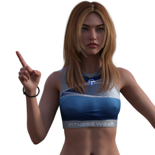

I am having a few issues with G9 wearing G8 clothes that I'd like to eliminate if possible.
I put A G9 character in G8 clothes, and the autofit seems to work fine, as below.
Looks as good as I can hope for. Then I save the file, re-open, and it's different. There's a bump in the top between her breasts as if a different projection morph is being used.

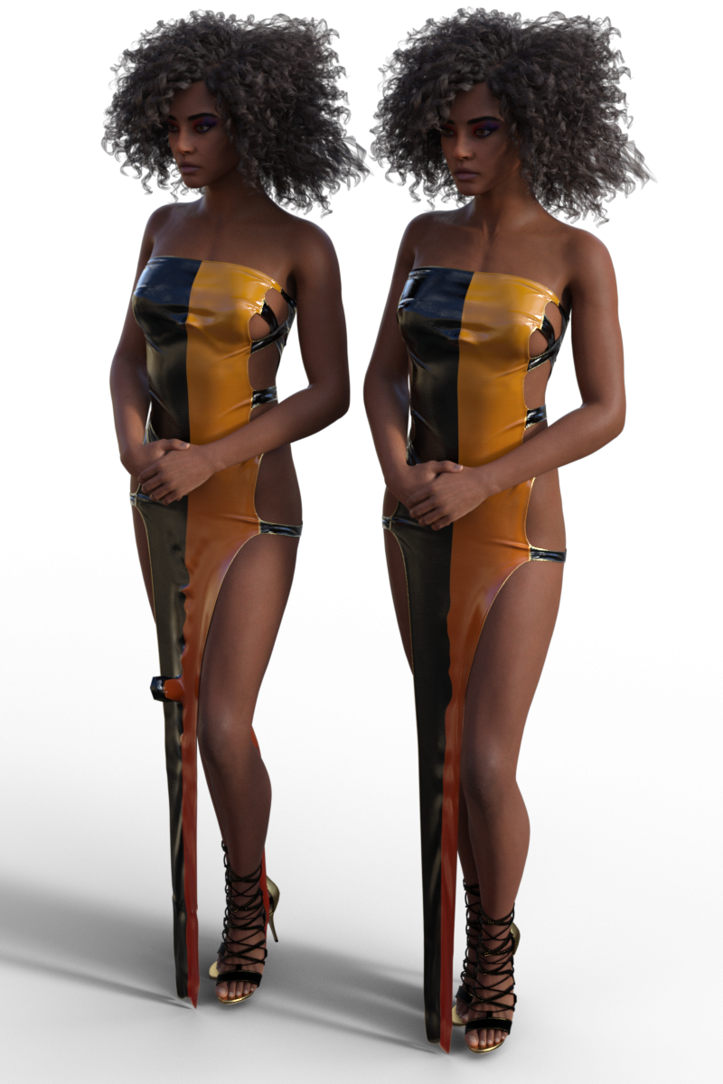

A more extreme case is with the clothing below. The dress is a G8 dress by Lilflame on MSO Dola. The dress on the right is freshly loaded and simulated. The character on the left is the character on the right saved as a scene subset and loaded into the scene without closing the scene. What on earth are the artefacts in the dress's skirt section?
Anyone have any ideas?

  • barbultbarbult Posts: 27,576
    DS4 or DS6 or both? Only these clothes, or all clothes?
  • richardandtracyrichardandtracy Posts: 8,132
    As you're aware, I don't often use G9, so I don't have a lot of experience with many different characters. I have noticed the problem with Lilflame clothes on Mousso characters. I really don't know if it's more widespread. I only use DS4. Having an offline machine, I can't get DS6, as I can only do a manual download, and DS6 has no manual download option. Thanks DAZ. Regards, Richard

  • garrett_3dgarrett_3d Posts: 985
    May sound daft, but it's not a chest/cleavage slider or something resetting between loadings? Is it actually the outfit that's changing, or the figure?
    edited August 10
    @Barbult, thanks for confirming that I'm not alone with this.
    @garrett_3d, The figure doesn't change as far as I can tell. In the case of MSO Kim (the first one) everything is left as default.
    Must admit it has been a bit of a pain with the top one as I'm going through creating a series of 130 partial poses in G8 & then converting to G9 and it's taking a significant time to get through the project. Each re-start of the scene file I've set up for cameras etc, I have to delete MSO Kim's top, re-load, autofit, adjust against pokethrough and then continue. It's really as if the chest projection morph is lost during the saving/re-load process in the case of MSO Kim.
    I really haven't the faintest idea what's going on with Dola's dress. Turning up smoothing actually makes the artefacts worse after saving.
    Regards,
    Richard
    Post edited by richardandtracy on
  • It's a known issue.
    The projection templates don't work 100% of the time, on any genesis figure, and if the rigging is just a bit out of template, it'll do weird stuff like this.
    What's happening is, it doesn't know exactly where to assign certain polygons, and just "Best guesses" which breaks the figure.
    The problem is evident in the pre-saved version of the Conflict dress by lil flame in richardandtracy's image. There's a noticeable zig zaging running down the skirt area.
    If you switch to "hidden line" it'll be really obvious that the center line polys are getting squashed and warped.
    When you save, the now broken asset, the changes in the vertices are saved and when reloaded it gets even worse.
    Unfortunately, there's only one way to sovle this problem, i'm aware of, and it's to rerig and reweight map the figure.
    The breast issue is exactly the same, it just doesn't know where to assign the polys.
  • crosswindcrosswind Posts: 10,314
    edited August 10
    As for the 1st case, I see the similar issue from time to time... because 1stly AutoFit naturally brings that kinda "projection shape" on some tight clothing like the top in OP's case, 2ndly, the true culprit is Smoothing Type > Base Shape Matching. Each time when you reload the scene or a Scene-Subset / Preset,  Smoothing Iteration is calculated based on Smoothing Type, i.e. Base Shape Matching option will bring you that "bumpier shape".
    A quick fix is to use Generic option as Smoothing Type... then you won't see the worse shape in the cleavage after reloading the scene.   An even better option for fixing it is to:
    1) Increase Smoothing Iteration to 4 ~ 5, export the top to OBJ with Base Resolution. Reset Smoothing Iteration.
    2) Figure > Geometery > Update Base Geometry... > Update Vertex Positions... by using the OBJ. (see ss1).
    edited August 10
    As for the 2nd dress, I don't have MSO Dola but I could reproduce the issue on Victoria 9 (as well as G9 Base... only the shape was not that bad ~) (ss2)
    I have to say the culprit is as same as the one in the first case. If you change Smoothing Type to Generic, the issue will be gone after you load the Scene Subset or the Scene. (ss3)
    Crosswind, switch to "Hidden line" then tell me this is a "smoothing" problem.
  • richardandtracy said:
    @DrunkMonkeyProductions, thanks. So it is an autofit issue and not really me seeing something unique. I wonder why DS sometimes 'forgets' about the projection morph?
    It's not "forgetting" anything, the original rigging of the asset was "non-standard".
    In the case of the COnflict dress, the center seciont is assigned to the "Pelvis" area of G8f, all the way to the floor.
    If you just load the dress, not fitted, and hover your mouse over it, you'll see it's really weirdly broken up in the skirt area.
    When autofit tries to assign the polygons, it just breaks the whole rig because ti can't follow the original rigging.
    DrunkMonkeyProductions said:
    ss1 is with no Smoothing at all after Auto Fit.
    ss2 is with Smoothing Type > Base Shape Match
    ss3 is with Smoothing Type > Generic.
    As I said before, 1stly Auto Fit naturally brings the imperfect projection shape on certain types of clothing (e.g. tight, loin, tutu, etc.),  improper way of Smoothing makes the shape worse which is the true culprit in Richard's case.
    But yes, if using tailor-made projection templates, people can get much better transfer results. I myself made a few unique templates for rigging clothing.
    edited August 10
    I have to say, at least in this case, neither the weight from Pelvis (ss1) nor the weight from shins (ss2) is the root cause... though the transferred weights are imperfect. Besides, Smoothing Brush on these weights doesn't remove the "iterated bump shape" ~~
    Edit: By the way, we usually get the job done by fixing FBM on the dress by using sculpting software > heavily Smoothing, or Update Base Geometry after rigging on a Genesis Base. Most of the experienced PAs do so, AFAIK.  That is the most optimal way, in most cases.
    The "root cause" is the auto fit projection broke the rigging and messed up the weight maps because of it. The exploding polygon is a result of the smoothing modifier being applied to a broken mesh.
    I've attached a couple images to show just how broken this is.
    The first image is the comparison of weight maps, the second is rigging.
    In both cases, the "Pelvis" is selected.
    edited August 10
    Well, first, Pelvis weight or its transferred rigging from Auto Fit or rerigging with Clones usually creates triangular shape in figure's crotch area rather than in between figure's thighs. Your screenshots just show the triangular issue.
    But the issue in Richard's OP and my test (i.e. that bumpy shape issue...) with the Dress does come from the "root cause" : a smoothed shape from Smoothing Type > Base Shape Matching, i.e. the matching shape is baked into the Dress before fitting / rigging ~
    I can prove it in another way as I further dived more into identifying the culprit ~ ~lol
    1) Load a V9. Load the dress into the scene without fitting. Alt Shift + G, Vertex Slection Mode, Select All.  Add the selected vertices to Rigidiy Gruop > Participants and References. In Rigidity Group Editor, add Modifier/Smoothing. (ss1)
    2) Edit > Figure > Shape > Clear Generated Morphs. The smoothed morph will be removed.
    3) Fit the dress to V9 (ss2 ~ ss3)
    4) Save the Scene or a Subset, reload them, you won't see that weird bump (ss4)
    5) Switch Smoothing Type to Generic, crank up Smoothing Iterations a bit (ss5)
    In general, with the above process by removing, you'll see no bump issue... though the dress still needs more fix.
    Edit: IMO, vendors should avoid rigging clothing with Smoothing Modifier + Base Shape Matching option.  Add Smoothing Modifier if really needed before saving Wearable Presets. Even if there was a poke-thru or imperfection, should've used Update Base Geometry with a smoothed or fixed mesh, then removed Smoothing Modifier before transfer rigging ~~
