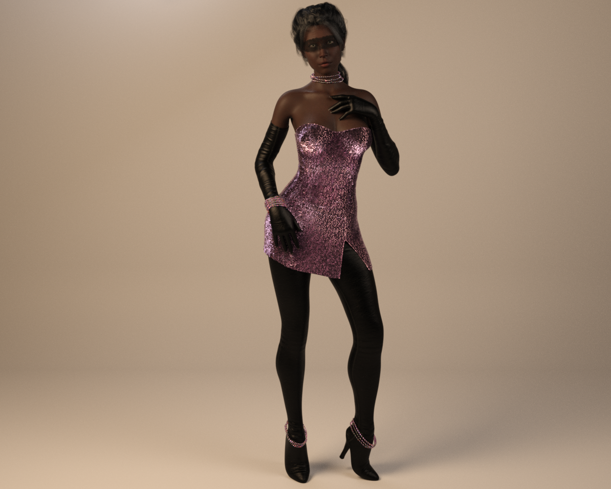

    Genesis 8 clothing will fit Genesis8.1, so there should only be 1 set.
    Here is what the clothing look like on Raven, with the faulty morphs removed. Autogenerated morphs instead of the (faulty) premade
    But please raise a ticket.
