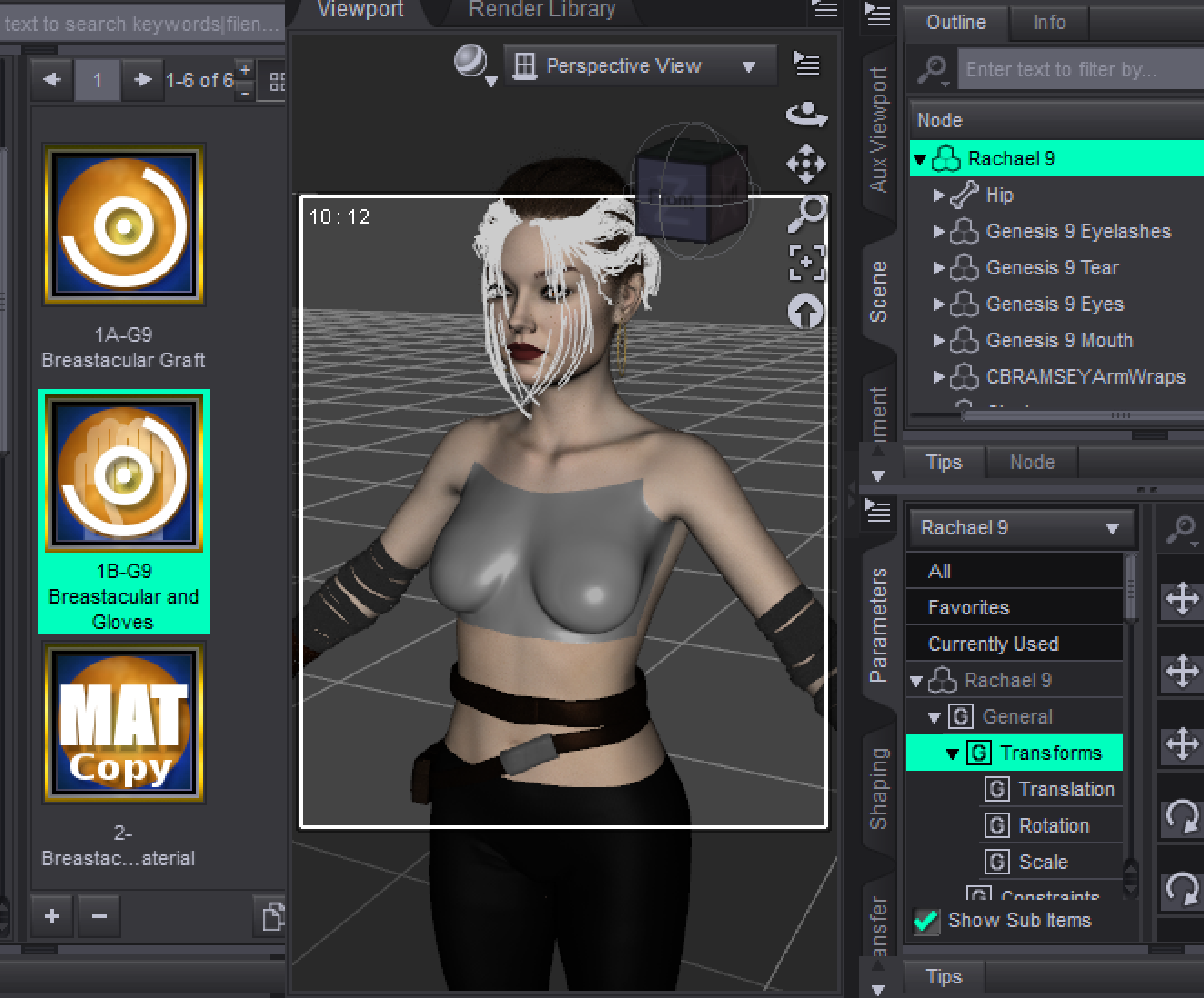

Hello,
I need some help because I can't seem to apply my character's skin texture to the Bresticular pack; do you know what might be wrong?

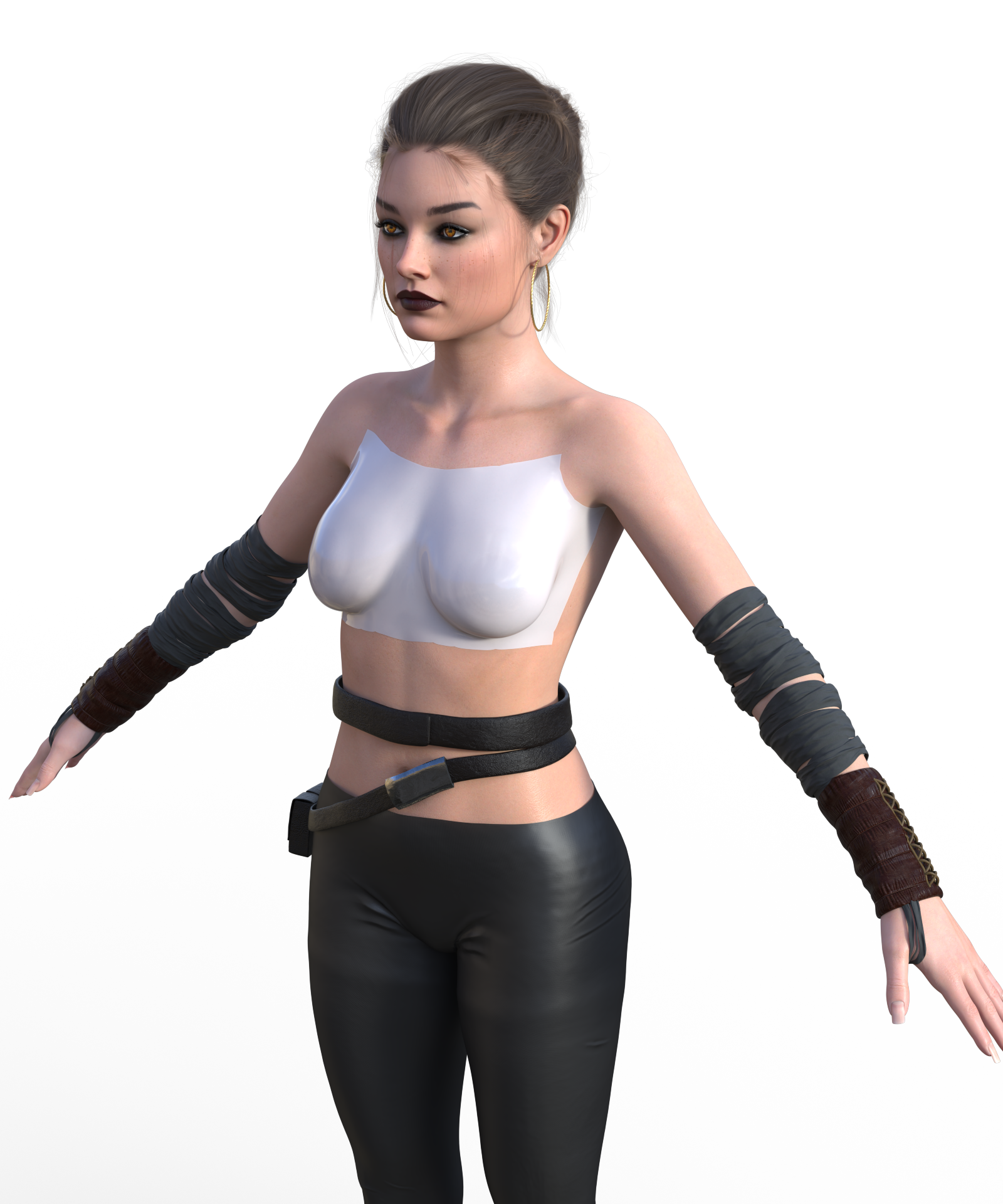

    Yes i has use the material copy, You can see the steps I took below.
    Before :
    After :
    With the material copy :
    After the render :
  • Richard HaseltineRichard Haseltine Posts: 111,992
    Do you have an alternative genital applied? Many of those add a shell.

    Yes i have only that :
    But I tried recreating the character with nothing equipped except the "bresticular," and it works. I think I'll just remake the character from scratch—I don't mind. Thanks anyway, though.
  • StellarStellar Posts: 49
    edited June 30
    edit : After remaking the character, the issue turned out to be eye makeup and the scar on the face that wasn't applying the skin texture to the added breasts.
    Post edited by Stellar on
  • felisfelis Posts: 6,632
    The eye makeup and scar are likely one or two geoshells.
  • crosswindcrosswind Posts: 10,356
    Breastacular is a geograft, the surfaces of a geograft are automatically created on all geoshells on the figure, so you either hide the graft areas by turning off shell Visibility... or correctly tweak the settings on their surfaces in Surfaces pane, e.g. set Cutout Opacity to 0 ~~
