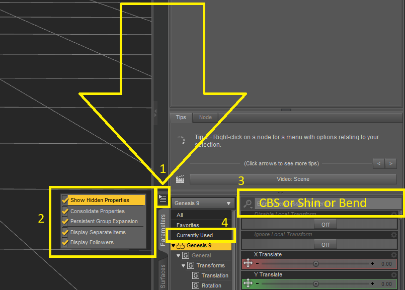

    You probably have a hidden rogue JCM that shouldn’t be enabled by default. To identify which morph is causing it, try the following:
    >Activate Show Hidden Properties
    >Load a new Genesis 9 figure, select the Left Shin, and set the bend value to 90.
    >Select the figure in the Scene pane.
    >With the figure selected, use the search bar to look for terms like “CBS”, “Shin”, or “Bend”, then switch the filter to Currently Used.
    Normally, you should only see the default morph body_cbs_shin_x90p_l active, but you’ll probably also find the rogue morph there as well (usually something with the character name plus shin_x90p...).

    Thanks. I'll give that a try. BTW - the image you posted doesn't show and has been replaced by a marker which reads "Content not viewable in your region". If the image was to illustrate something which could have helped me could you try reposting with the unviewable element removed? Not sure what it is because I cannot see the image :0)

    I uploaded the image to IMGUR which may be blocked in other regions, I'll try using another website.

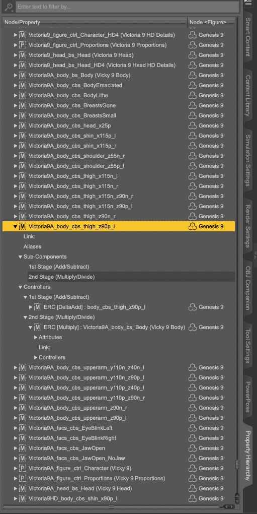

    Do you have the name of the problematic JCM ? And a screenshot of how it is set in the Property Hierachy?
    To open the Property Hierachy on that JCM, in the Parameters tab, switch to Edit Mode, then right click on the problematic JCM and select Show in Property Hierarchy.
    Example with a JCM from Vicky 9:
    The usual mistake is that the body morph of the character is not set as a 2nd Stage controller, but maybe it's another one.
