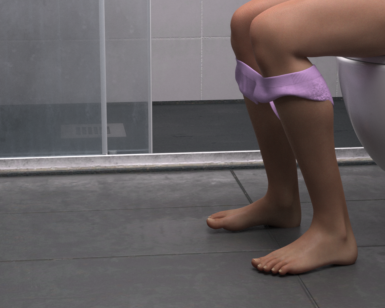

    Quick trial.
    Workflow:
    Posed the character (she is actually a G8F, but it doesn't matter).
    Find a pair of panties, that looked suitable, i.e. was welded and had a decent Geometry, so they could be simulated.
    Applied dForce modifier to panties, and lowered gravity.
    Positioned the panties, so they fitted the legs.
    Simulated current frame, and start from 0 pose to Off.
    1250 x 1000 - 2M
    Post edited by felis on

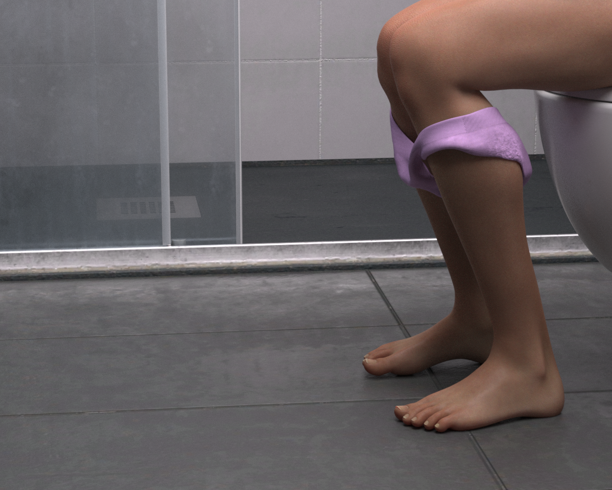

    If you want them more stretched you can use an animated playramge.
    1250 x 1000 - 2M

    If you refer to the last image, I made an animated simulation where the startpose was as in the first image, and at frame 20 had slided the legs a bit outwards, so the clothing would be stretched.

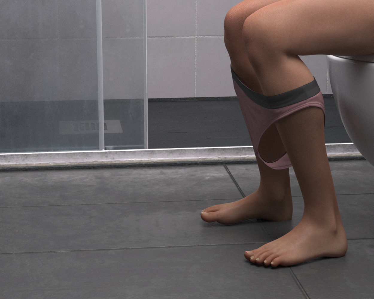

    This is with active lingeri.
    Startpose
    Rendered image
    What does your looks like before simulation?
    1250 x 1000 - 2M
    874 x 722 - 619K

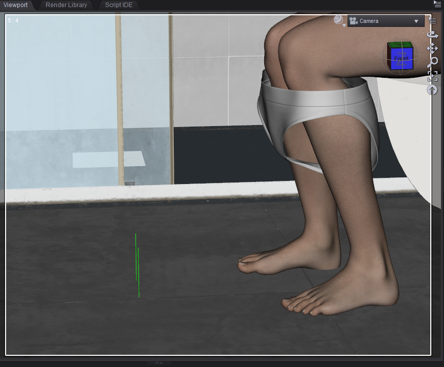

  • jodhan322jodhan322 Posts: 76
    edited May 13
    Mine doesn't end that way lol
    1200 x 1300 - 626K
    1200 x 1300 - 648K
    1200 x 1300 - 1M
    1200 x 1300 - 1M
    Post edited by jodhan322 on
  • felisfelis Posts: 6,656
    You could rotate the panties, so they are a little more straight on the legs. Now they are higher in back. I had rotated mine a bit.
    I also scaled the panties to 90%, as 3D type of pants don't have elasticity, but of course requires that they don't clip with legs.
    And if you want them stretshed, like in mine image, you must use animated timeline. The startpose is fine, but at frame 20 (assuming the default 30 frame range) you must pose the legs slightly outwards (thighs side-side), so they will drag the panties. (Too much can cause explosion).
