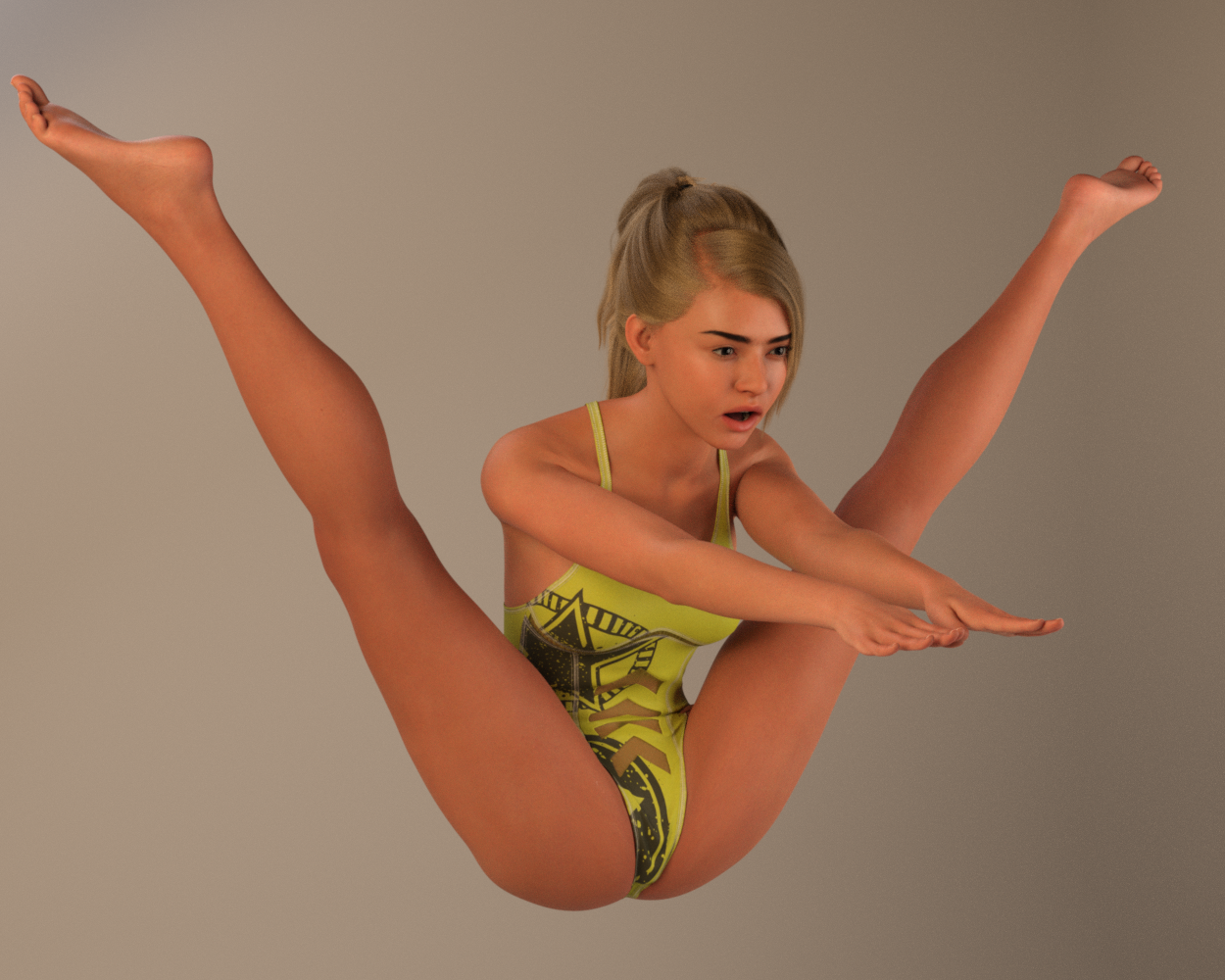

  • felisfelis Posts: 6,629
    edited May 9
    Too late cheeky
    This is what my version looks like. No limits broken.
    1250 x 1000 - 2M
    Post edited by felis on

    @felis In your pose, it is quite unnatural for the shoulders to stand straight when the arms are bent forward, normally the clavicles are bent up and forward too, especially for stretched moves.
    p.s. I noticed that in the crotch area G8 bends better, while G9 is somewhat harsh, indicating not optimal jcms. However the principle is the same.
