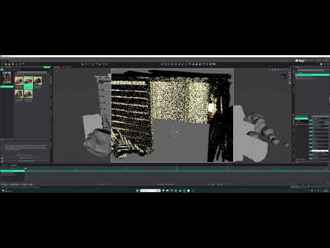

How can I git rid of noise in my render of indoor scenes? Is this casused by the lighting?
When my render is finished, on an indoor scene, I have noise instead of a smooth finish. What causes this, i[s it lighting] and how do I fix this so I get a smooth render?
  • merrygrannydemerrygrannyde Posts: 25
    OK this is the render,
    3000 x 3000 - 2M
  • Richard HaseltineRichard Haseltine Posts: 111,467
    Probably lack of lightyes, not quantity but rather having lights that can easily reach into the scene - the more you rely on light bouncing around to hit a surface the longer it will take to reach a settled value. As it is some pixels are showing areas that have hit a light beam several times and others are areas that have rarely if ever met a light beam, so the tonal value varies a lot.

    Thank you. I found a tutorial online that shows how to use the denoiser & it also said deleting stuff like unseen walls & props will help with the lighting. I'm trying that now so will see how it turns out

    Thank you for your help, I got it pretty good using what to do in DS & then I fixed it better in Paint Shop Pro
    The trouble with deleting walls etc. is that the results can look unnatural, depending on what you are aiming for. With rooms you generally want to use local lights (points, spots, and light-emitting objects) rather than distant lights or an HDRI environment.
  • ChezjuanChezjuan Posts: 547
    One thing you can also try, especially for scenes where you want it to be dark, is to go to render settings, select progressive render, then increase the Max Samples and Max Time sliders. This allows Iray to process more iterations whick will get rid of the noise without using denoisers. Depending on the render I sometimes find tha tthe denoiser (either internal or external) can make it look a little off.

    I would suggest to add a weak area light, could be a point light with geometry or my ever used emissive planes, and then increase Tone Mapping in Render Settings, to keep it dark.
