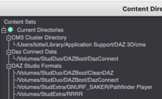

    (b) On the Content SSD, Named StudDuo ( because the old machine had a raid name DuoDisk, and when I got my MacStudio ( it was shortened to MacStud in some terminal software and I thought that was funny ), but the drive can be named anything, just make sure it is formatted Case Insensitive! I also put Downloads and Thumbnail on another drive, StudExtra.
    (c) On that drive I have A Folder named DazBoot, in which I have several folders, CleanDaz, ThirdParty, Tests etc, but lets focus on DazClean, where I install all content from Daz store. (The reason is to avoid bad 3rd party content corrupting the  Daz base files.)

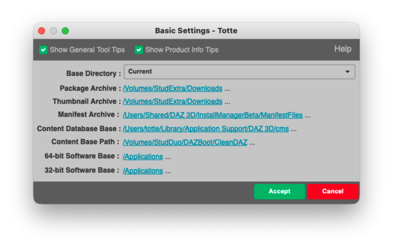

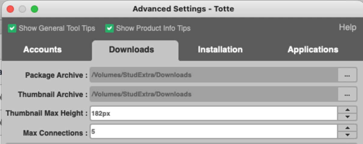

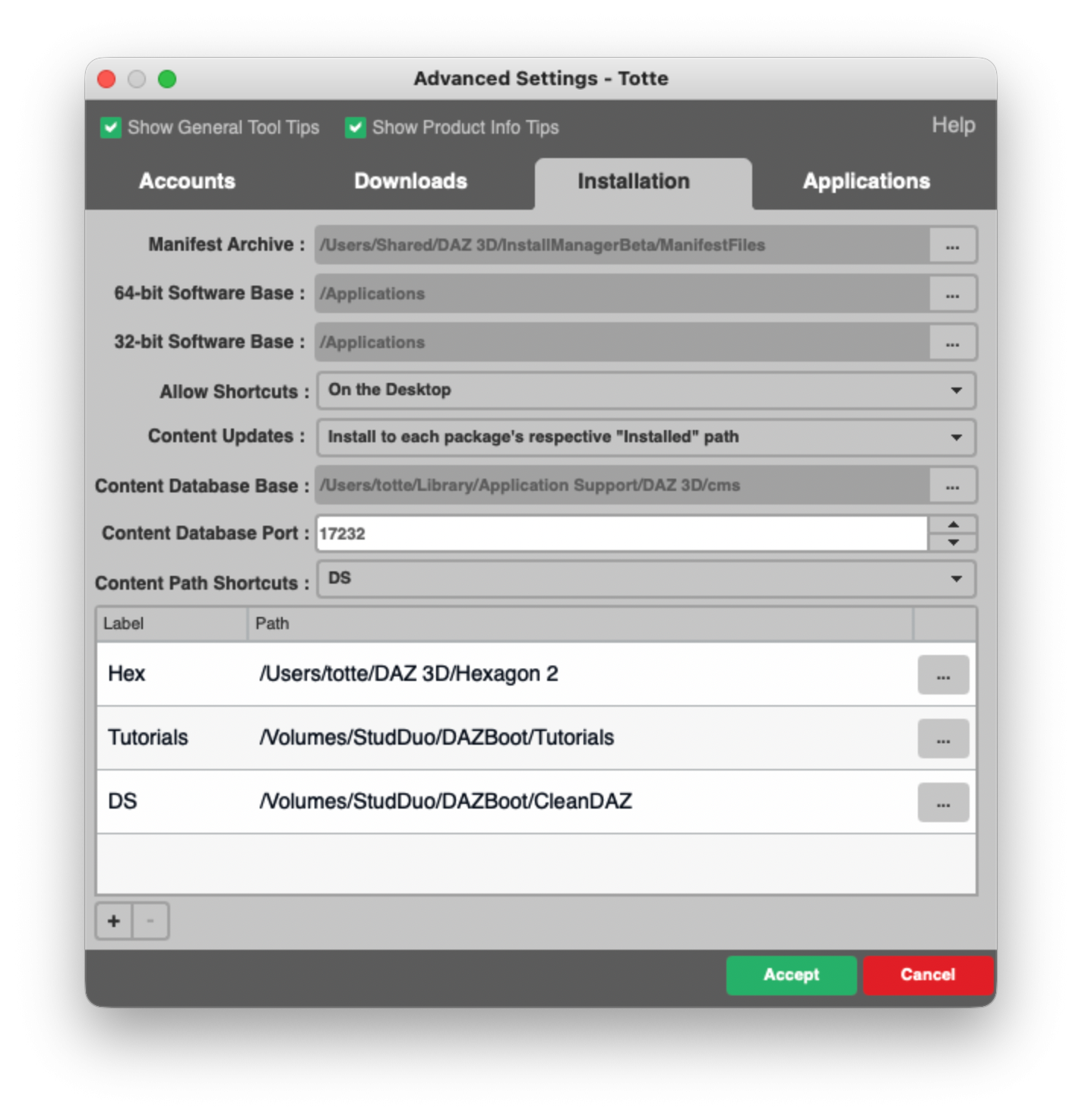

    (d) Then in DIM I have this setup
    Basic:
    Downloads:
    Advanced;

    Important is, that if you copied your content folder from the internal to external drive, you need to do some CMS management and reimport metadata so it sets up the correct paths.
    I hope this helps.I listen to this thread so if you have more questions, I'll try to answer.
