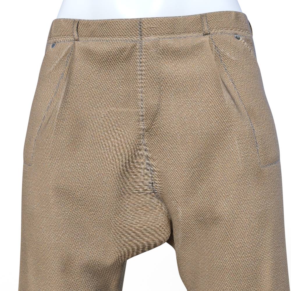

I am having a problem converting the pants from https://www.daz3d.com/dforce-spring-outfit-for-genesis-9 to Genesis 8F. The top and sandals have converted nicely but the pants...
do this.
Has anyone converted these successfully and if so, how? I only bought this outfit today after getting the texture addon with a coupon yesterday so I could return it if necessary.
1000 x 1000 - 2M
Post edited by Lorraine on

  • richardandtracyrichardandtracy Posts: 8,279
    It looks to me that in the automatic weight map allocation, as if part of the inner thigh of the right leg has been weight mapped to the left leg and is moving with the left thigh. This could be due to a bulge in the right leg fabric fabric going past X=0 in the designed 'default' position.
    There are those who know a lot more about this than I, but it should be fixable with the right knowledge.

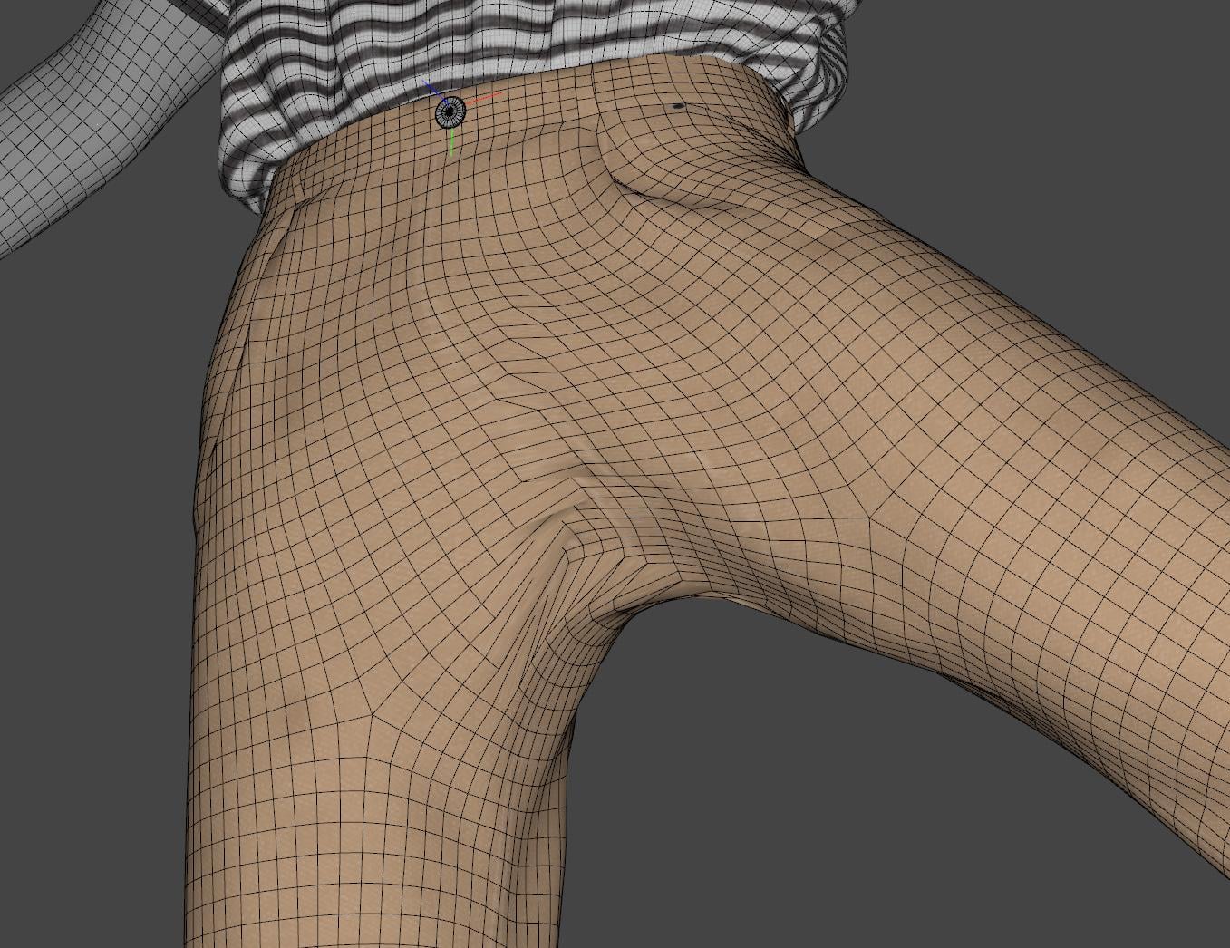

  • Matt_CastleMatt_Castle Posts: 3,309
    felis said:
    But I would suggest to load them onto G9, dial the G8F clone, adjust the legs 6 degrees so they match G8, and export the clothes in base resolution as obj.
    Normally, this is an approach I call "anti-cloning" (as if converting the shape by having the target figure imitiate the source figure is a clone, then I consider converting the shape by having the source figure imitate the target figure to be an anti-clone). It's a really powerful approach that can considerably improve shape conversion accuracy by benefitting from the additional information the conversion gets from using the clothing's weight maps. It's the basic approach I use for fitting clothes to the centaurs.
    However, in this case it won't work properly.
    I'm looking at this on G9, and it's obviously trying to use correctives to fix what are just terrible weight maps, because the shape looks fine in the base pose and at the full CBS pose, but in intermediate poses the shape is *awful*, so an anti-clone would just be working from bad data.
    This is very much a "put in a ticket" product even in its G9 version, and converting it to G8 will require a lot of manual effort.

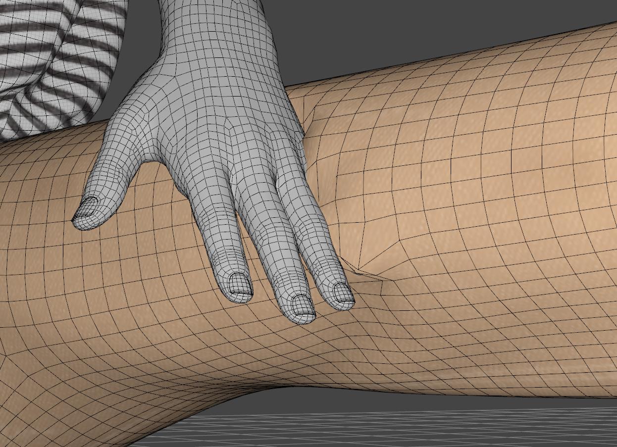

    Ye gods, this is abysmal even on G9.
    I have smoothing off, but the thigh-side CBSs are trying to go over the hand, so the CBSs have clearly been made with smoothing on without doing anything to fix this:
    And as I said before, while other parts of the shape look okay at the starting and finishing poses, the intermediate poses are awful, clearly indicative of CBSs being badly used to fix unsuitable weight maps:
    *I* could fix this stuff fairly quickly, because I have custom tools for this kind of thing. It would take most experienced users several hours to get this usable.

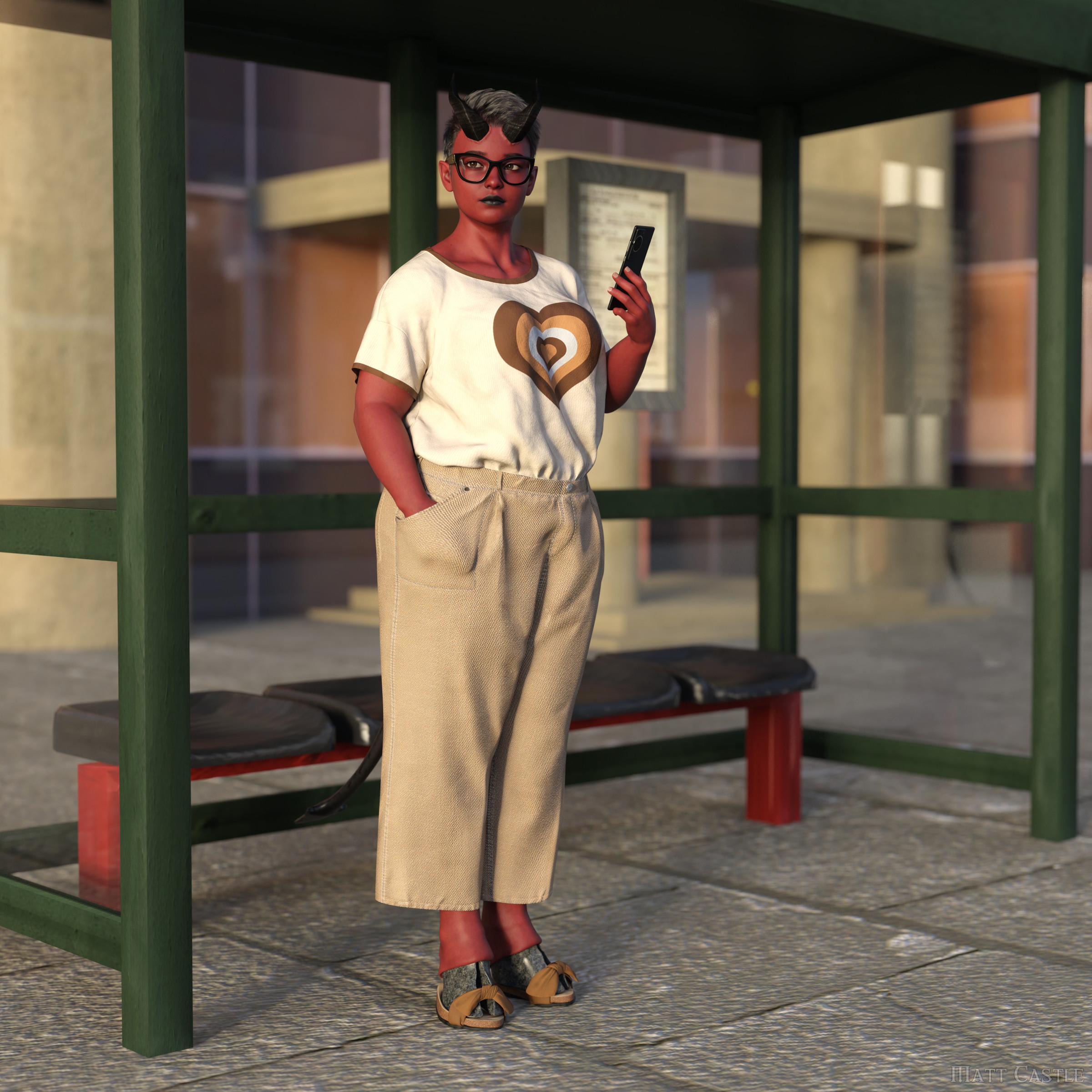

    Well, I was able to repair it for G9.
    This would make getting it on G8 a bit easier, as you could indeed transfer the shape better by doing the shape conversion on G9, although it is unfortunately still going to be loose clothing, so weights and JCMs won't auto-transfer well, and you'd either still need to do them manually or rely entirely on dForce.
