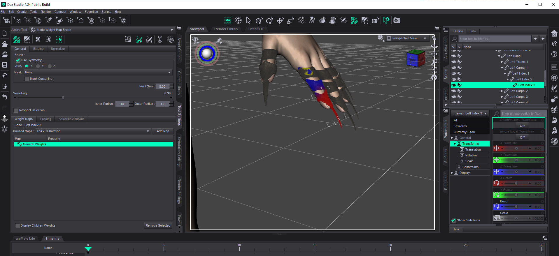

Thank you felis. Clean up the weightmaps? I don't have any idea how to do that.
Select the claws in the scene tab and expand it till you get to the hands and fingers
Select the weightpaint tool. Open Tool Setting and select symmetry (will do both hands at once) and click one of the outer finger bones.
The claw should now turn red-blue-grey. All of the claw that extends from the outer fingerbone shall belong to the outer fingerbone, i.e fully red, so if it isn't you must paint it fully red.
I don't have these claws, but I found some other to show the principle.
