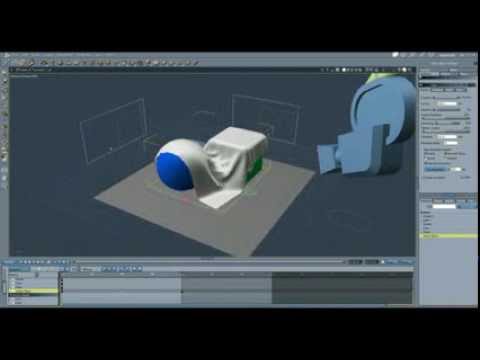

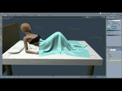

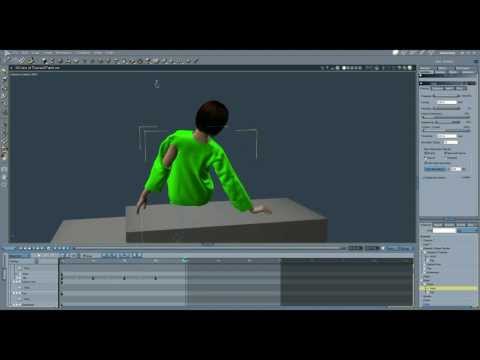

    If you haven't checked it out yet, Sparrowhawke's Cloth Deformer Plugin is also offered as Beta, but is also showing some promise ;)
    Jeremy's Cloth Deformer YouTube Video Tutorials
    Tutorial One (click to watch)
    Tutorial Two (click to watch)
    Tutorial Three (click to watch)
    Wonderful Free plugins for Carrara!
