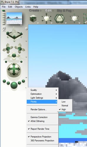

  • Rashad CarterRashad Carter Posts: 1,830
    You need to set the priority to high. The default priority only uses half your cores which is why you are not seeing a speed increase compared to the older system. Look here to adjust the Priority. Best of luck.

  • bumpmap143bumpmap143 Posts: 2
    Thanks for the fast reply, Rashad. I tried resetting as you said and I actually got a slower test render.......(1st-Normal Rriority =31 seconds, 2nd- High Priority= 46 seconds.).......(I used a tiny format) Could there be a "check box" somewhere that I haven't found that allows the program to access more cores? I'm stumped.
    As I said before, thanks for the fast reply.
